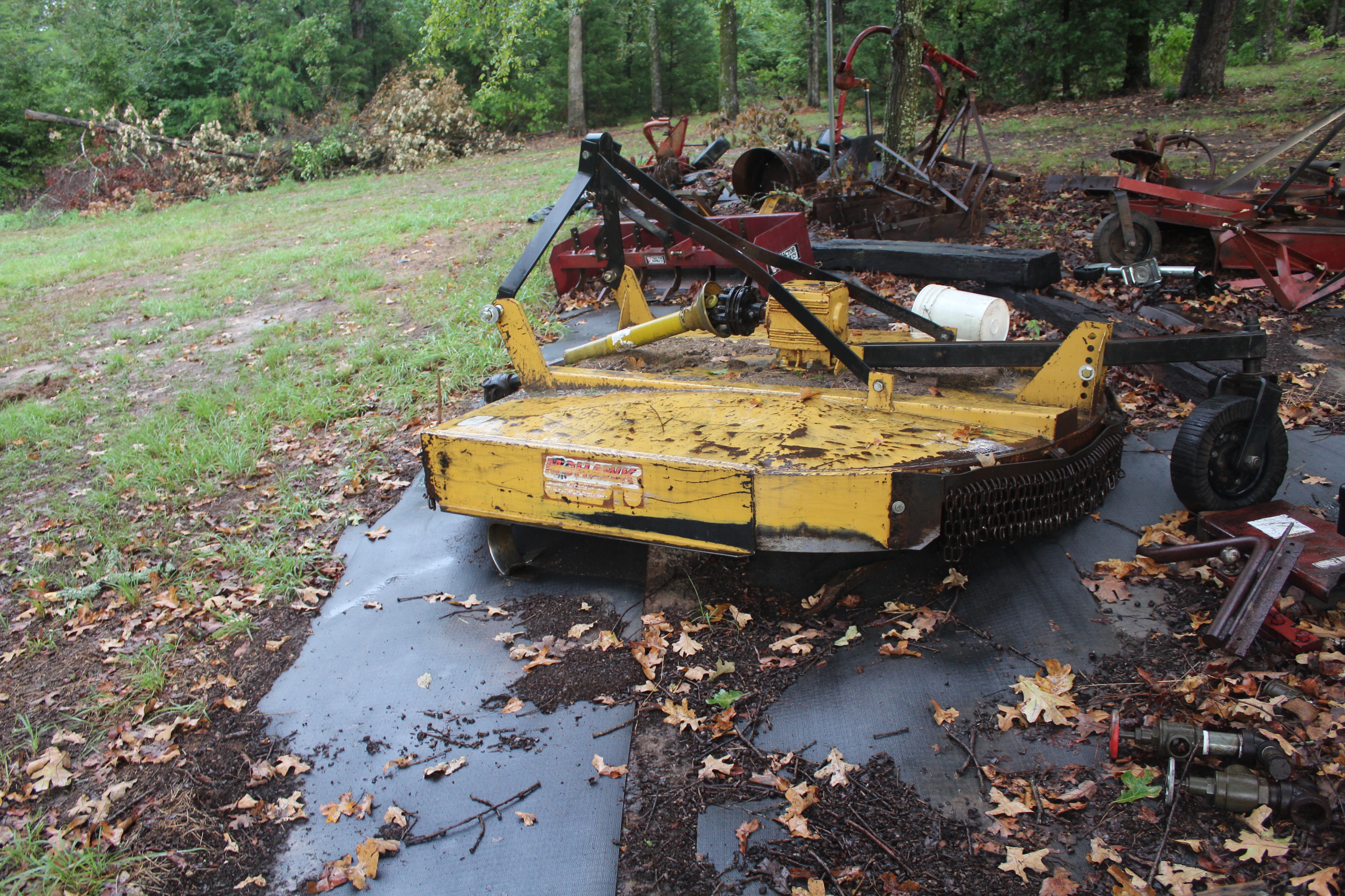

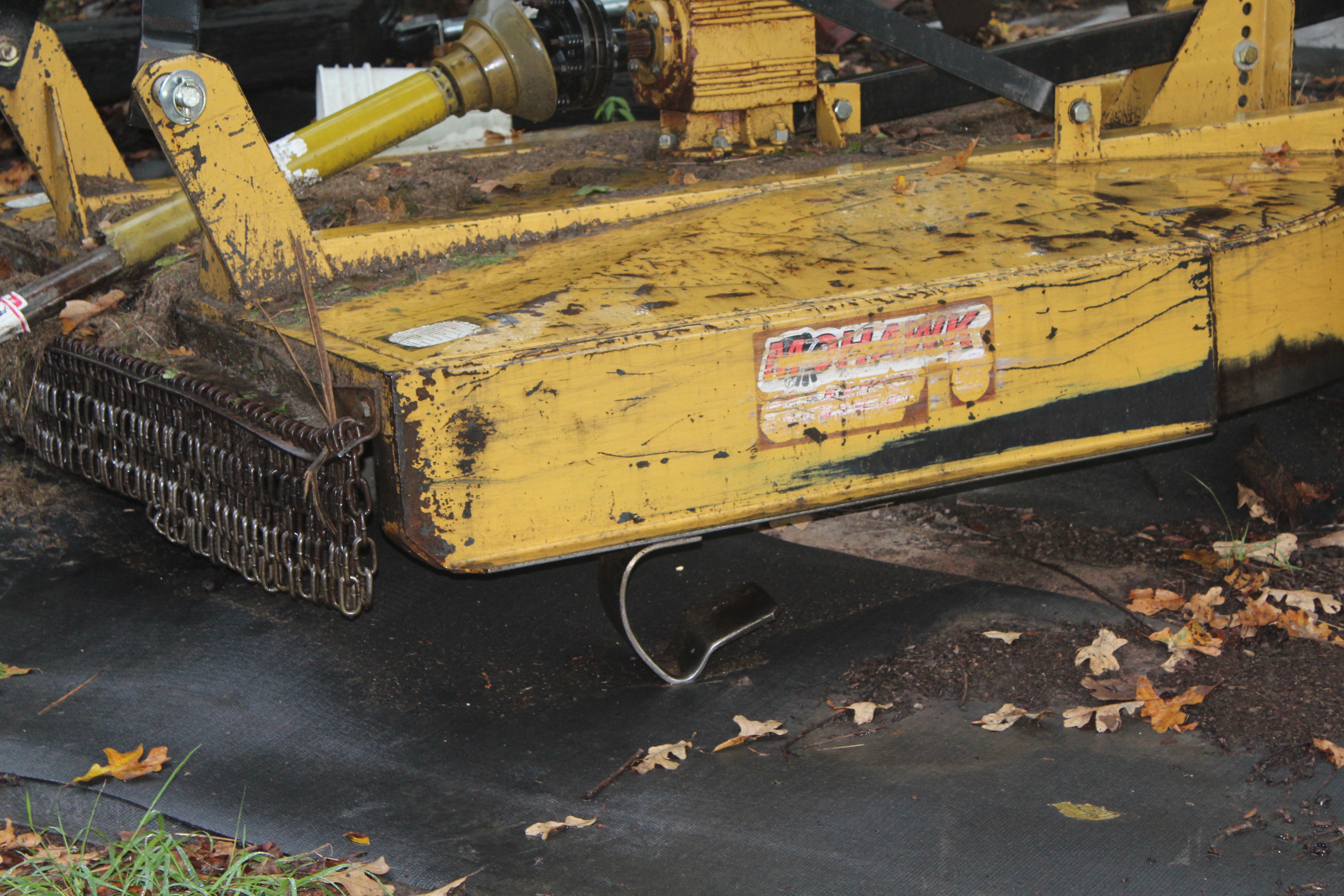

I was shredding between trees. Done it many times. Came back around and it did not look like it has cut right. I looked back at the shredder and it was sitting funny, so I checked a little better and a hitch pin had disappeared. I got the shredder lined back up and put a new hitch pin on. It was late so I parked the tractor.
The next day I decided to take the shredder off and when I did, the shredder looked funny again. "So that's why it looks funny" Now, How did I do that?

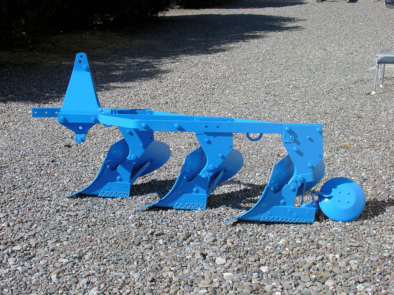

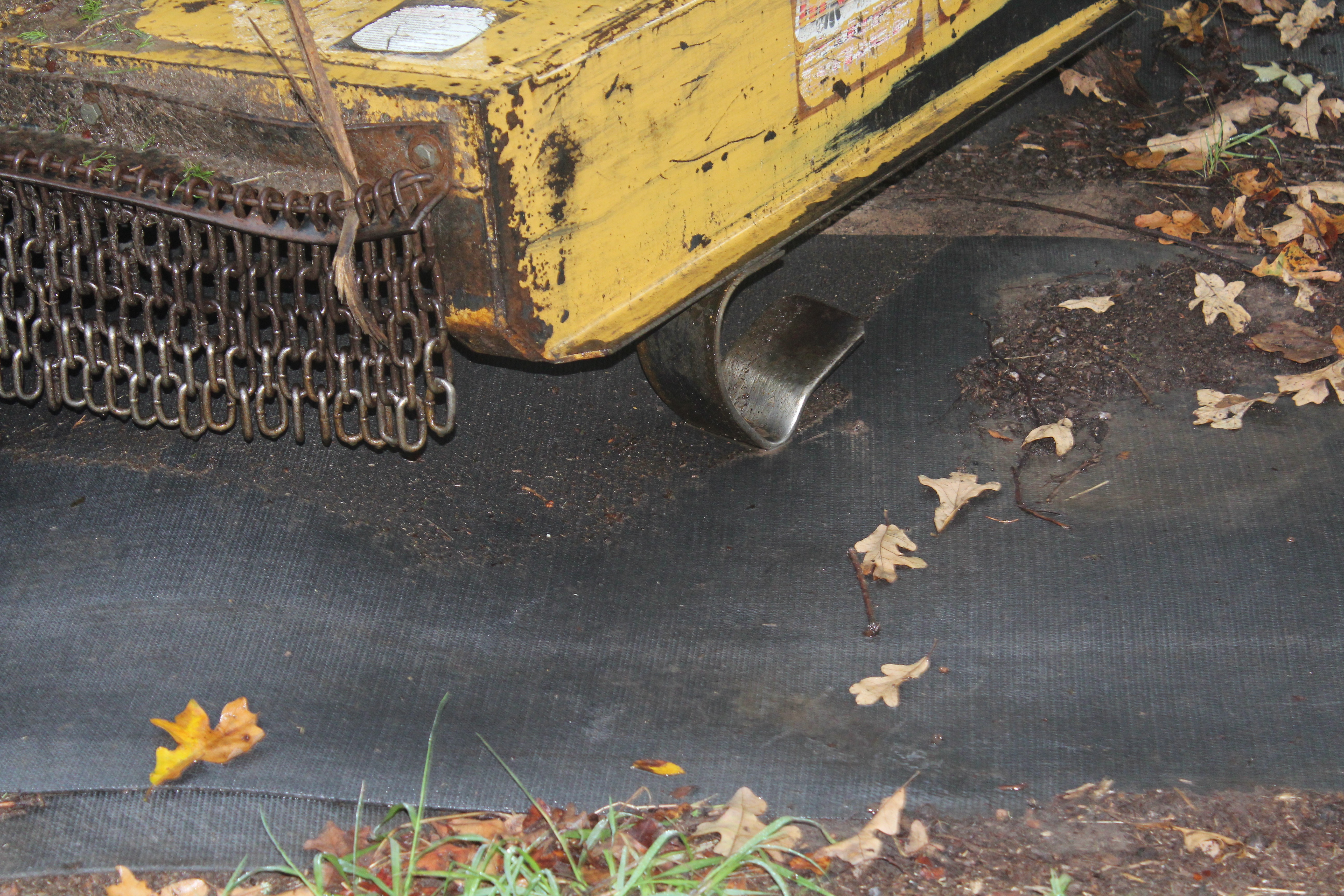

After the skidder gets straightened (or replaced) and welded back on, you may consider hardfacing the ground contact area. The skidder gets thin from wear and is displaced much easier.
Hardfacing in a crosshatch (#) pattern has reduced the wear in several of my implements. Tillers especially have the same problem and the wear bar (landslide) on a plow are the most notable.

Straighten it out and tack it back. From the shininess on both sides, I would say you had it set too low and was constantly dragging when you started. Raise it up with a little air between it and the ground.

Doesn't look like anything you can't fix with a log chain and a large tree. Then flip it over and beat the he11 out of it with a sledge hammer. Finally tack it to the frame with a welder. Good as new.
