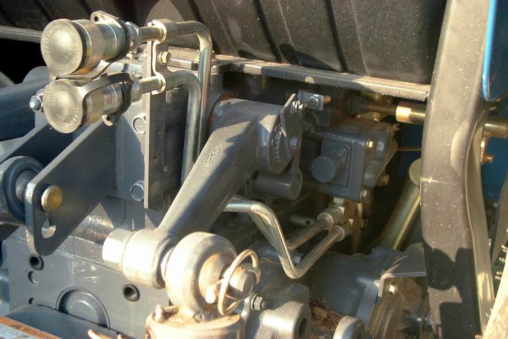

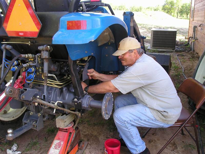

Don't try to hook into anything. Buy the kit from NH (about $550) and install it yourself. Here are a couple of photos of the first remote and me adding the other two remote kits to my tractor. You get the valve, the lever, the piping, and the quick connects all ready to bolt on in the kit. It's simple and elegant.

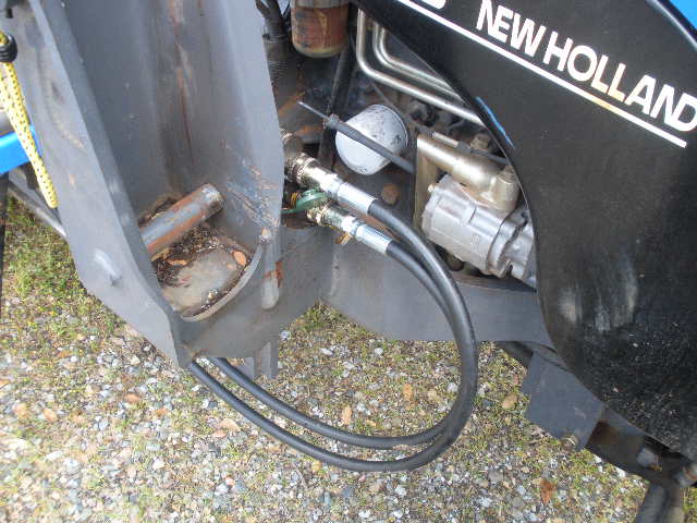

Do it the easiest way possible if all you want is to run the splitter. Get some long hoses and a couple of male quick connects that fit your loader QCs. Just make sure you get the right fittings. They are not 1/2" like the rear remotes. Next, disconnect the FEL arm raise/lower QCs and hook up your log splitter. Push the joystick forward to float and it will stay in the detent, providing a continuous flow to your splitter so you can use the splitter's valve to control the splitting ram. It will work just fine that way. If you want to be sure the joystick doesn't jump out of float, use a bungee to hold it forward. Of course, if your splitter works backwards, just swap your hoses at the QCs. PIECE OF CAKE!

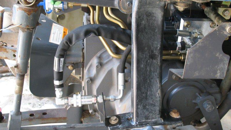

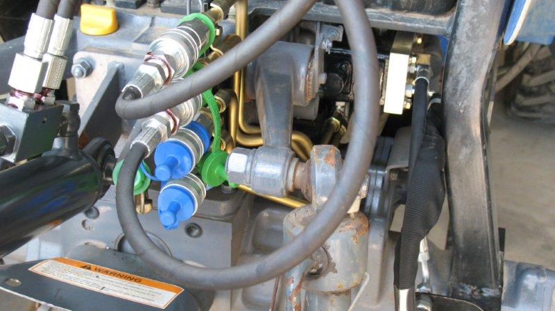

Woods makes a "Hose Kit" for backhoe plumbing or an attachment like a log splitter. It replaces the end block at the tank port on the rear axle (same area where rear remote valves go). The part number is1021867 for your TC40D. Only problem is it costs about $300. It is a very clean setup though with easy access. Hoses remain connected when the accessory is not used, when using the implement unplug QDs and plug in the spitter.

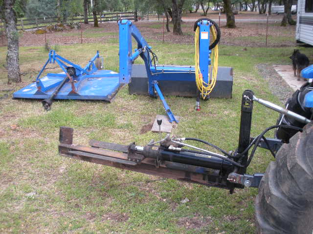

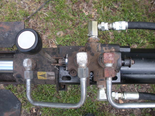

I have the splitter hooked up, as Jinman described. The hoses are going to the loader QA's. I was able to split a few pieces of wood, before putting stuff away so I can get to fire station training in a few minutes...
I was getting fluid out the back of the valve(at the arrow). Not sure about that...

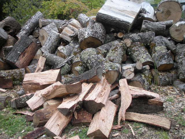

Some split wood. They started out about 18" across, recently cut oak.
