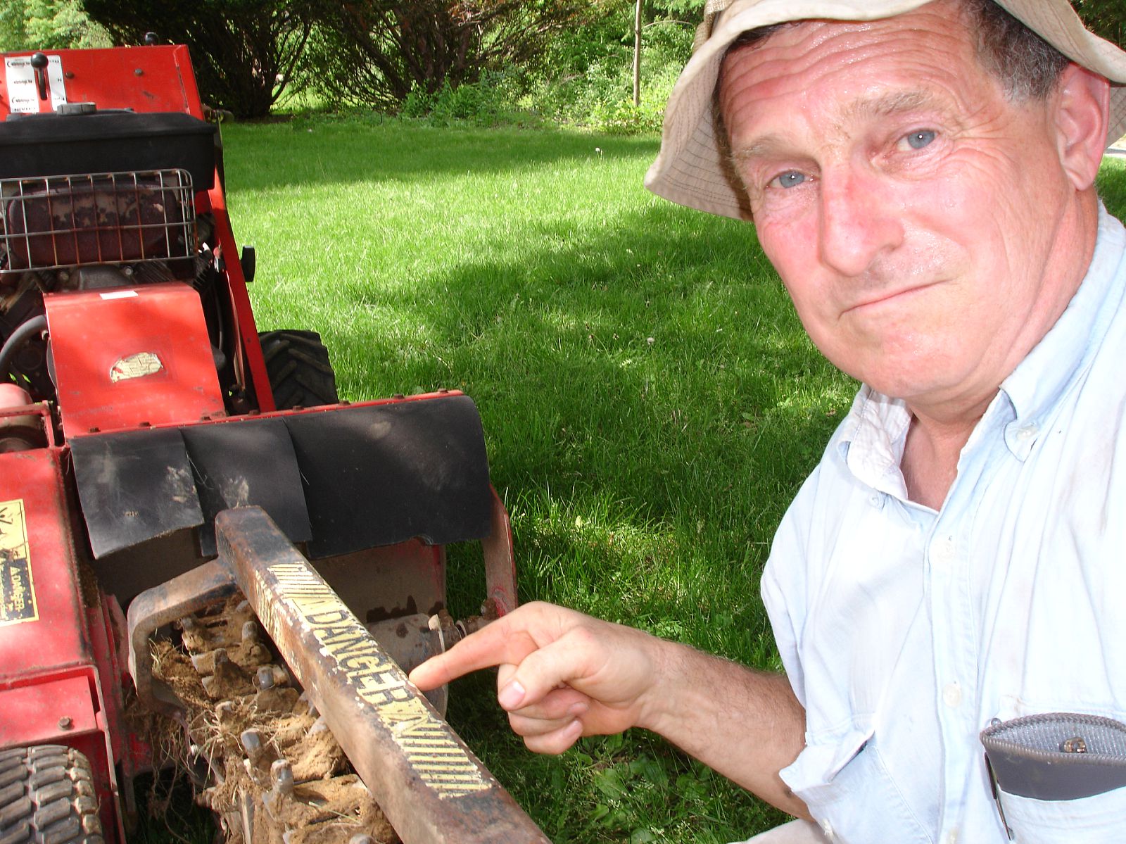

Wrong tool for the job. Rent a ditcher either self powered or 3ph. If your time and back are worth anything to you, it makes lots of sense to do the job right, quickly, and with the least effort.

In general, eray1066 has the answer - to rent a trencher.
However, if you must use the plow then get rid of the coultler and take off the rear wheel.
It looks like you want to sink the plow to the frame but the amount the 3PH will lower will be the real limiting factor.
My guess is that undisturbed clay plowed 18" deep will grind the tractor to a halt. Maybe several passes would work but in the end a lot of the expelled dirt/clay will fall back in the trench and require much shovel work.
Back to the trencher, it will do the job in no time and the results will be perfect for what you are doing.

Second the wrong tool for this project.
