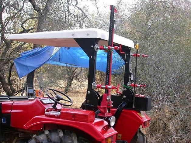

   / How do i check tire pressure on a loaded rear tire #7
</font><font color="blue" class="small">( I'm too lazy to run the jack over. I usually start the tractor up if a stem isn't at the top and drive until it gets there. May have to do this for each tire, as they're almost never the same. Usually only have to move it a tiny bit.)</font>
That's exactly what I do Ralph...
But in case I do need the jack, I just bring it with me everywhere. (Too lazy to even go get it) Ha! Here's a pic.
