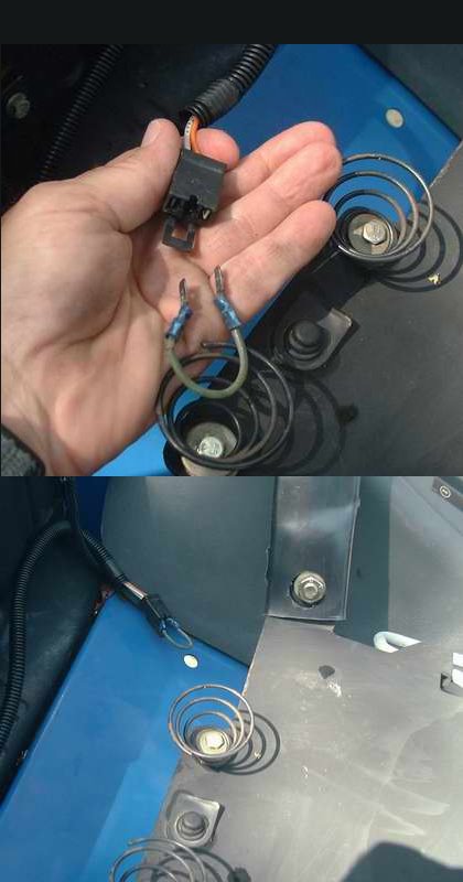

It is near 10 degrees and my TC35D won't start, I want to disconnect the seat switch to disable the safety system to see if that lets the motor start. Right now it just spins over fast but never fires. I can not see under the back of the seat where the switch is. I can see 3 wires going in ( one orange and 2 white) I can feel the switch but can not feel that the wires are held in place by a disconnect. If anyone has unplugged theirs I would appreciate knowing what is there. It is very cold out there and I would rather not remove the whole seat to get at the switch if there is a way to just unplug the wires but it does not feel like a disconnect. Once I get it out do I jump all 3 wires together or do I leave them open and not connected? Thanks for reading my dumb questions but I will thank you for any help. Thanx Frank

Frank, I'm attaching photos to help you in disconnecting your seat switch if you wish to do that. You only need to jumper two contacts to bypass that switch as shown in these photos.
As Kozak noted, your engine will not turn over with the starter if the seat switch is malfunctioning. Perhaps your engine is too cold or the glowplugs are not working properly. It could also be that the cold weather has your fuel shutoff solenoid "frozen" so it will not allow fuel to your engine. There are only three things listed in the Repair Manual for "starter motor energizes, but fails to start engine." Those are: 1. defective operator safety module, 2. defective fuel shutoff relay, 3. malfunctioning fuel shutoff solenoid. Good luck. I don't envy you working in such cold conditions. That is definitely not fun. /forums/images/graemlins/frown.gif

If it was any of the safety switches.. it wouldn't crank over. As others have said.. check the fuel.. I'd do a quick check w/ the bleeder valve first.. okay.. maybe check that the fuel line switch is on.
