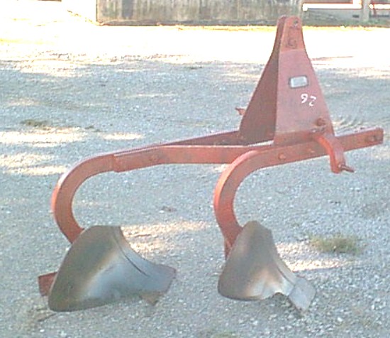

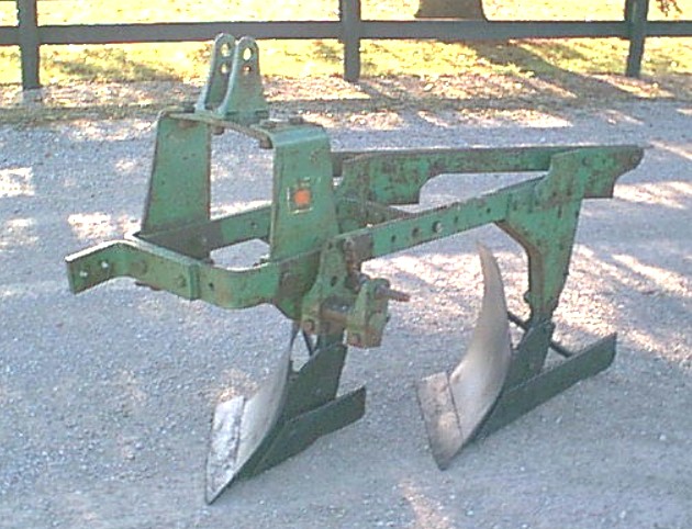

The plow that was sold with that tractor usually was a 2-12 Dearborn and then later a Ford 2-12 (both with solid beam). To get trip beams you will need to go newer to the Ford 101 series or Oliver 2-12 plows also pull easy. I am showing a 2-12 Dearborn with solid beams and a 2-12 Oliver with trip beams. Ken Sweet
