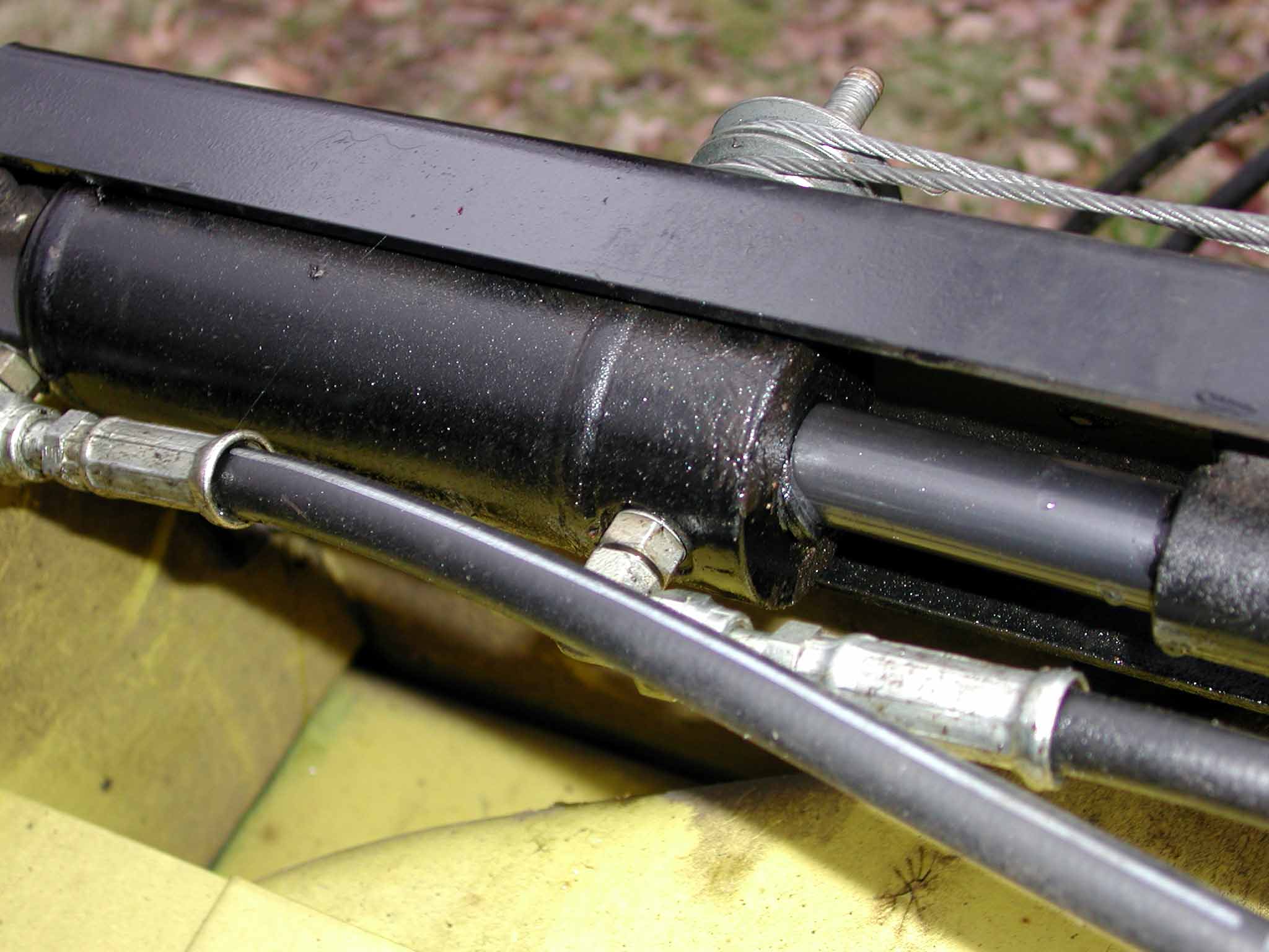

I saw the seal leaking the last use of the year. Anyone know how to replace the seal?
Chute rotator cylinder. 59" snowblower.

Do you have the parts breakdown schematic?
A pic would be great.
   / How do I fix Seal leak SB59" chute cylinder. #3
I just looked in JDParts, found the cylinder but no parts breakdown for it. Can you post a picture of it? Particularly the end where the rod exits.

The seal is coming out.
I can't see any way to take either end off.

Oh man...that cylinder is welded shut. I hate when they use them:mad:
You can try a local shop and see if they will tackle it...or source a replacement cylinder that can be rebuilt. As little stress that is on those cylinders-they should last forever! I assume your out of warranty?
   / How do I fix Seal leak SB59" chute cylinder. #7
if you need a replacement....i would try surpluscenter.com to see if you can find a match. i'm sure a deere replacement won't be cheap.
