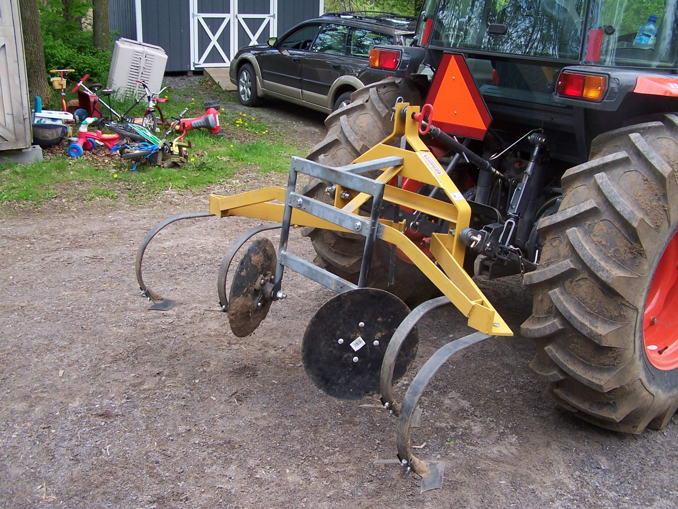

I have a Ford 8N. I would like to plant some row crops this spring. Corn, beans and other items like potatoes.
I have planted in the past and hand cultivated. However, this year I would like to plant more. So, my question becomes, what is the appropriate spacing so that I can run my tractor through?
In between the rear tires measures 40 inches. I plan on buying a three-point cultivator. I would assume those are adjustable. is there any way that I can get to rows in each pass of the tractor?
How do I plan out the spacing?
   / How do I plan out row spacing for crops? #2
Space for the track of your rear wheels,40" is your spacing I have a three point cultivator;I remove the center two and use the ones on the outside.Works well.I also built a hiller attachment for mine , works and is removable.I have reversed the hiller disc since this photo.It is fine until the plants get too tall.I also added peanut shares ,they move a lot more dirt than the standard culivators.

You must first set your tractor up to the generalities of your location. I'll bet most every crop around you, especially corn and soybeans is grown 30" between rows. So, you set your tractor wheels so they center at a 60" tread width, meaning center to center. The inside of the front tire lines up with the inside of the rear tire. this will give you the greatest clearance at that row spacing of 30". As well, most of the implements you'll find for sale are probably set up on a 30" row center so life is easier when you buy implements..
Right now your tractor is set up at 51' based on your 40" between tires and likely 11.2" wide rears. You need to move the wheels out according to the owner's manual to get the spacing you want and I would strongly suggest 60" in farm country. When you do two rows, you just straddle them and will have 9.5" on either side of the tire. I did the math in my head so double check but I could do this in my sleep.
After that, it's relatively easy. Plant corn and beans at the same seed spacing as your neighbors and either do a soil test or fertilize at their suggestion until you can do a test. Spray a post-emergent like Roundup over the ground to kill any vegetation and plant your corn deep enough to allow spraying a pre-emergent over them to keep weed growth down.
For beans you could plant Roundup Ready seed and have a beautiful and admirable stand of soybeans. If ideology or personal preference doesn't allow those sprays you can do a pretty good job the first year with cultivators. Each successive year will prove more difficult with weeds so you're back to the hoe thing. Remember, weed seeds like giant ragweed can live dormant for 90 years. Don't let weeds go to seed...ever.
Potatoes are more difficult because it's harder to get two rows under the tractor. It's best to just run one long row on the outside and then space your next row of whatever crop maybe 40" over. That will give you enough room to get cultivators and hillers through the two different crops.
