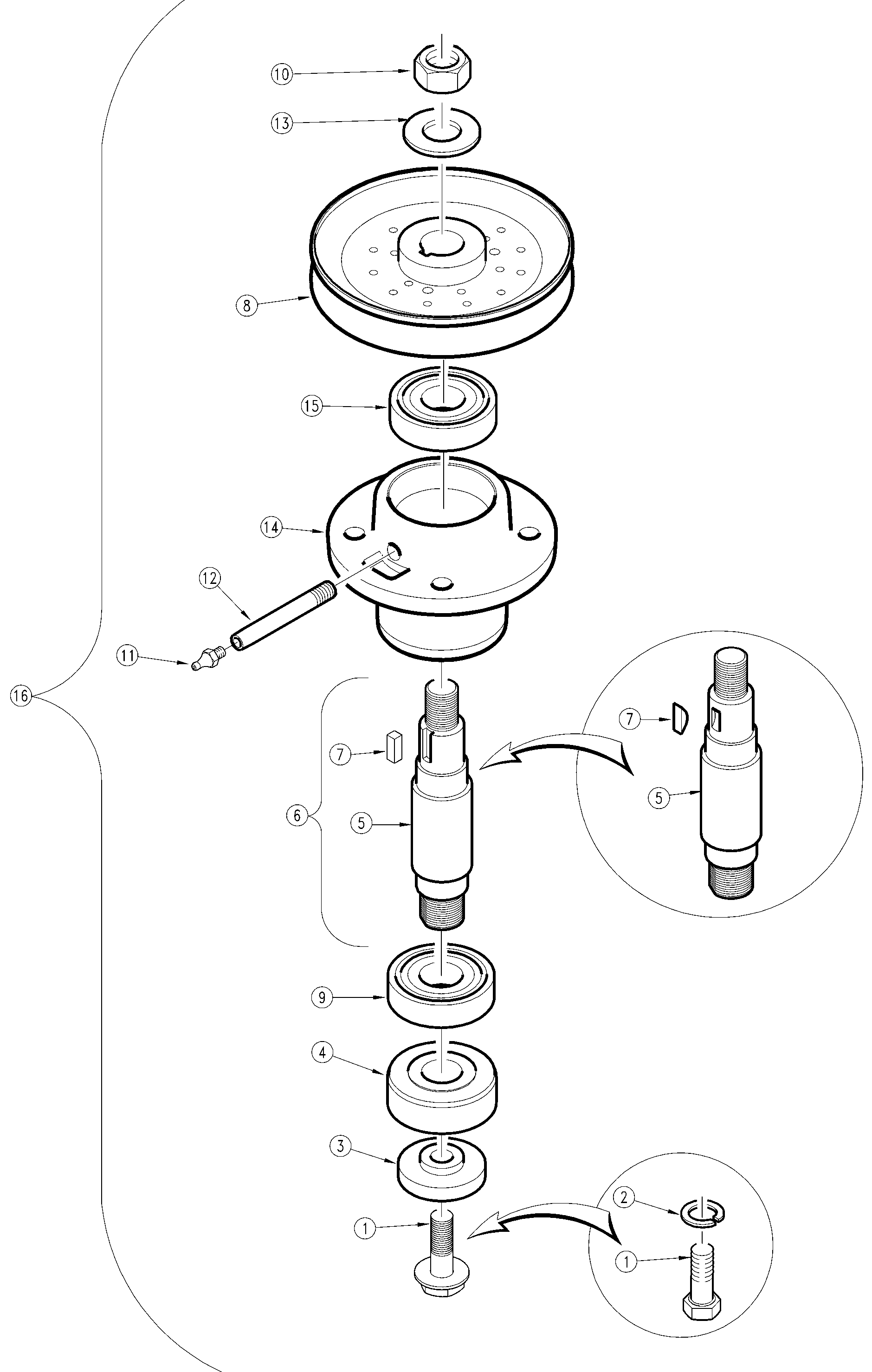

Hi All,
took nut off above pulley, used 5-ton pulley remover, but just bending pulley. Any ideas as to why pulley is not coming off? Worked all day on this, have bent pulley, no joy yet. any advise would be appreciated
   / how do I remove pulley from landpride FD2560 grooming mower? #2
Whenever I can't get anything off I break out the old trusty torch and heat it up good.
I can do that but will it screw up my bearings? find attached diagram. I am replacing the hub that has threads stripped out, that holds blade bolt on. landpride spindle from FD2560 mower.PNG heck all am I trying to do is replace part # 4. This is where the mower blade bolt threads into that is stripped out. Maybe I should not have tried to remove pulley. 4 bolts hold the entire assembly located under pulley. hard to reach with pulley attached/
   / how do I remove pulley from landpride FD2560 grooming mower? #4
Can you put a couple of shims between the pulley and hub and drive the shaft out or better yet use a shop press?
Thanks huskerhayman for the advice. I got the pully off by heating it. Unfortunately I ruined it. Not really set up to work on heavy equiptment. Lesson learned; I need a BIG vice to hold spindle while trying to remove hub. And a shop press. Change of subject. Drought here in Missouri all summer. hay prices are ridiculous. How was the crop up north (Iowa right?)
