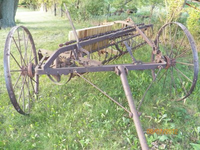

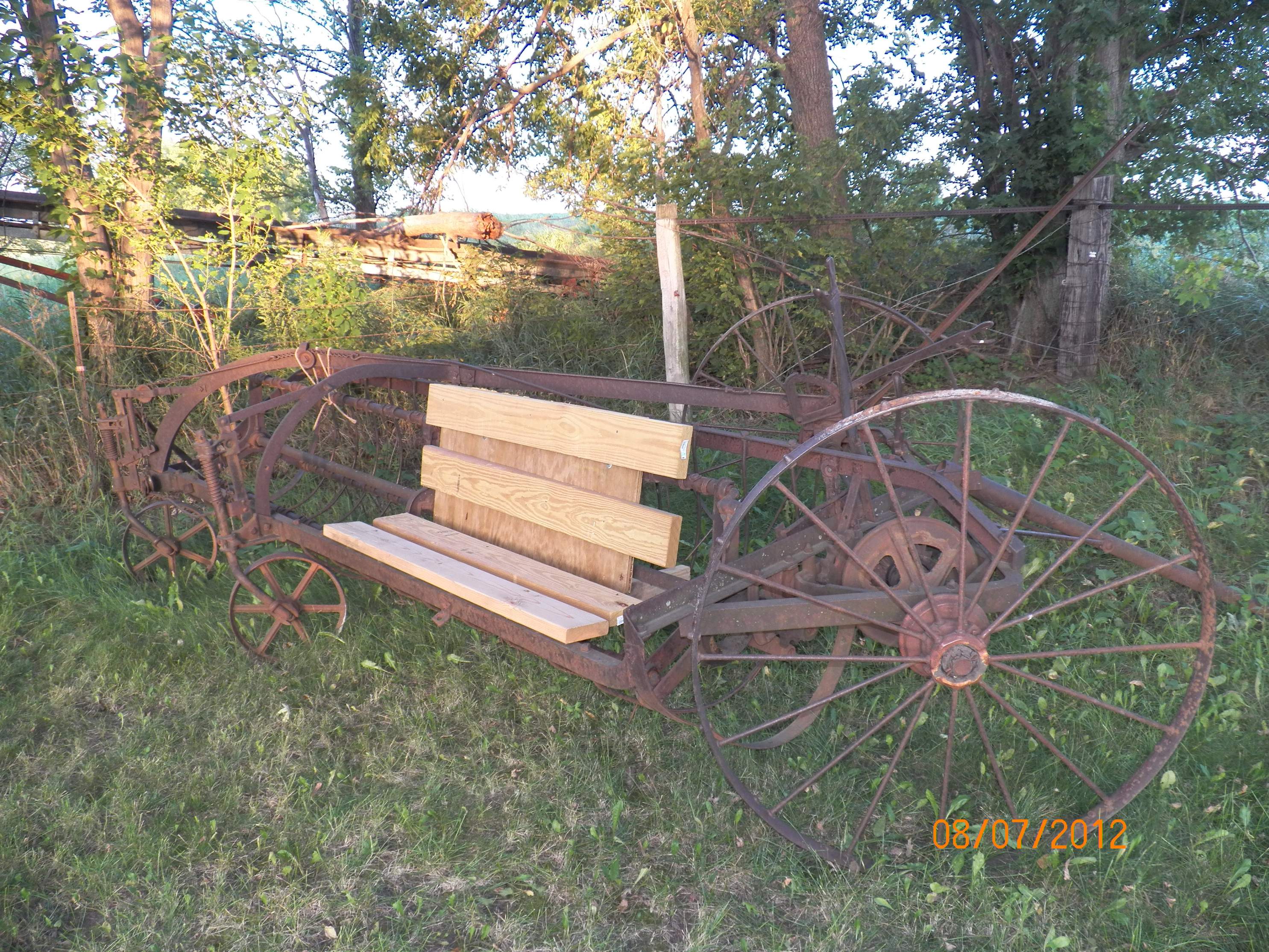

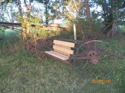

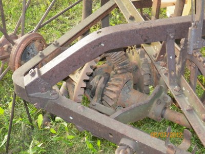

Well, I long ago gave up using this thing to rake the lawn. Thought it was a good idea at the time but it's just too worn out. Now it is a creative garden bench.
Woud still like to identify it and hopefully find a photo to help paint it original colors. found some red paint on the gears if that helps. Any remaining paint on the wheels is inconclusively either red or yellow, not sure.
thanks

Take a look on the hubs for any Identification casting marks or on the gears.
   / How do I repair the drive chain on an old sully rake
What am I looking for? There are stampings here and there on the gears and wheels that don't mean anything to me.
