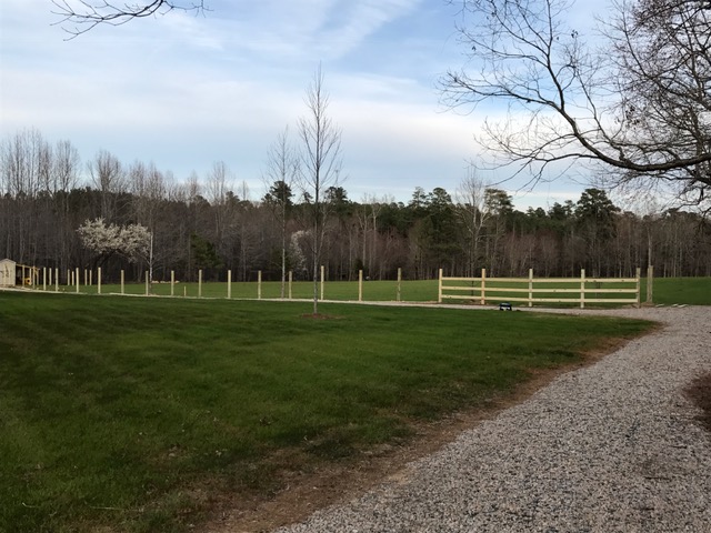

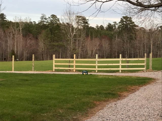

250' of fence, fairly level ground. 16' boards with 8' on center posts.
When I'm setting the boards, do I set them level with a point on the top of the fence, or do I set them a set distance up from the ground? What I'm worried about is in the picture my first 2 16' runs are set the same distance up from the ground, the fence will end up looking wavy. Do I just pick a point maybe halfway down and let the ground undulate underneath?

I would measure off the ground every 5th post or so and set them to a string line. (40' adjustments). That and just using your eye. Your fence, your rules.:thumbsup:

You do it the same way you'd do a welded pipe fence. Set all your posts first. Then run a string for the top rail. Step back and adjust your string to give you an aesthetically pleasing look to your top rail. You want it to follow the general contours of the land, but not every dip and bump or it looks too erratic. Once you have the string set, put in your top rail to match the string. Then use a spacer to set each lower rail the set spacing down from the top rail (repeat with each lower rail spacing).
To elaborate on your concerns. The problem is when someone uses a storyboard to set the rail heights at each post. The result is an erratic and amateurish looking fence.

Once you get the first rail up you can then go back and adjust them once again as needed. Just one screw in the top rail at each end to get them up where you can look works nice, then attach them how you prefer. Then do the lower ones.

I'd go straight and adjust at every half dozen or so posts.

A nearby place has a fence that follows land contours - make me dizzy just seeing it! Do like old Rusty said. Basically, make the top even.
