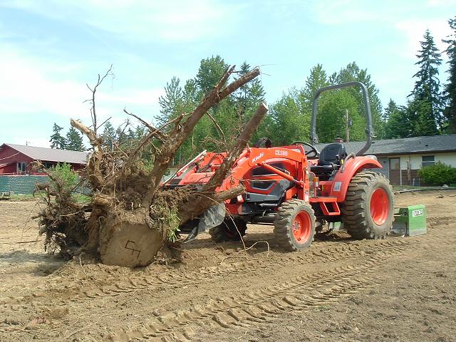

Nothing is harder on your tractor than pulling stumps. Resist the temptation to get a run at it and/or jerk the stump out. Proper stumping equipment includes a backhoe.
I take a different approach and just leave the stump alone until I build up enough stumps to justify hiring or renting another piece of equipment to pop stumps.
I attached a photo of one stump that I spent a long long time removing. In this case I graded several feet of material away from around it as part of the project so the stump was extracted without undue abuse.

If a tractor w/FEL is your only option it can work on reasonable stumps, but I would use a big dose of discretion/care. First thing one will want to do is leave the stump high during the tree removal process, 4' or higher if possible, for leaverage(trick learned from working w/dozers). Get a quality chain 3/8th or larger. Then dig a little, push a little and pull a little till you get 'er loose. Take it slow and easy so you don't break something, including yourself.
As said by others, a CUT is not the preferred tool for production stump removal but I've(and many others) have done it successfully. Sure beats the shovel and mattock technique. Small pines, spruces, soft maples and such, no problem, oak, beech, hard maple put up a better fight though...... Soil type would have a HUGE influence on my decision too. Clay & rock = excavator hire for me, whereas sandy or loose soil types I'd give it a shot.
