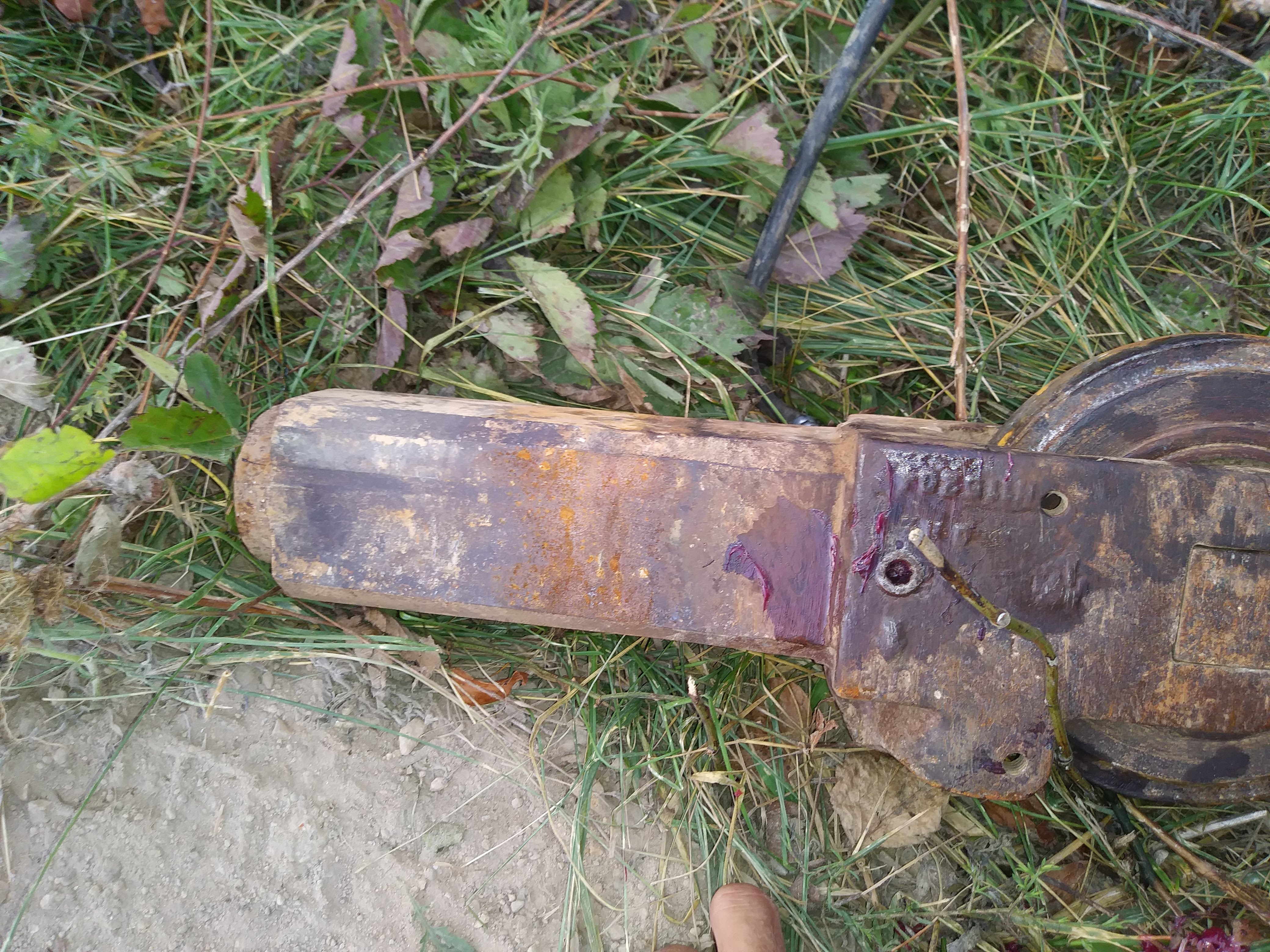

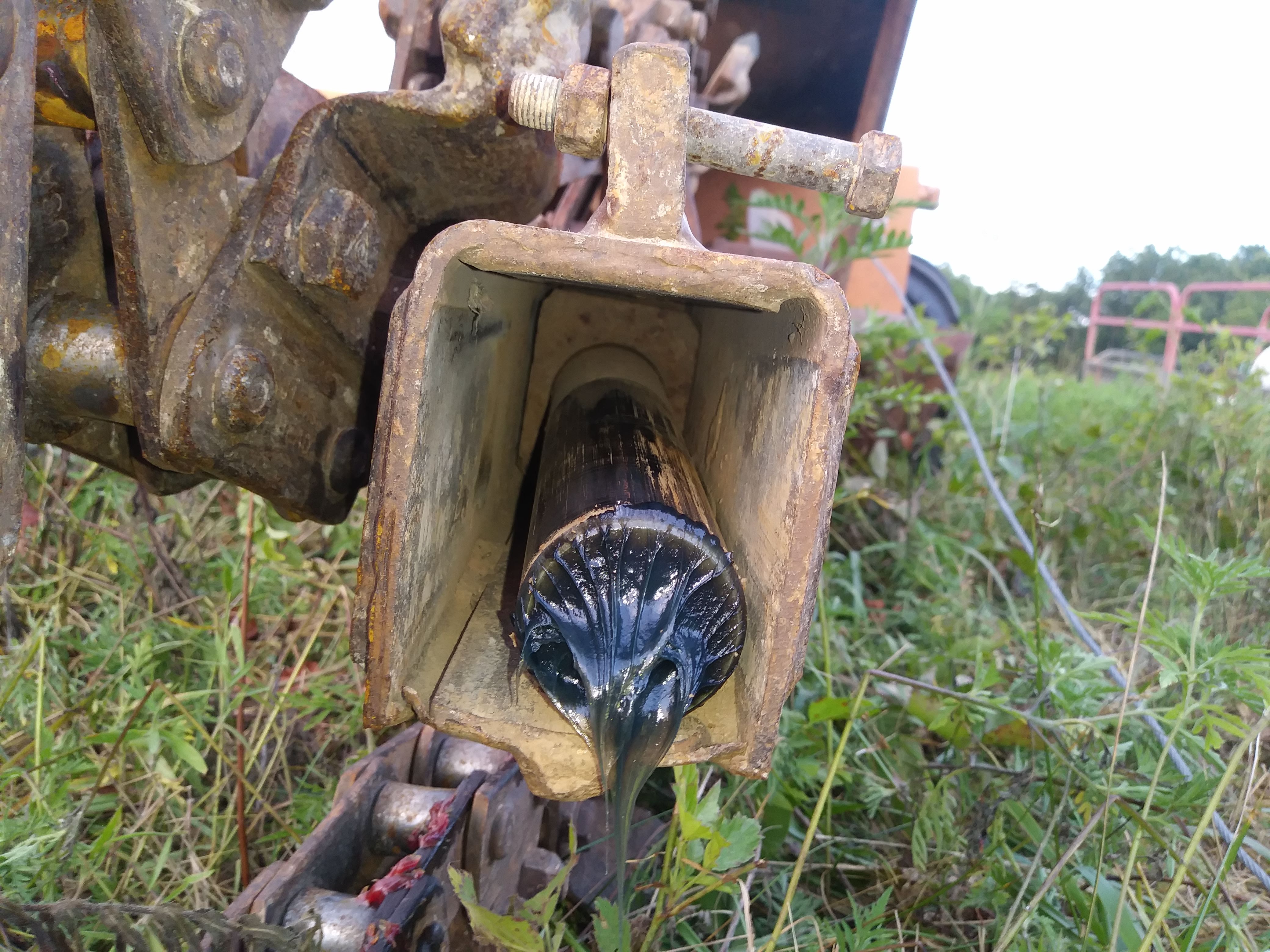

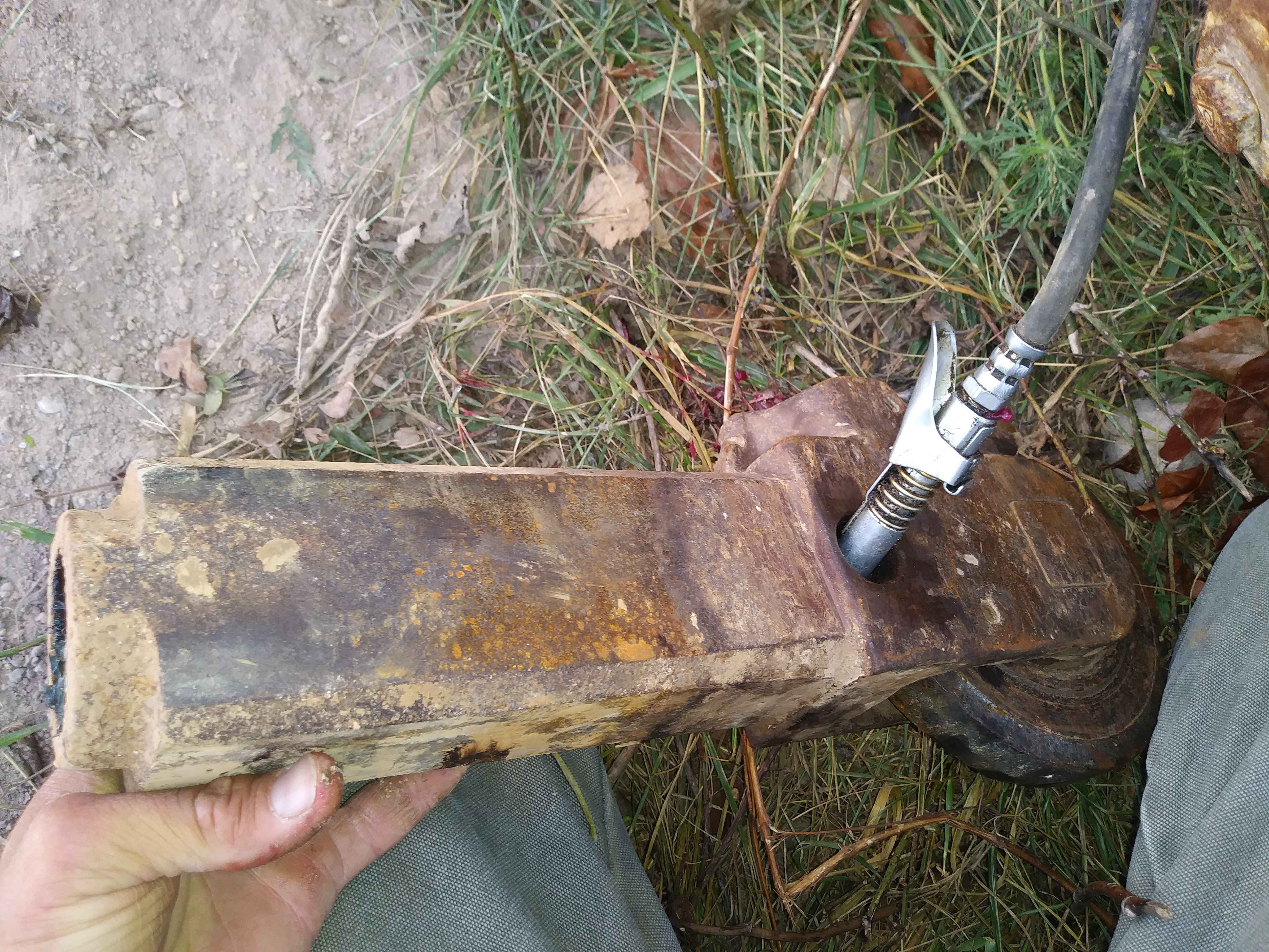

I got a chance to look at this again tonight. Decided to just fill it with grease until I reached the end of the cylinder, hoping it would just come apart. Sure enough, it popped right out. No spring, no retainer. I cleaned it all up and don't currently see what was preventing it from moving in. The old grease didn't seem that thick and nasty.
In case anyone else deals with this in the future, it is a very simple setup. Pictures below. The cast part with the idler that slides into the "bar" tube really is the cylinder. It contains the grease fitting on one side, connected across to the other side where there is a bleeder screw (5/16 Allen). Both of those connect to a channel in the middle that feeds into the cylinder part.
