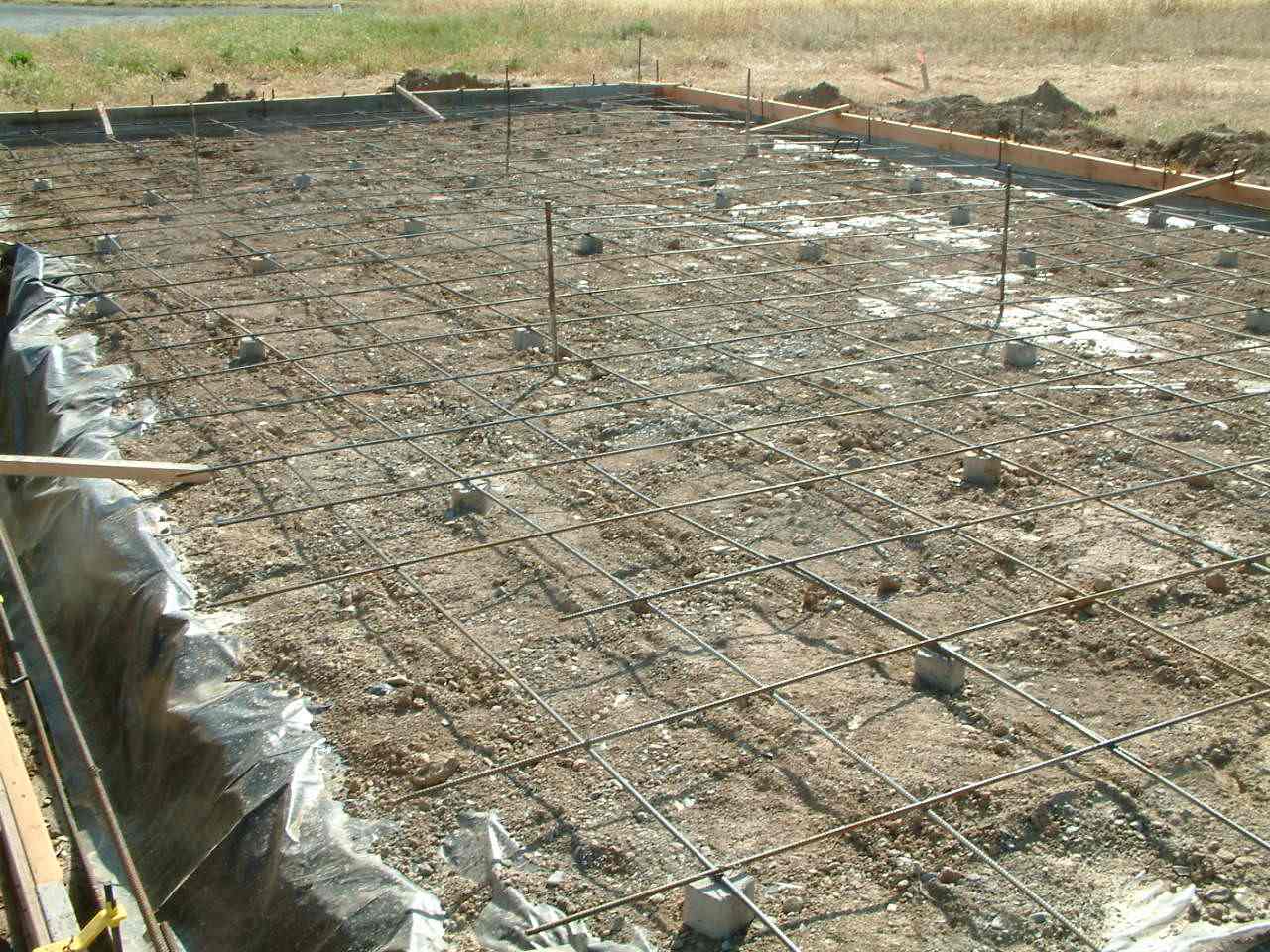

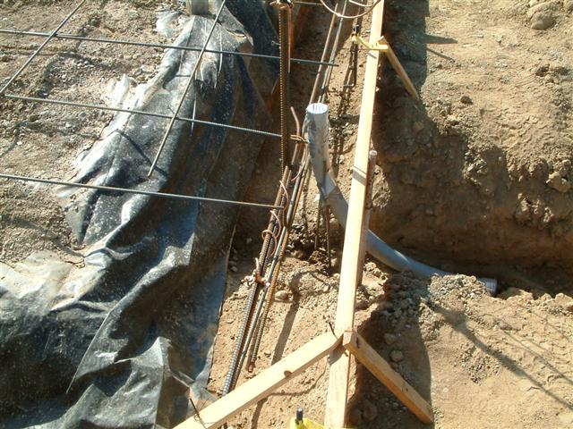

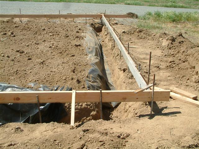

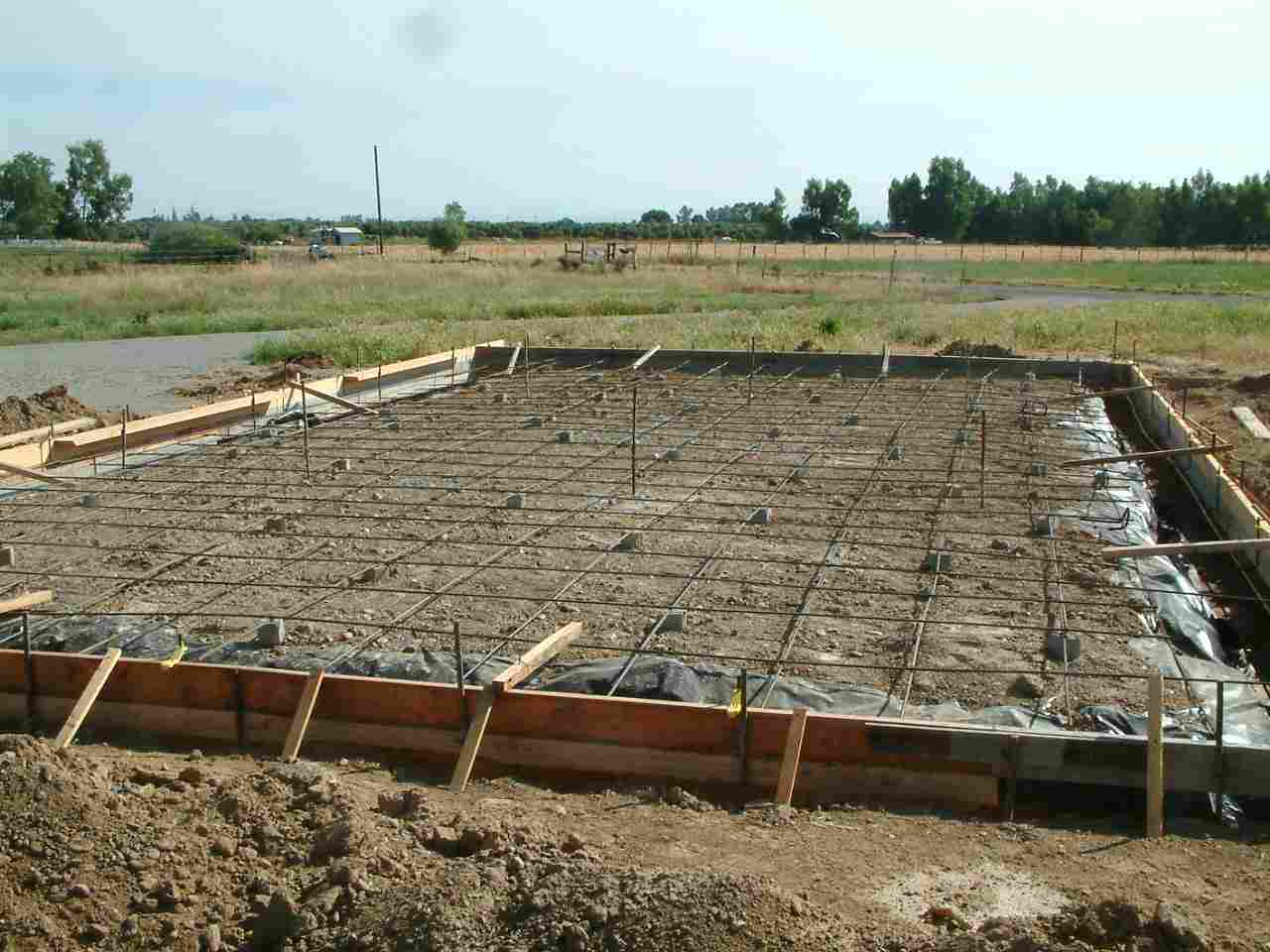

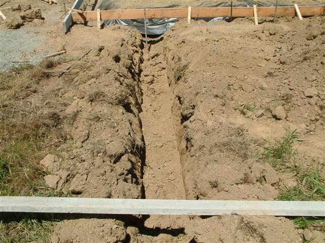

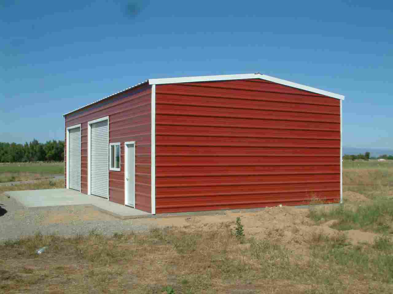

My 24x42 ft shop has 6" thick 4000 psi concrete floor with #4 rebar on 24" centers.
Good luck
