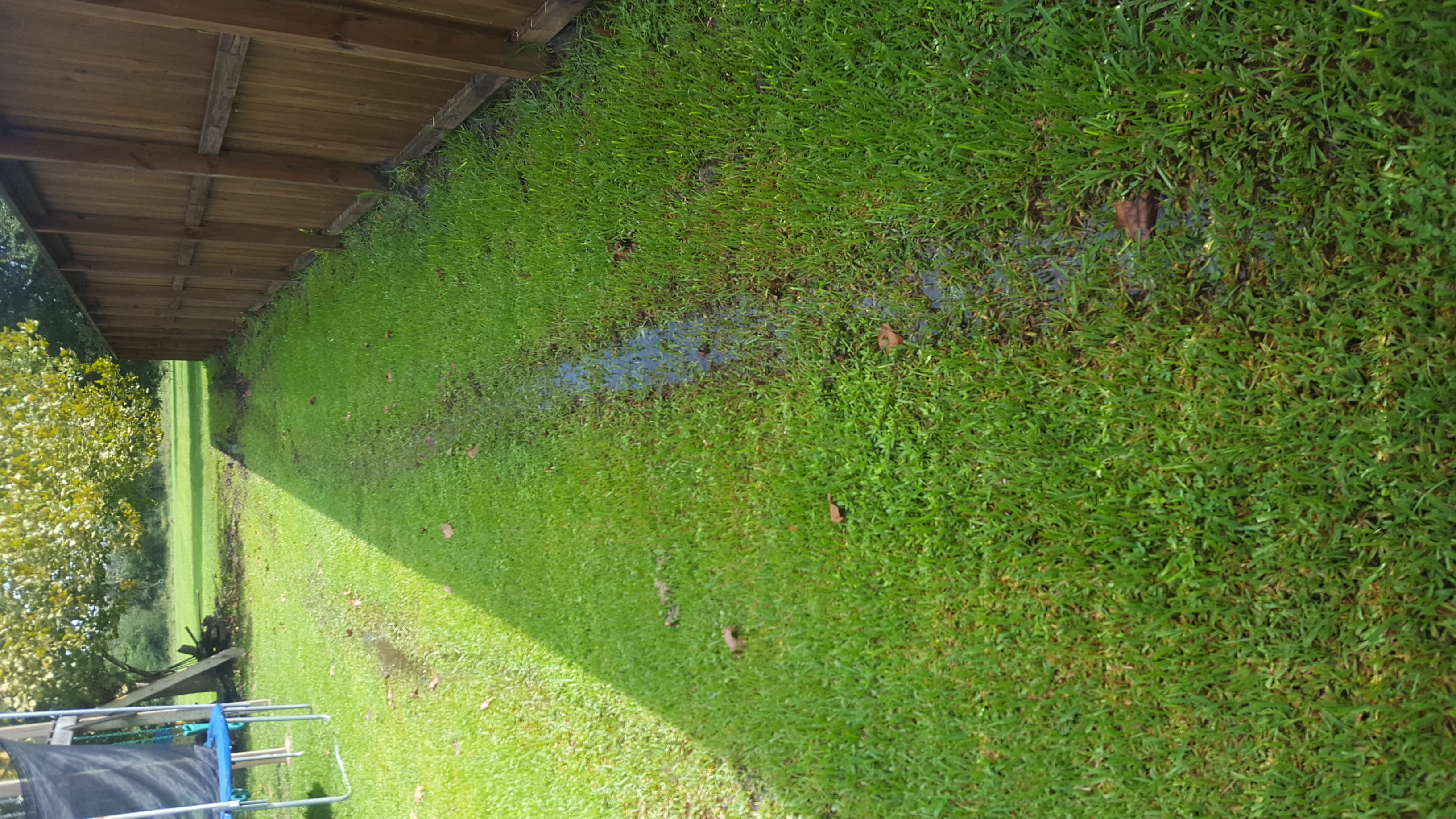

I rutted up over an acre of carpet grass lawn spraying for mosquitoes before it was dry enough. We were held hostage in our own house by insects. It was a dire situation. I don't feel stupid (yet) for doing it, but now I need to fix it. Most of the ruts are 1" - 3" but some are 4" - 6" deep.
I tried dragging bucket backwards over the ruts and the result was less than ideal. The ruts didn't fill completely in, and the giant poo stain left by the bucket looks worse than the ruts did. I have a piece of steel pipe about 16" dia x 6ft long. I am thinking of turning it into a roller that attaches to the exge of my bucket. Then I put the roller down instead of the bucket edge, with the weight of the front end of the tractor on the roller, and drag the roller back.
I feel that would be a gentler levelling than the bucket edge. But I just googled "how to fix ruts" and one page suggested that any remedy which further compacts the soil is bad, because grass dies in compacted soil. I don't want my grass to die. I don't know if they're right or not.
Do I need to till the yard or what? I don't have a tiller or any implements except FEL w/ bucket and fork attachment, and a concrete counterbalance. I'm open to buying something if needed.

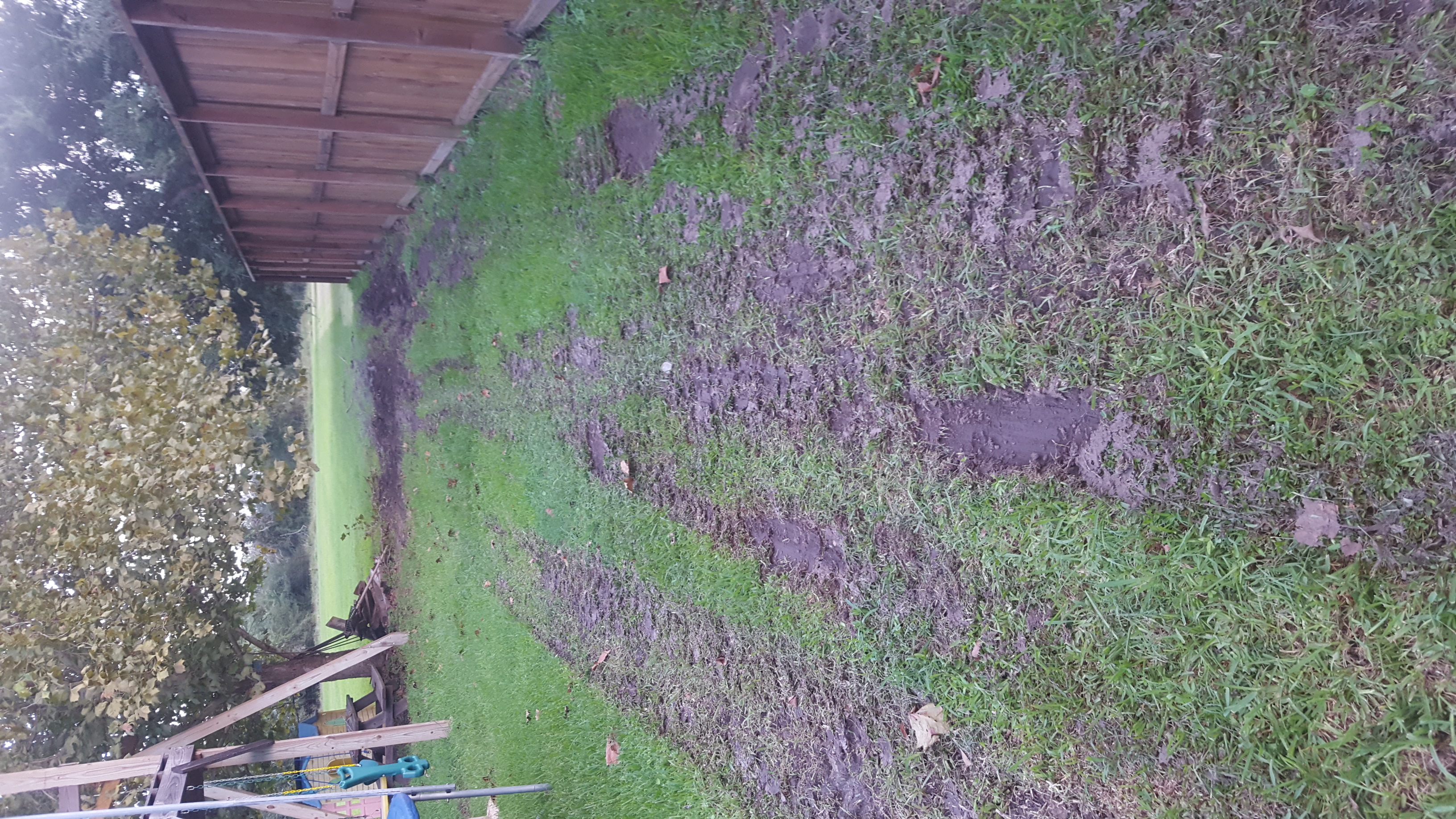

Sample spot (bad ruts)

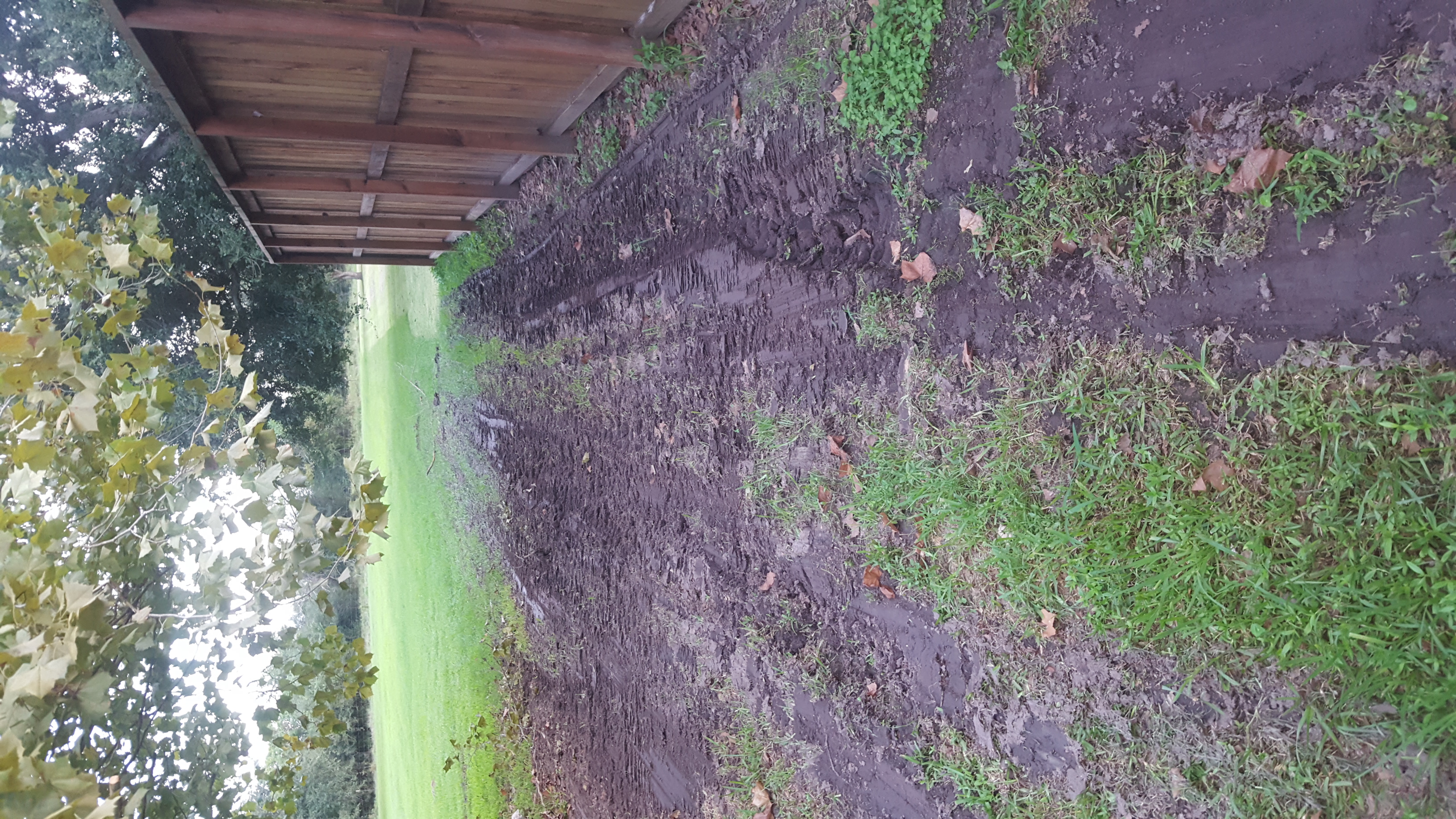

Before dragging the bucket:

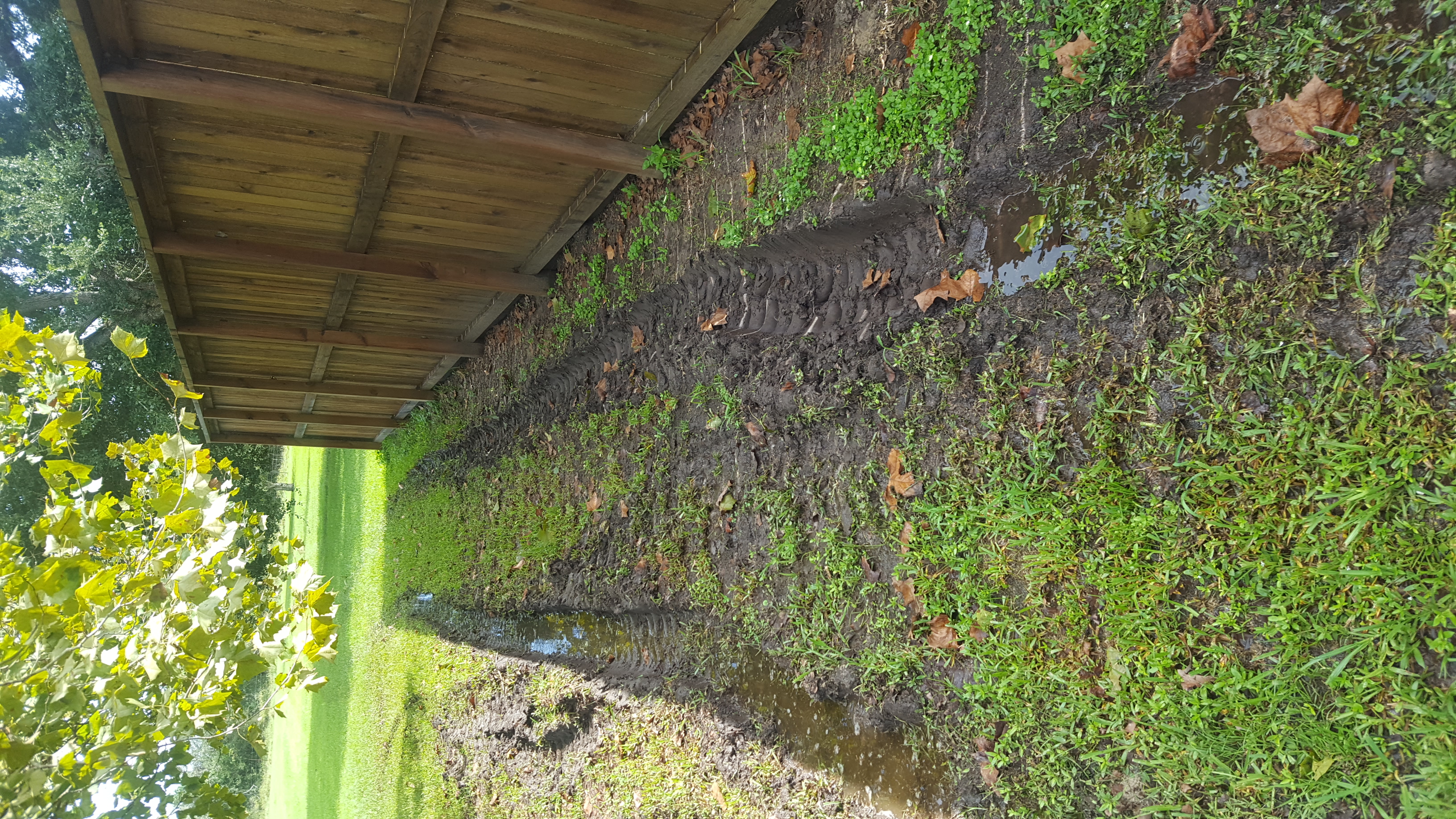

After:
   / How do you fix ruts with a tractor? #3
I would smooth that over with the flat of my bucket backing up and reseed it.. When it's drier of course.
   / How do you fix ruts with a tractor? #4
You definitely caused yourself more work by not waiting for better conditions to remedy those initial ruts.
True, those ruts will never completely fill in completely due to compaction without adding additional soil.
I would wait until it drys out when the soil is more workable without creating a bigger mess. Then I would drag it with something like spike tooth chain harrows, reseed, and roll it.
