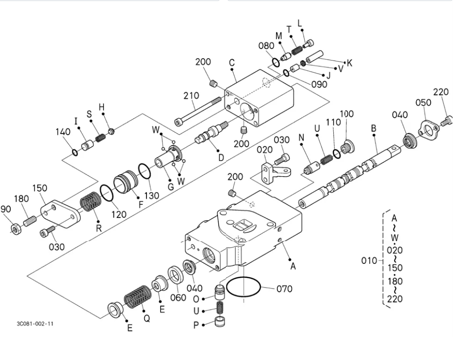

how do you get the 4 aux valve detent balls back in correctly - kubota 9540?
   / how do you get the 4 aux valve detent balls back in correctly - kubota 9540? #1
janestwo2
Oct 16, 2023
1
rtv900
   / how do you get the 4 aux valve detent balls back in correctly - kubota 9540? #2
Part W?
   / how do you get the 4 aux valve detent balls back in correctly - kubota 9540? #3
Grease so they stick in item G with spool D inside. Then slide F over that assembly.
