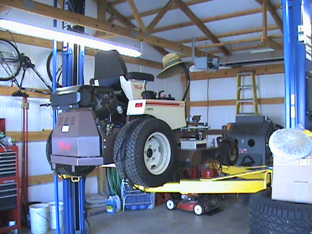

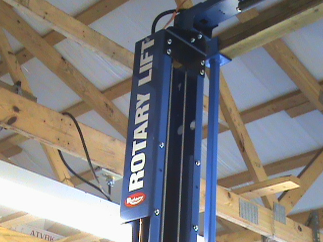

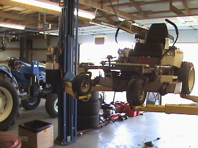

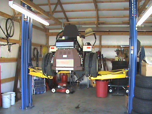

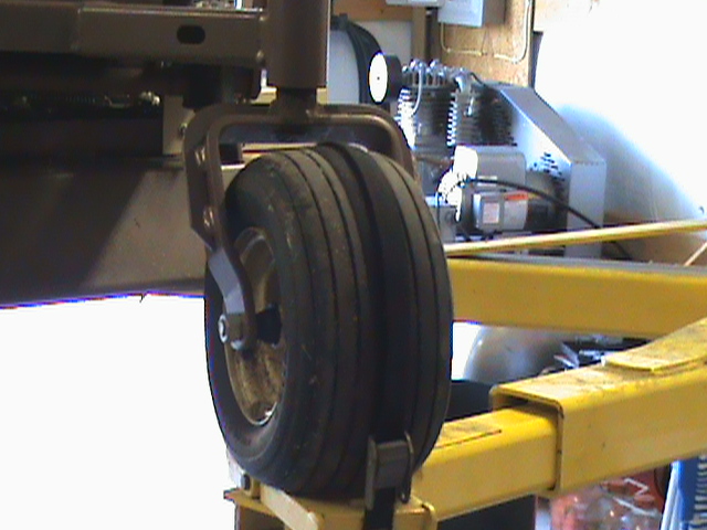

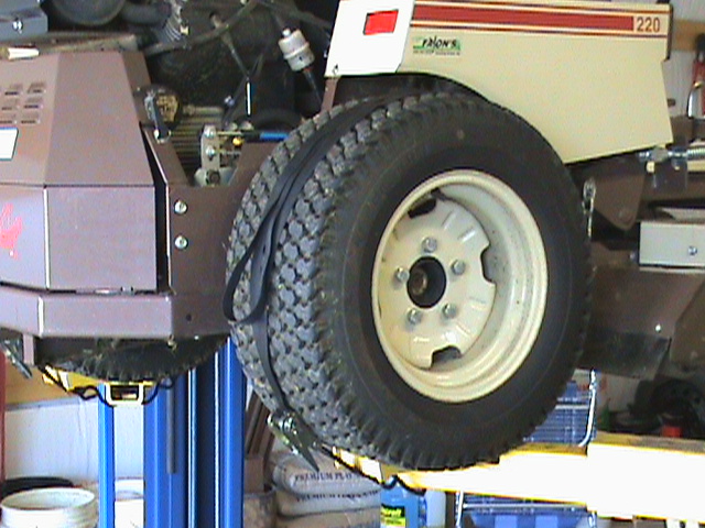

I couldn't find a way to change my blades and clean the deck of my mower safely. So I decided to put it on my vehicle lift. Of course, I strapped it down to the lift. You can see the straps in some of the pictures. Pretty soon, I plan on building an adjustable drive on platform. Just need to put some thought into how I'm going to build it. It will need to be adjustable so I can change from the mower to the 4 wheeler and then to my motorcycle.

I usualy hoist up one side and my wife shoves a couple of 8" solid wood blocks under the wheels. I chock the other side wheels and crawl under, wrench in hand.
   / How do you guys change your blades and clean your mower decks? #3
I drive the front wheels up the same car ramps I use to change oil in my cars/trucks.
   / How do you guys change your blades and clean your mower decks? #4
I put a strap on my Landpride finish mower and pick it up with the bucket on my Massey Ferguson. Strap the front of my Snapper and hold it up on end with the bucket, also. Standing them up, I don't have to get under either one.

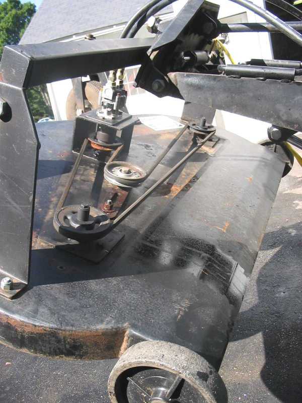

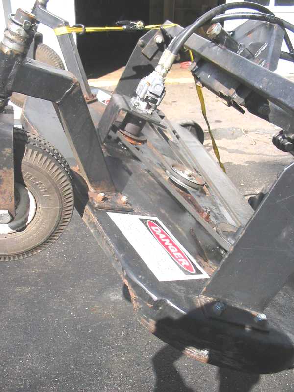

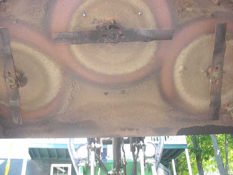

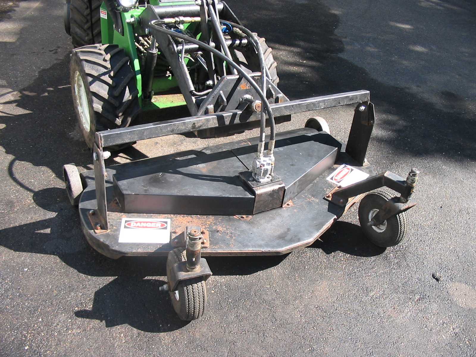

Well, I use the lift control lever, then tilt it back as far as it will go with the tilt function, and then wedge a 2x or 4x under it, just in case. Then I just reach under it, as needed.
Sometimes I put a strap on it to keep it from pivoting, if I'm going to be working on it for while, but sometimes not... depends on what I'm doing and how long I'll be working on it.
