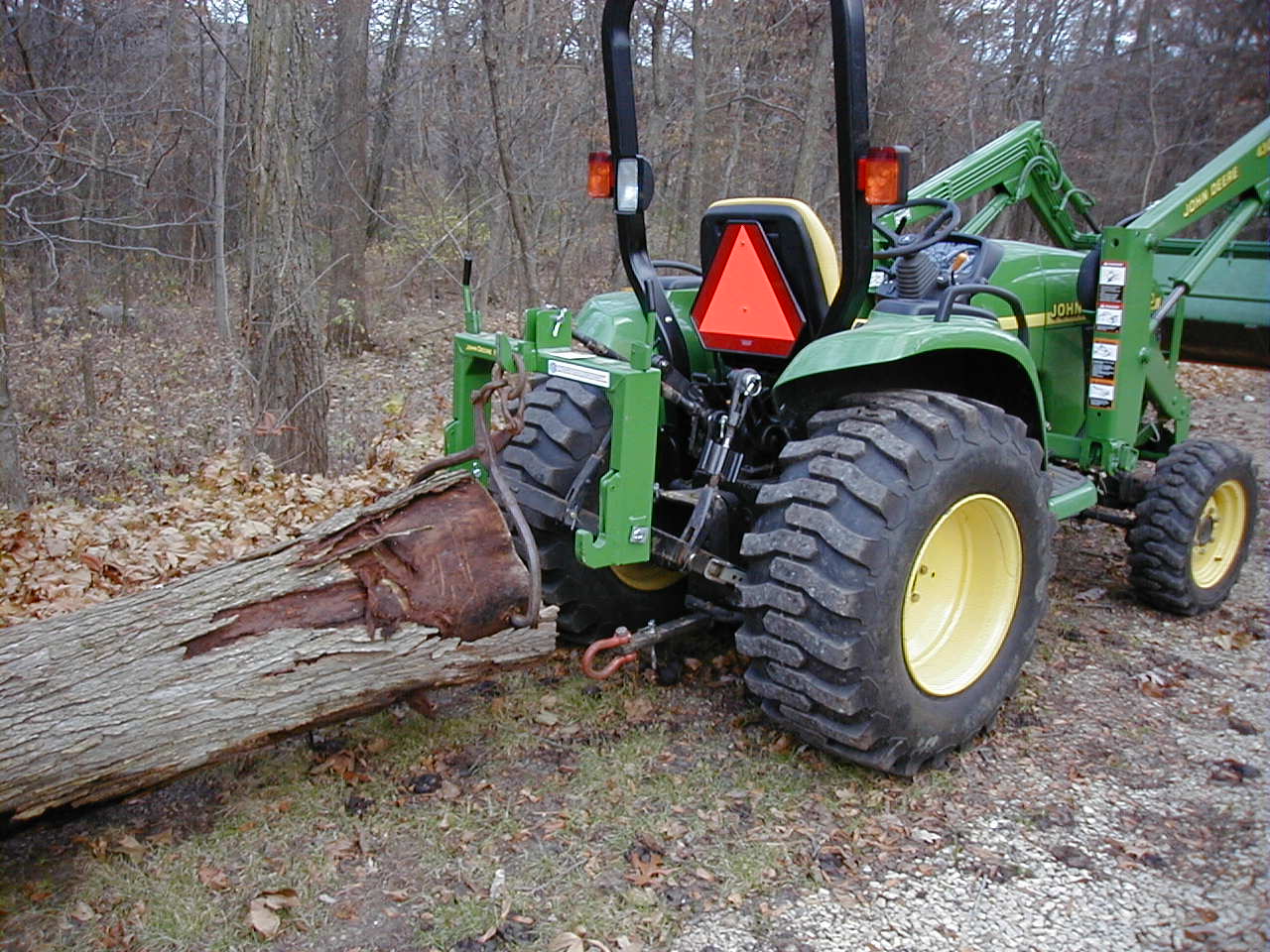

Hook them onto the top hook of the quick hitch (mine is iMatch).

Hi sir. If you use that kind of hook to pull logs ALWAYS be carefull because the higher you will put your 3 pts, the easier it will be to flip the tactor over if your log hit a stump, a stone, a solid root....( you flip over in less than 3/4 of a second so ,too fast to push the clutch or do anything.....ask me how I know ....luckily the tractor stalled when I was looking at the sky (where I was going with the angels) , it is so fast you cannot imagine) There is logging winch that are safer ( I have a Farmi), the lower blade protects the end of your log when you pull....it is the best advise I can give you ...and use your ROP in case of. Good luck and BE SAFE .Roger

Perhaps not in your budget, but I would recommend a Log Arch. I purchased a Log Rite, but many others have made their own. The big thing with a Log Arch is safety. Like others have said, getting the tongs too high can cause your tractor to flip. One thing for sure, be sure your ROPS are up and you have your seat belt on.

I believe that is absolutely wrong. Consider the physics. You are a high risk of flipping the tractor over.
The tongs should be connected with chain and clevis to the draw bar (below the rear axle).

Frankly this is a really dumb explanation/rationalization for an even dumber practice of using the 3PT hitch inappropriately. I don't mean to insult you but there are naive tractor owners who just might bite and copy your method so it is necessary to make clear that this is just plain dumb. No other way to describe it.
If you cannot get the log up high enough using the drawbar then skid it on top of something like a car hood, don't risk a well known fatal accident waiting to happen.
