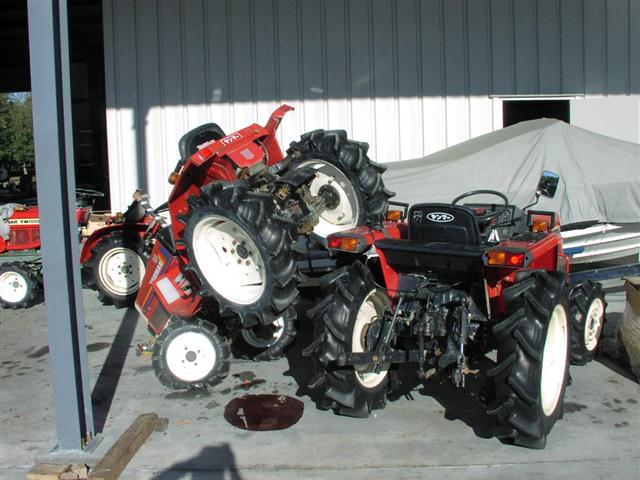

Here is how not to park one....

</font><font color="blue" class="small">( Here is how not to park one.... )</font>
Dave,
Just looks to me like they're doing a L/R axle seal..... /forums/images/graemlins/grin.gif
