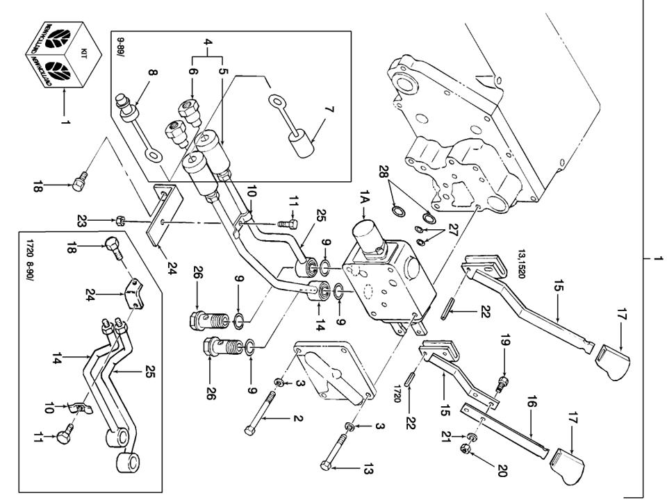

I want to put rear hydraulic connectors on the rear of my ford tractor.
I think the best way to do it on a ford is to split off the inlet side of the hydraulic manifold block and make a loop in the system.
Thoughts?

The best way is to buy the kit from New Holland: SBA340002301 (see attachment)

take the two plugs out of the hyd manifold on the right hand side and put a spool valve on the fender and hook up some lines to go in between and turn the flat head screw on the manifold 90 degrees and go use it will work just put one on a 1320
