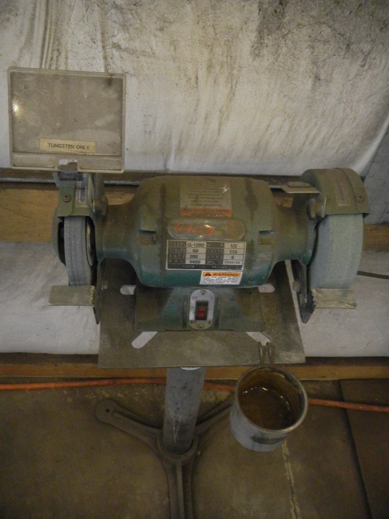

Can you use a handheld grinder with a diamond wheel, or do you have to spend hundreds on a dedicated tool? Stationary grinder?

At work we use a sanding belt. If we are tigging stainless we make sure the belt isn't contaminated with carbon steel that would cause rust in the weld.
   / How do you sharpen your tungsten? #3
No, you don't need a diamond wheel or dedicated tool, use whatever you have on hand. Always try to grind with the tungsten oriented vertically to the wheel's direction of rotation.
   / How do you sharpen your tungsten? #4
I use a dedicated wheel on a bench grinder. I never have been much of a Tig weldor but I can get by. So I don't see the need for a $300.00 tungsten grinder.
One of the best Tig weldors I've ever met, Engloid you can do a search for his name on any of the welding sites, the guy is amazing! He is of the same mind set.

I had myself in a little panic right before I posted that, "tell me I don't have to spend another $300..". After reading for about an hour on some other sites I see there's quite a few ways to grind them, that I already have. I like the diamond blade on the side of the grinder stone trick, that only takes another 1/16" of shop space. But here's another ?, do you have to worry about contamination when you're welding mild steel? or is it just on stainless, alum, etc.? (for shop repair stuff, I'm not trying to pass any tests)
   / How do you sharpen your tungsten? #6
Bench grinder, tungsten only wheel.

   / How do you sharpen your tungsten? #7
I just use my bench grinder with a dedicated wheel. The only thing extra I did was to purchase a fine grit wheel. The wheel was kind of pricey. I think I paid around $30.:thumbsup:
