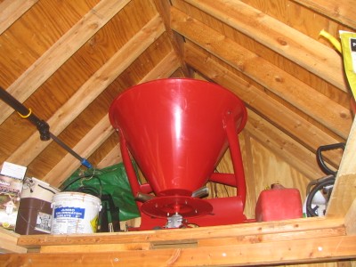

I hate to store attachments outside if at all possible. With a PTO spreader, since they are so light, I store mine in the loft of the shed. I just put it in the FEL, raise it up until its level. Then I stand on the hood guard and the spreader easily slides onto the shelf. Don't know if that is an option for you, but it works for me! /forums/images/graemlins/smirk.gif
