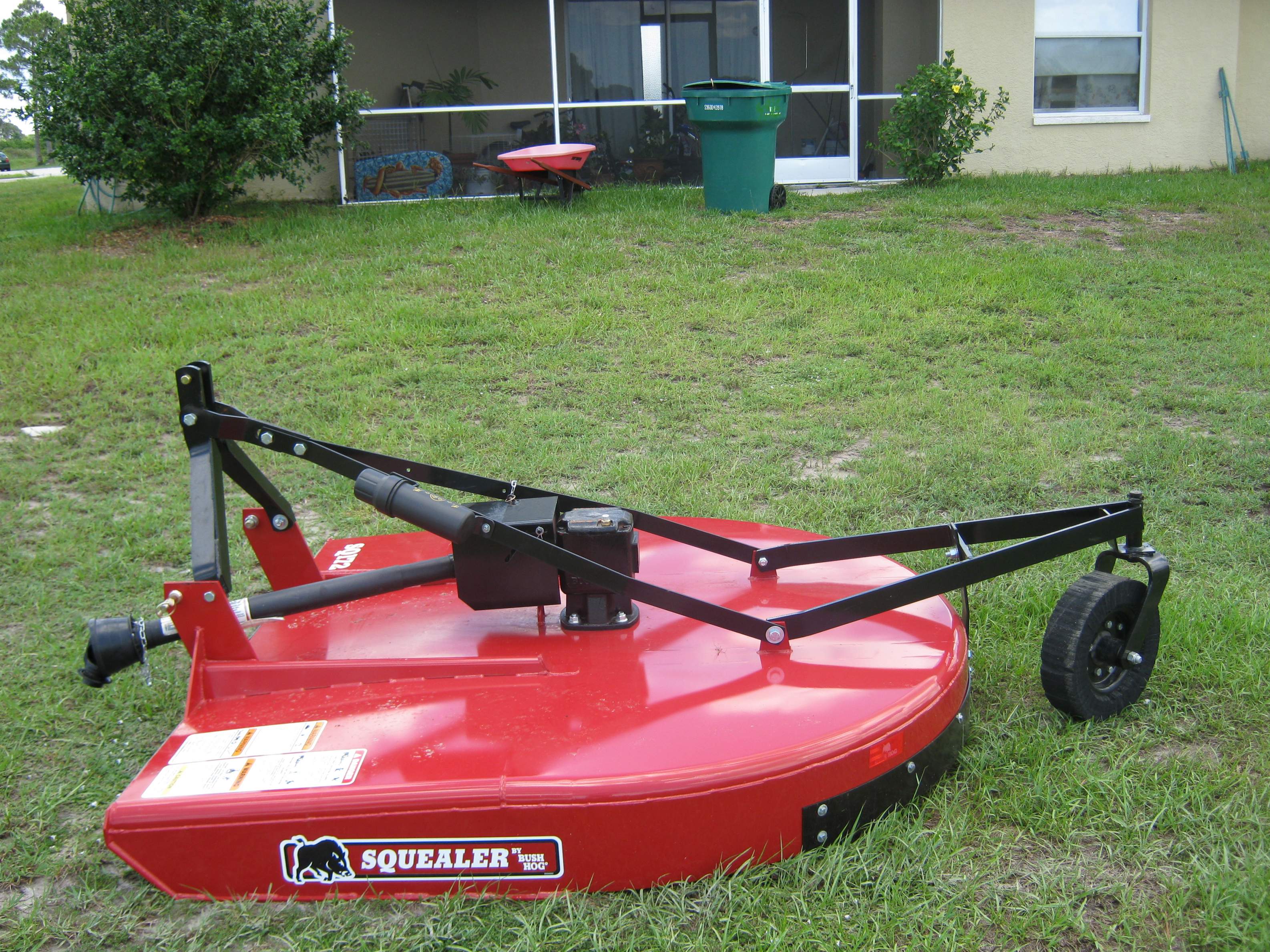

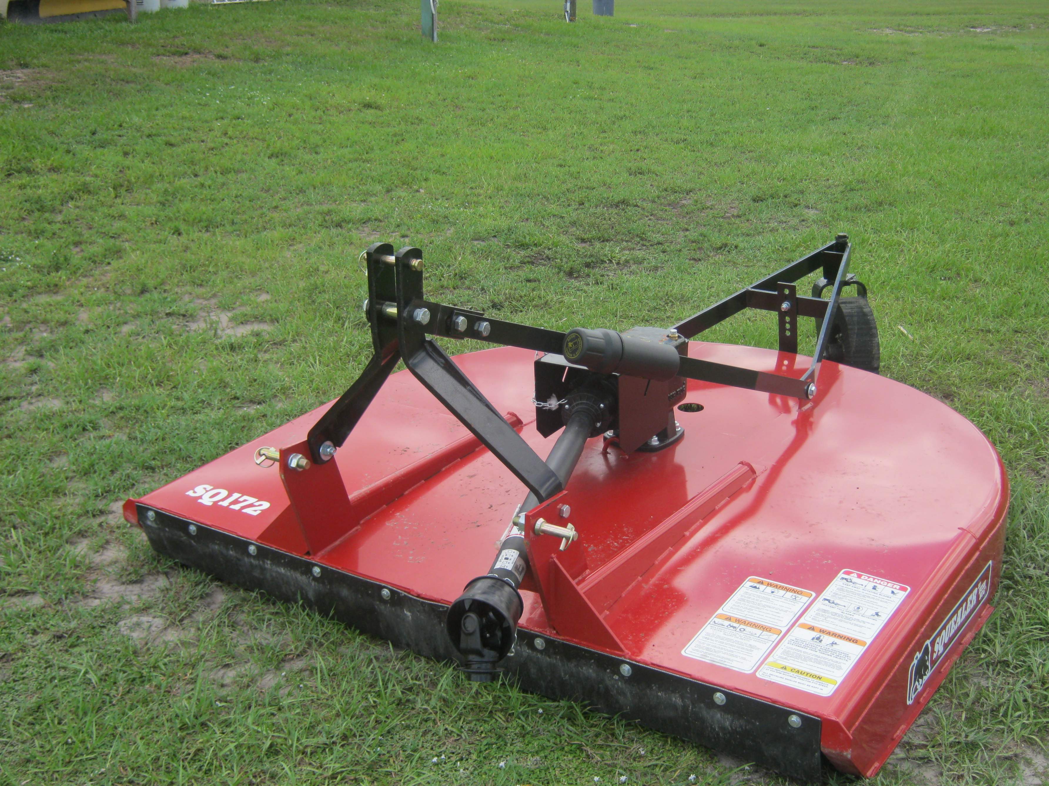

My Bush Hog sq172 came w/welded on support bracket for PTO shaft.
Boone
