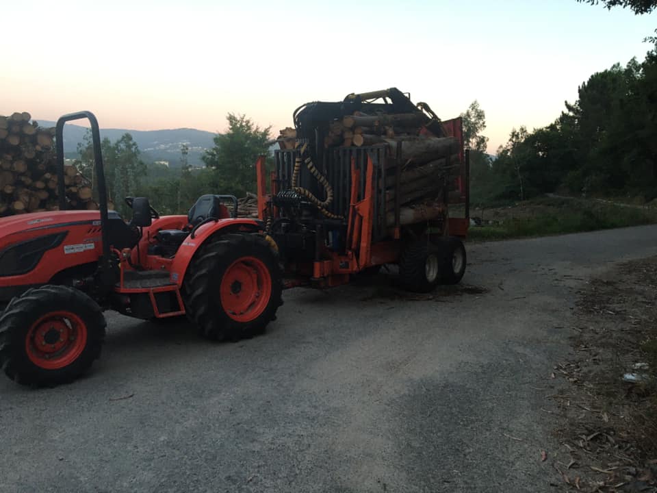

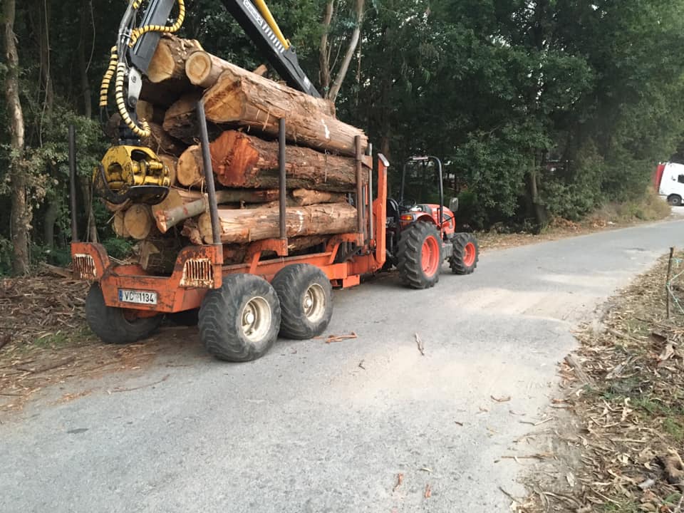

Except in countries where tractors with 50HP and lower are used to make a living on farming, logging or even land clearing, but this may also be the reason on why HST tractors have to be special ordered on this side of the pond.
Another point to consider is that tractors are drove on the road a lot and won't have to fully stop and change ranges on a slight hill. Just a simple gear downshift on the move and you're good to go.
Kioti DK5010 pulling some sticks for reference:
107936787_2717602271810325_1726853769495266960_n.jpg 106923650_2709561835947702_7148501979511862537_n.jpg
