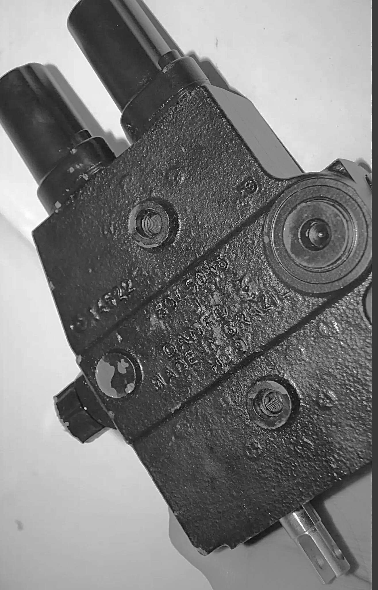

The loader control valve is a: Sauer Danfoss RE179201. I can’t see what the port on the back side of mine is labeled, but I found a picture of my style, and it shows a “P” for the back side port.
My manual says that the line to the P port is an “Excess Oil Return” line. Like the “T” port being used for what manual says is an “Oil Supply” , this also seems backwards. Yes?
I’m starting to think the manual is off. Or maybe the dealer piped the loader valves “T” and “P” ports backwards? … Would that matter? It hasn’t so far.
…but the port to port connections (however labeled/mislabeled) from the tractor to the loader valve are connected like the manual shows. And everything works.

Would a DUAL SPOOL control valve operate with input and output like that? Again, the simplest type would....it's just two singles in parallel. But yours isn't that simple. From your photo, yours \also has a relief valve & a float position. Plus I would be surprised if your loader plumbing doesn't also allow for limited regenerative flow in each hydraulic cylinder. So without a cutaway view of the SCV I don't know. My guess is it might work somewhat with the P and T ports connected in reverse, but not as well or as fast as it should.
JD is very sophisticated with their hydraulics. But that model was not US made, it was made overseas so maybe there are some translation errors. See if you can find a cutaway view of that SCV and go from there.

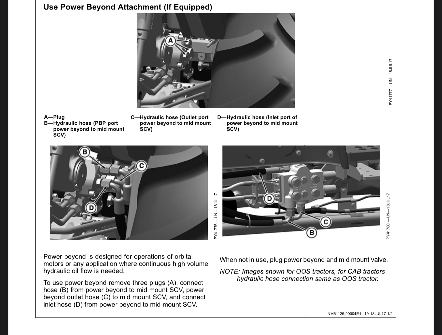

I’m trying to figure out the function of the ports at the power beyond block at my tractor. (I.e. does my manuals have typo, or is the loader valve “T” and “P” ports piped “backwards”?).
Here’s a “similar” photo from a manual that is years newer than my manual. Can you tell flow direction from the descriptions?
It shows the EXACT SAME port-to-port connections as my manual shows (and tractor has), between the tractor and the loader valve. Loader operates fine.
….but they have different descriptions…and it’s hard to tell which end of the hose the “inlet” or “outlet” refers to.
“B” line to the loader valve port “T”: Picture call this “B - PBP port: power beyond to mid-SCV” (My manual tagged this as: D line- Oil supply hose)
“D” line to the loader valve port “P”: Picture calls this “D- Inlet port of power beyond to mid-SCV” (My manual tagged this as: “B line - Excess Oil Return”)
“C” line to the loader valve port “PB”: Picture calls this “C- Outlet port: power beyond to mid-SCV” (My manual calls this “C - Oil Return)
In both cases, does it sound like the valve’s “T” port is receiving pressurized oil supply?
   / How does hydraulics (& PowerBeyond) work? #10
Sounds to me like the guy writing the manual didn't understand hydraulic systems. You might check to see if your shop manual has a flow diagram.
That may help.
