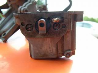

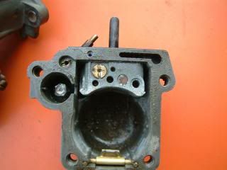

I am going to post 8 pics in 2 posts.
The first 2 pics are of the 2 different sides.

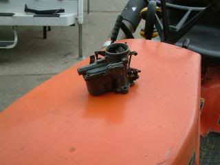

notice the rod going into the float bowl on pics 2 & 3 . i think this is for accelerator pump.

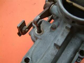

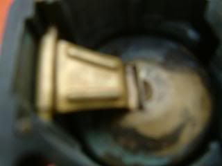

pics 4 & 5 are the float bowl. Notice the groove, and one end has an indent/concave, the other side is more convex. so which end is up, and which is down on this float bowl?

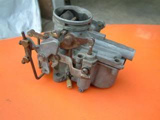

this is a Zenith VN carb. i noticed B64 stamped, and I also saw letters that looked like C1836 or C1886.
   / how does older carb work? mine won't stay running. #9
The accelertor ppump has to move freely up and down and on older equipment usually made of leather rather than neoprene .
As the name suggests it pumps ( Squirts ) extra fuel into the carb on acceleration. The float sits at the bottom of the float bowl and allows fuel to fill the bowl assembly until it raises and shuts off the fuel supply by pushing the needle or flap over the hole the fuel comes in. Look inside your toilet to see exactly how the float works. Same principal.

!st pictures isn't clear as you said, to me it looks like the lever that shuts off the needle is up side down. It looks like it could dig into the float.

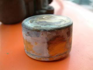

I found a Zenith VN carb diagram. I have the "float arm pivot assembly" (flap) positioned correctly. And the groove on the float should be at the bottom.
I was close on describing the "block". Zenith calls it "emulsion block" On the bottom/underside of that emulsion block is a mainjet and a compensating jet. The 2 brass jets I removed (there are 2 stacked on top of one another on the top of emulsion block) are essentially pilot jets.
They call the accelerator pump that is stuck "pump piston". There is also a pump spring under it, and a pump check valve.
Even if this pump gives a squirt on acceleration, if all the jets were working I should still be able to run without manually dumping in fuel. I think the jets on the underside of the block may be plugged up.
So folks, what's the best product to soak in to free up these stuck pieces, and to give me a chance to remove that emulsion block screw? can I use mild heat on that screw to help persuade it? Impact driver?

I was able to remove the emulsion block. I hit the screw with one smack with impact driver (after it had soaked in diesel) and it busted loose easily.
yep, the bottom 2 jets were covered in white sludgey slime. it is scaley where it dries, and like a thick vaseline gel where it's been wetter. My theory is this is from that awful ethanol in fuel. Or does normal gas just turn into this?
the piston still won't move. Now have the piston covered with PB Blaster. If that doesn't work. I'm moving to the next snake oil= nitrolube. Actually made locally, and according to them...the best ever.
so, if i ignore accelerator pump and piston, this should still run ?? the pump just gives it a little shot of fuel when you accelerate (?). So if I don't have this, maybe I'll just have a delayed response when I throttle up....kinda like poorly tuned high/low screws on 2-stroke stuff (?)

:D:dance1::cool2:WOO-HOO!! I finally got this stubborn BOS (dyslexia) out!! I tried PB Blkaster for 2 days, diesel fuel before that. I tried Nitrolube. I still think they're all snake oils, but who knows. Tried heating it up with propane (didn't want to try oxy/acetelyne). NOPE.. none of them did the trick. I knew I couldn't drill from bottom and push it out because there is a check valve in bottom.
so I used a lefthand easy out, the one that looks like a drill bit. First I drilled the recommneded hole size (7/64th for a #2 LH easyout). I drilled through the top of the piston. It i s soft aluminum and drills easy. Then I put in the LH easyout, used a cresent wrench to turn it and it spun, then pulled out. I used wire wheel on my bench grinder to clean up piston and a deep socket with emery cloth to try and clean cylinder area on the float bowl. I also cleaned the spring on the wire wheel.
I used a 2 part gas tank repair compound to patch the hole I drilled in the piston. First I cleaned it good with brake cleaner, as brake cleaner leaves no residue. You rub it together until it turns grey, then put it on top. I would have used JB weld if I had any, but this is what I had handy.
here is the spring cleaned up:
here is the cylinder cleaned up. I tried to remove check valve at bottom but it felt like it'd strip so I stopped. I blew air through it and used carb cleaner:
here are 2 pics of the piston cleaned up:
