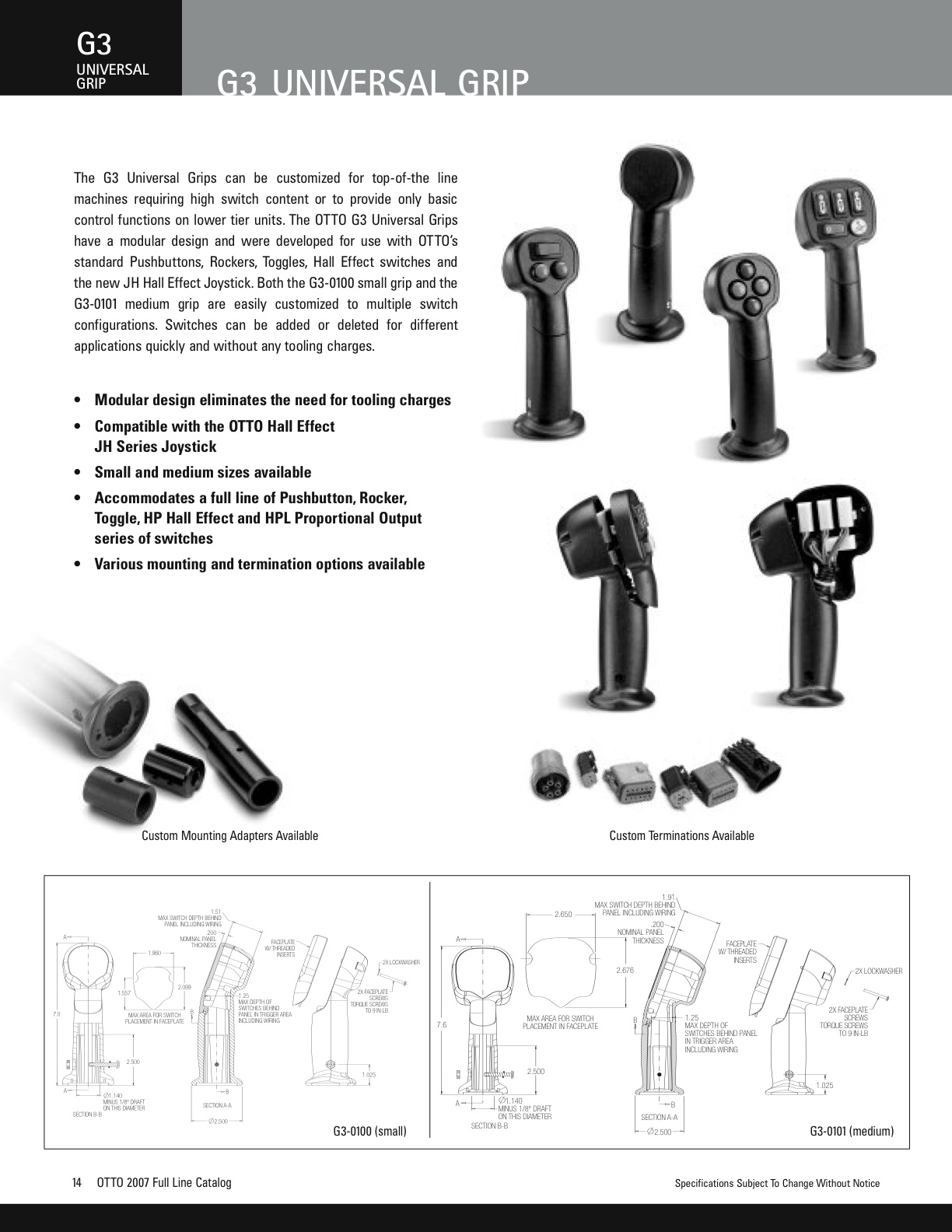

I was thinking something like the one below. I'll admit I have no idea what one of these costs, but it does look like it'd be an awesome control device and a fun project. Something like this would be a lot easier to mount in an ergonomic spot than a mechanical valve would be. It would look good too.
Would the output from a stick like this be compatible with valves that are available from surplus center?? Are there valves available that allow for differential input to the different axis' (ie light touch vs. full force) ??
I'm thinking that if possible I'd convert my FEL controls to a stick like this with a rocker switch on it to run a 3rd FEL SCV. I'd then use the current factory 4 way FEL SCV to control 2 new rear SCV's, plus I'd have the 3rd rear SCV controlled by the current single stick.
At the end of it all I'd have 3 front, and 3 rear scv's, available all the time with no selector or diverter switches, which'd be nice. The JD diverter costs $2000, so if it's anywhere near that cost, I'd do it.
Lemme know what you guys think, if I'm crazy or not...... I'm no ag or hydraulic engineer (but my brother and his girlfriend both are!!!) but if the stick's output mates easily with certain valves, it wouldn't be all that hard, I don't think??...:eek:
Appreciate your opinions on my madness.....
-Jer.

Another known source of multifunction control grips is Scorpion Technologies (Scorpion Technologies LTD.). They have products specifically targeted at the tractor market.

Yes, the remote in your link uses mechanical cables to activate the valves. Remotes are handy if you're tight on space around the cockpit/cab. The handle can be mounted in a convenient location and the valve assembly is mounted elsewhere. In this case, within reach of the 78" cables. Keep in mind that hydraulics must still be run to/from the valve and the mechanical cables must run from the valve to the handle.
The problem with most electric valves is that they are either open or closed. You can't feather the valve so cylinders react to the full flow of the pump. Careful planning and sizing of the cylinders and pump are necessary or you can't control the speed. This is why many of the electric valves have restricters--To cut down on flow and thus slow cylinder movement. Still limited control though.
