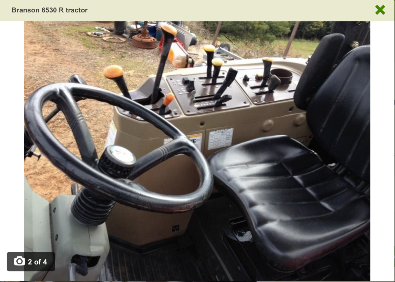

I need to remove the handles from the control levers on my 6530R ( - that's R for ROPS, not C for Cab) so that I can slide the control panels off and fix a few things underneath. (Picture of control panel attached).
The parts catalogue shows a couple of pieces on the end of the levers but not how they're attached - nor detached.
I'm sure it's simple to do once you know how. Any suggestions please?

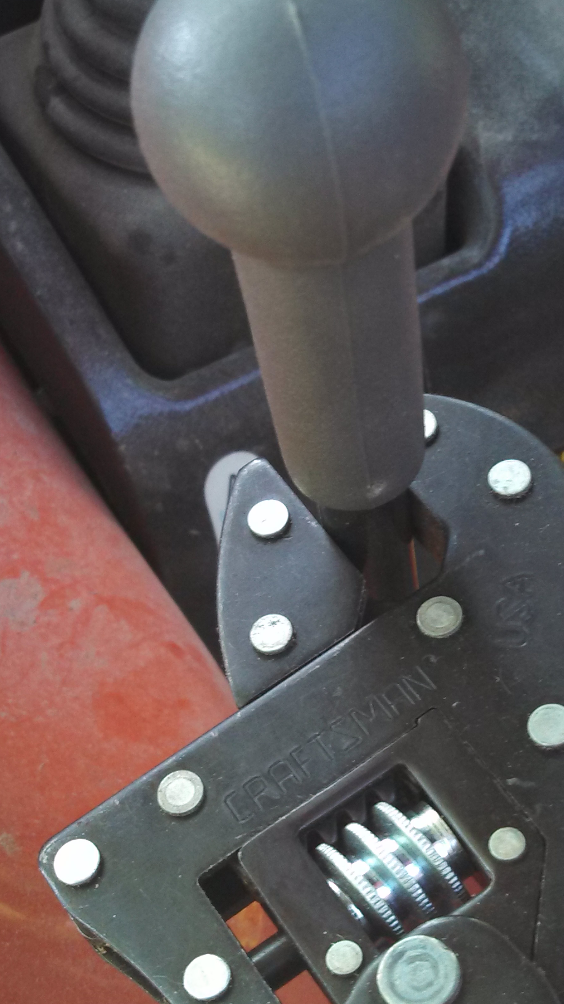

To remove any kind of push on handle tip, take something like an adjustable wrench that has 90 degree edges and close it so that it just has clearance of the operating rod. pull up on the wrench and the top will pop off easily.. Tugging on the top is counterproductive as you just make it stick harder on the operating rod, using the same principle as a Chinese finger stall toy.

Just to say thanks for your comments Texasmark and k0ua. My 6530R is currently with our Branson distributor for a few days and so he kindly showed me the trick for removing some of the handles ( - thanks Troy!). It's as follows ...
For the plain, push-on handles like on the 3-point position and draft levers, it's simply push-on and pull-off as you previously suggested. Incidentally, thanks for the tip about using an adjustable spanner. I wouldn't have thought of that.
For the levers with a yellow or orange top, like for the hydraulics or gears, you actually need to prise off the coloured top first - either by firm grasp or using a thin screwdriver blade under it. After that, there's a bolt to remove the underneath black cover. Once the tractor's back in my shed, I'll attempt to take a picture and add that to this thread for completeness, in case somebody else has the same problem in future.

Well it's pretty obvious when you are sitting there and looking at them rather than your computer screen. The ones with the pop off, colored caps are on thick shafts permitting one to tap the end. Then the handle just slides over the shaft and a screw threads into the threaded shaft end holding the cap in place. Seems simple enough.
