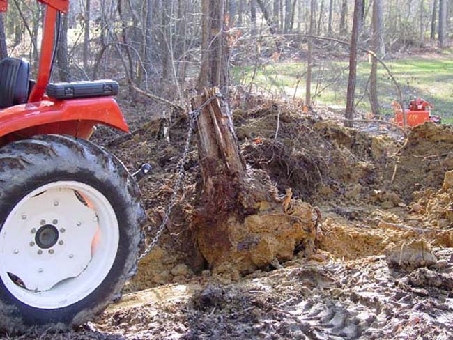

The ol’ husqy made short work of taking the tree down. Got the trunk all cleaned up and hauled off. I then took out a few scoops from the back of the stump. Expected the stump/roots to be a little rotted and with a little tugging thought it would just pop right out; especially with the ground so soft. Pulled around to the other side, hooked the chain to the stump, got back on and started moving forward. Well, the chain tightened, the tractor stopped, the wheels spun and that “rotten” stump did not budge – not a bit. Backed up, unhooked the chain and drove around to the other side. Gave the stump a nudge with the FEL and it didn’t move. Knew it was time to start digging…… Oh, how I wish Santa had brought me backhoe…..
The first pic is right before yanked it out. After about 30 minutes of digging in the soft soil I had the stump loosened pretty good. The tap was pretty deep and I had to dig down about 3 feet on three sides. Most of the feeder/runner roots were pretty rotten and dried up. Ran into a couple about 6” to 8” that I was able to just snap off while digging out.

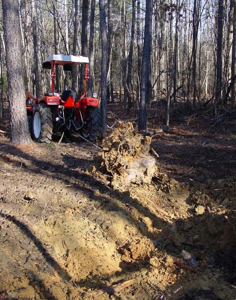

The second attachment is another view of the stump and what was left of the root ball. Was able to dig in really close and the root ball was relatively small.

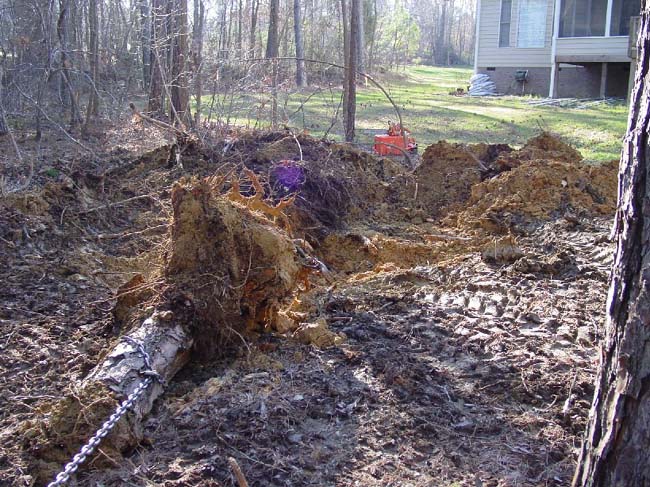

The third pic shows the result all this effort. Root finally popped out without a single tire spin.
