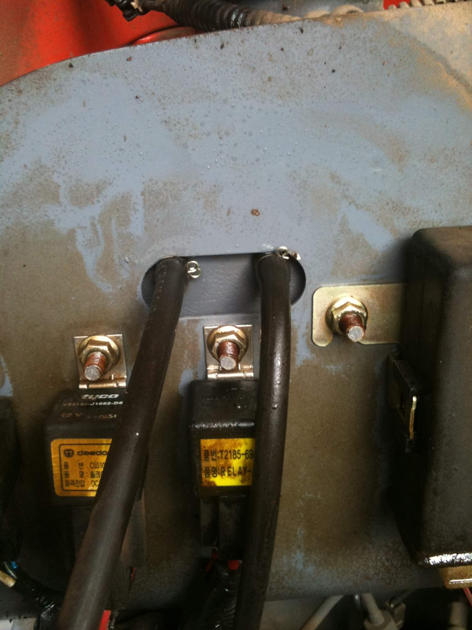

I had the fuel line rubbing issue(earlier post)with my 2008 DK40 se and called to tell (kioti dealer)Michigan Iron & Equipment I had a concern with it.Well last friday night after Bob & Denise(owners)closed up shop they drove 70 miles to my house to resolve my issue with no cost to me.How is that for customer service?Thanks again Michigan Iron & Equipment.coobie.

What was the fix?
Here is the picture of my Kioti DK40se before Michigan iron & equipment took a dremmel tool and made the opening larger so the fuel lines would not rub.Folks if you are looking to buy or purchase a new kioti tractor,need any kind fabrication work,snow moving equipment,farm equipment,look no farther than Michigan Iron & equipment.Great sales & service which IMHO is few and far between these days.coobie
