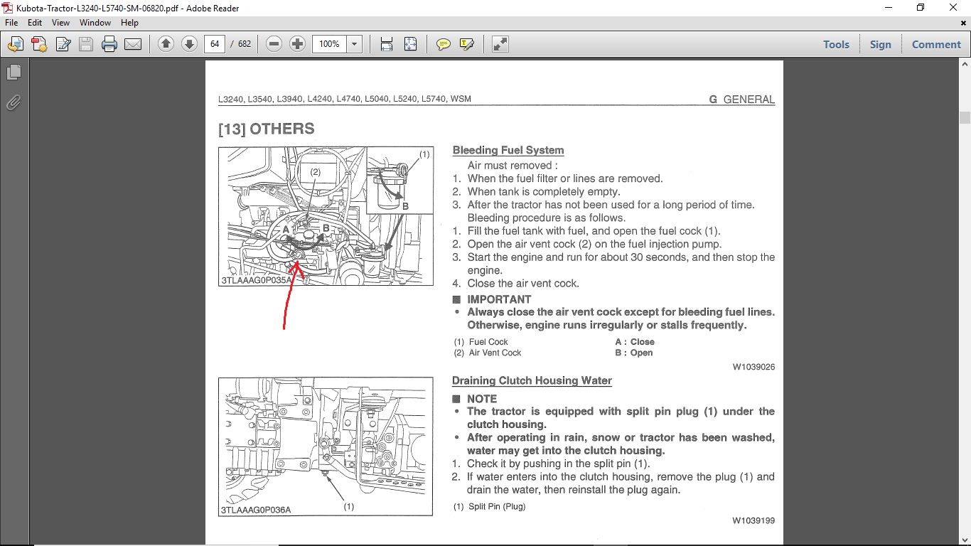

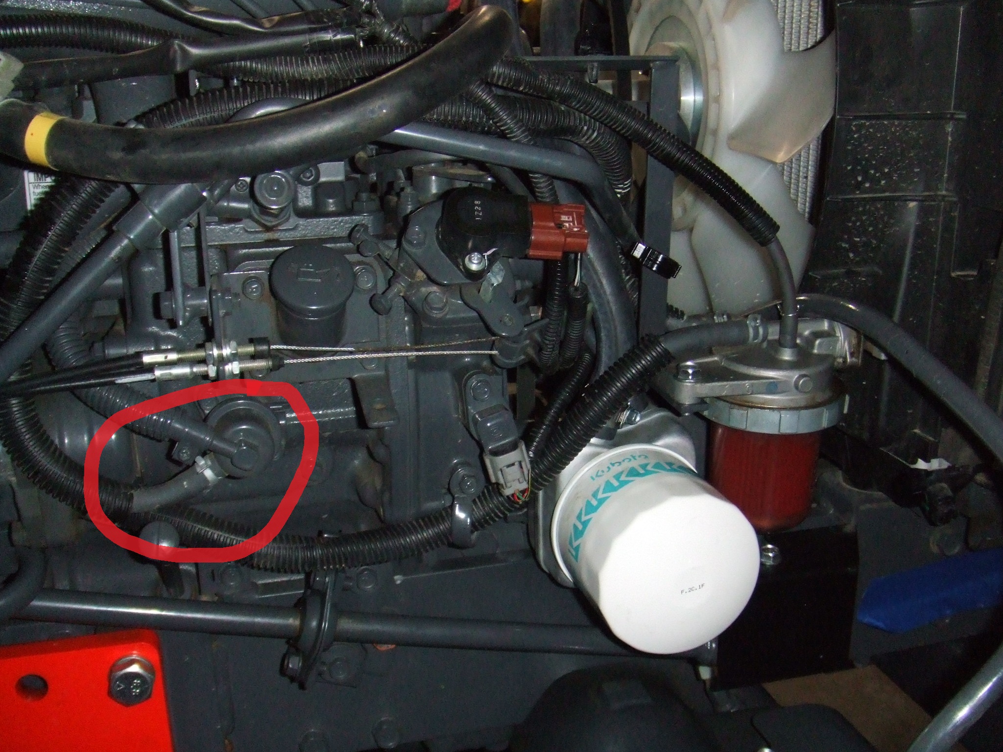

   / How long to restart after removing filter bowl...Kubota 5240 #9
Once the lift pump or pre pump gets airbound forget it. Anywho at this point you must remove a hose from the lift pump which is located just below and left of the engine oil fill cap.
Make sure you have fuel going in to the pre pump then crank the engine with the pressure side hose off and let the fuel fly, once you reconnect everything you will get flow to the injection pump. These fuel systems are quite finnicky once you've had a gelling issue or air getting into the pre-pump side. Page 64 on the left there you'll see my red arrow where the pre pump is located.
I'm guessing you figured out by now how to remove the headlight assembly to access the battery.
Once you learn your tractor's fuel system you will be much more at ease in these situations especially with this cold spell we had over the weekend. My friend's John Deere froze up the other morning and I was underneath it with a torch warming the bottom of the fuel tank where it froze, what a mess.
Good luck, Fred

Thank you Fred!
I always wondered what that thing is! Now that I know, I'll trace the lines and draw my own diagram of the complete fuel system. Is that a diaphragm pump?
