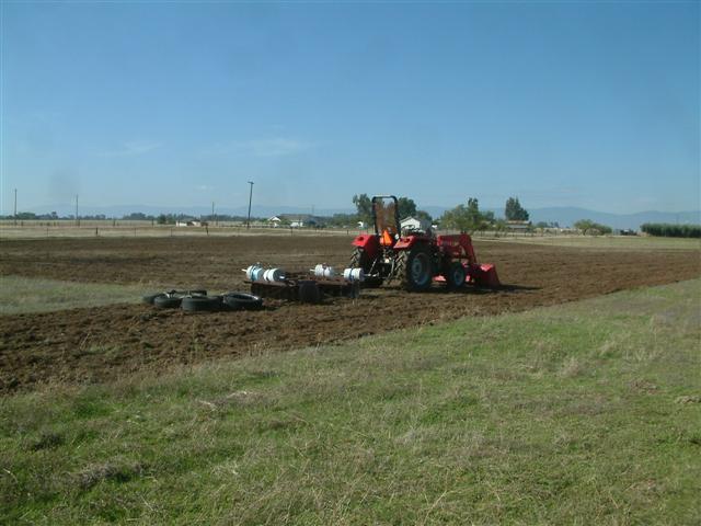

Hi Guys,
I've never owned a farm tractor before last fall so please go easy on me.
I've got 15 acres of grass/weeds on sandy soil. I need to get this field very smooth and get rye and fescue grass seed planted. I talked to a fellow this morning who recommended tilling the field, then going over it with a (I'm assuming something like a harley rake) and then dragging followed by seeding with a brillion seeder. The field has no rocks and was in alfalfa years ago. Soil is all sand.
I can rent a 70 inch tiller. I have a John Deere 3020 diesel tractor which I think is about 70 hp. I would like to hear from some experienced people before I rent the tiller and try and tackle this job. Could I till 15 acres in a weekend? How many acres/hr do you think I might reasonably be able to get done?
I don't think the tiller the gentleman you talked too is a rotary tiller. I think what he is refering too is a device that looks like a straddle row cultivator without the shanks removed to allow one to straddle a crop row without plowing up what is planted in the row. And the pulvarizer was like the photo's show by another poster.
