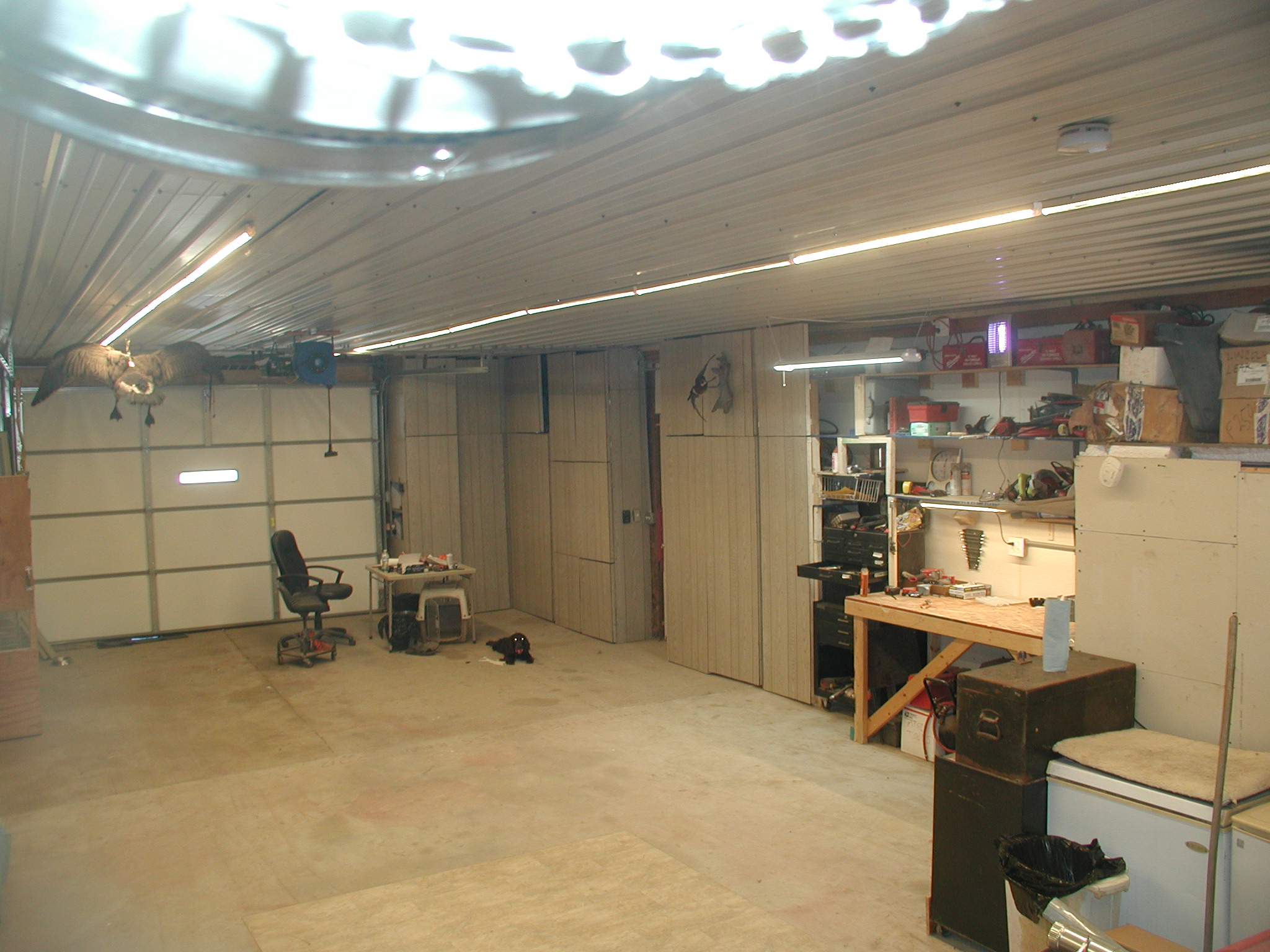

I think your plan should work fine, don't bother blowing at the doors, you will have plenty of air movement to mix the air once you close the door. Keep your 8" saddles about a foot from the reducers as you go down the line, and the last saddle 18" from the endcap at the far end. With the sizing of your duct you planned your system should work out great...better than some homes I've seen! And I've seen plenty in 30 years HVAC. :thumbsup:

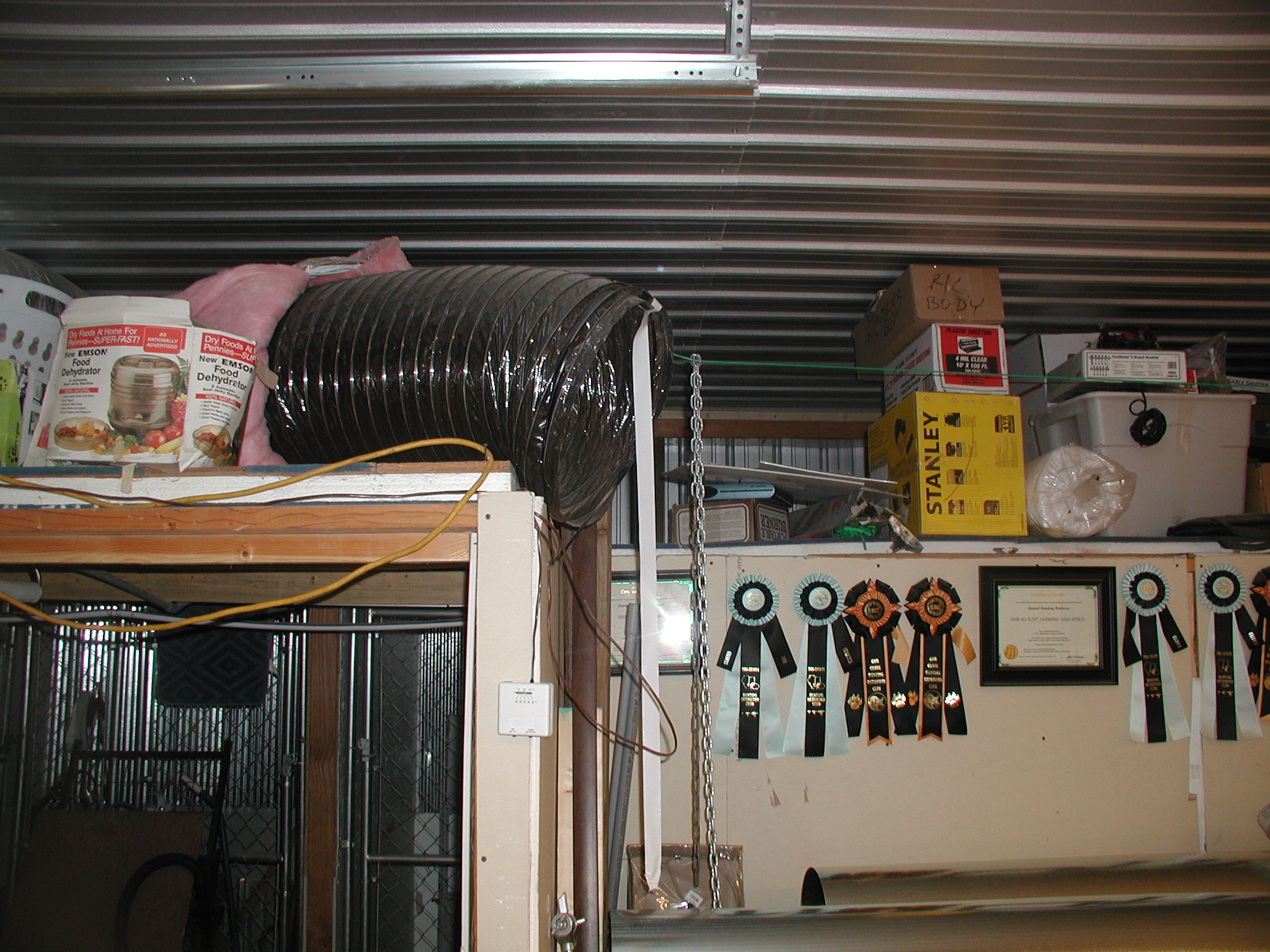

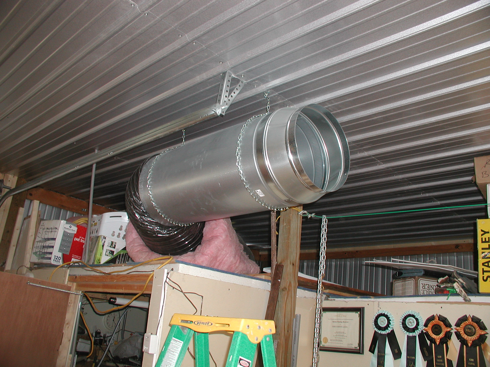

Big thanks Dadster4 on the location of the saddles, I had no idea where to put them. Here is the start of my job, I only ordered the saddles after we finished talking about them here so I will not have them until next week. I have time to do anything different, so anybody add any ideas please. Here are four pics, first is before, 2nd and 3rd are the first three foot 16" section hung by chain using sheet metal screws, and the fourth is my shop from the view of the duct, a lot of work went into this place, I am almost done with this job, so happy!

I plan to tape the plastic duct to the first section but do not plan to tape the rest as a little air leak would not hurt, I want to keep it neat and clean looking. I could use silver tape if needed.
   / How many 5 inch ducts for a 16 inch trunk line? #10
Just an FYI. I have no idea how much flex you are using, but just know it will cut your CFM's down a bit . you shouldn't have any problems though. I have a 18'' round metal with about 6' of flex.I have many 5'' take offs. I get plenty of air flow.
