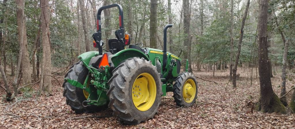

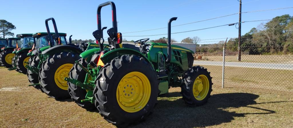

Would it take to make the front wheel and tire setup on my 2018 5075E, match the wheel and tire setup on this 23/24 5067E?
BTW, those new rear wheels look kind of funky, and less attractive than the older wheels. Why the change? They're both mounted with the same 16.9x28 tire.
EDIT: Correction. This 5067E has the optional 16.9x30 rear tire, but the standard 11.2x24 front tire. I thought optioning the 5E with the 16.9x30 rear wheel/tire was the way you got the new optional 12.4x24 front tire, and the 16.9x28 rear tire got you the 11.2x24 front tire? IDK but these 4 ply 9.5x24 front tires that used to come on these tractors are way too easy to puncture. The 6 ply rear tires haven't been an issue for me. (Knock on wood) I believe the 11.2x24 tires are also 6 ply like the 16.9x28 rear tires on my tractor?

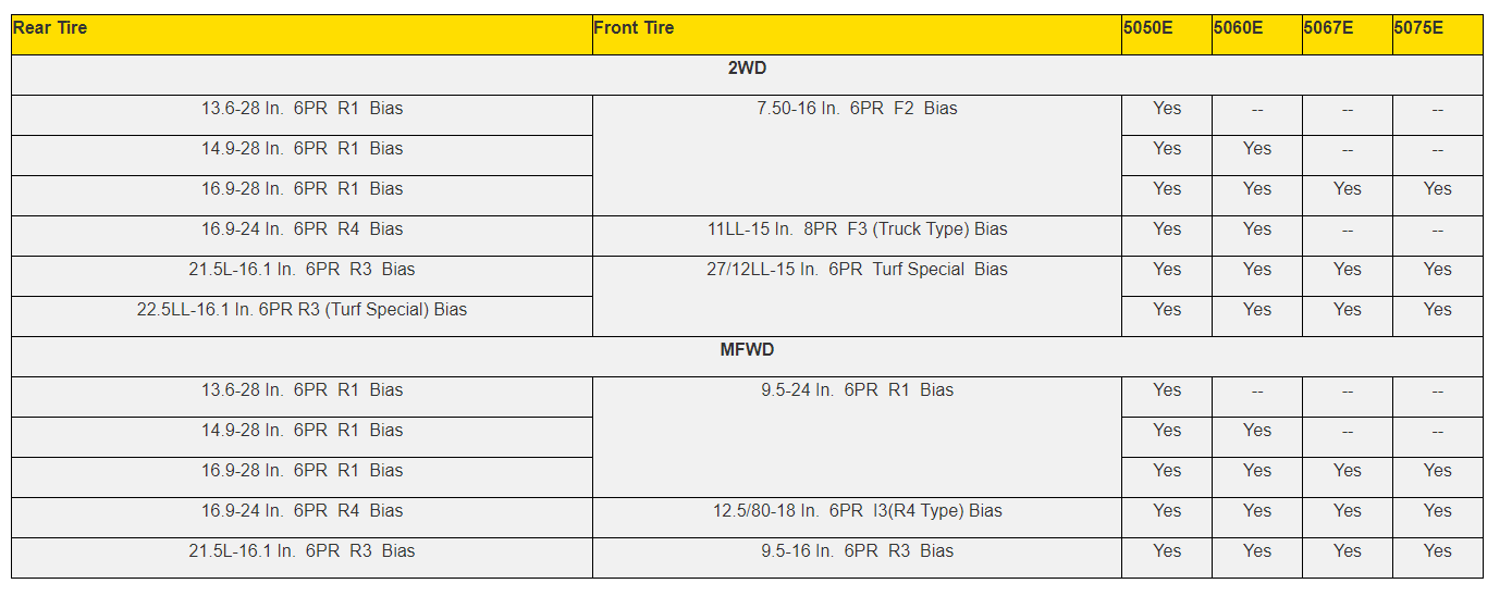

Owner's manual viewable for free online here has a whole list of permissible tire/wheel combinations:

In 2023 JD discontinued the 9.5x24, and replaced it with a 11.2x24 as standard on the 3 cylinder 5E's, with an option for a 12.4x24 tire up front if you option for the 16.9x30 rear wheel. In 2023 they also did away with the regen on the 3 cylinder 5E's and switched to a DOC instead of a DPF. A 5067E is the new 5065E with a slight HP bump. The 65-67-75 are supposed to be indicative of the HP they produce. A 5067E and a 5075E are the same tractor other than a 5075E has a little bit more HP.
