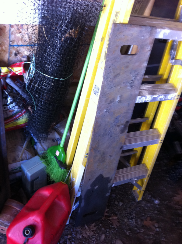

I wanted to know if 5 teeth are too many or not enough?I thought I would ask advise before I start to build.Picked up the material today,48 in long 8 in wide 1/2 in thick 25.00$ at the scrapyard.The railroad spikes were freebies.From what I've read here too many teeth are no good .

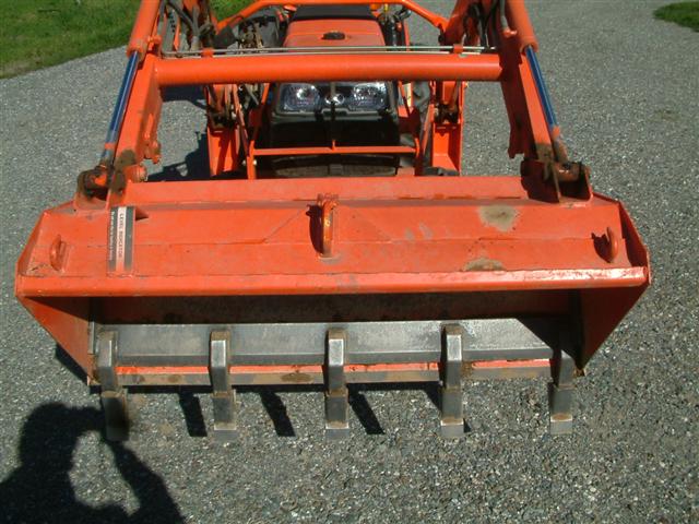

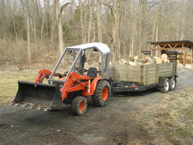

   / How many teeth 4ft toothbar #3
Like this one on my Kubota B7510HST with the LA302 FEL (4-ft bucket)

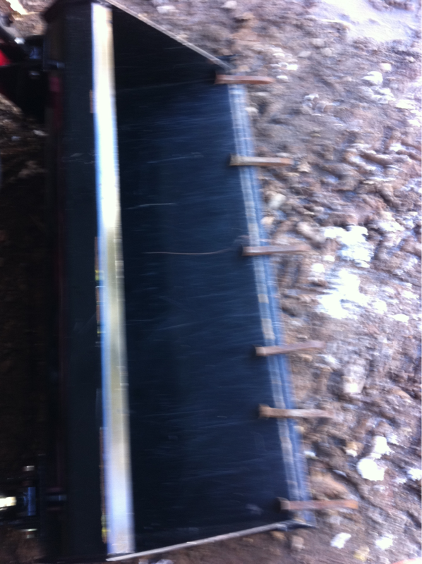

   / How many teeth 4ft toothbar #4
I have six on a store bought bar
