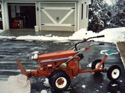

One nice thing available on the 5665 Gravely (12 hp) was the steering brakes. Could steer it with just that one black handle between the handle bars. I was lucky in finding the brakes at an ex Gravely dealer in town. Otherwise, I just could not handle the thing on the hill around and behind the house.
The BCS has steering brakes but via brake handles on each handle bar. Would require some getting used to vs. the single handle for the Gravely, more akin to learning to "drive" a ZT.
I managed to find a Gravely back in 2001 here with that big snow plow, trailer, trolly, bush hog and square chute snow blower. Later bought a rotary plow that I used ONCE since I do no till. Got those dual R1 tired wheels just before buying the JD 4010. Didn't get to use much with the dual wheels. Usually used single turfs with chains for pushing that big plow.
Do not recall what I paid for the Gravely, et.al. back then; sorry. Far lower price than the JD.
