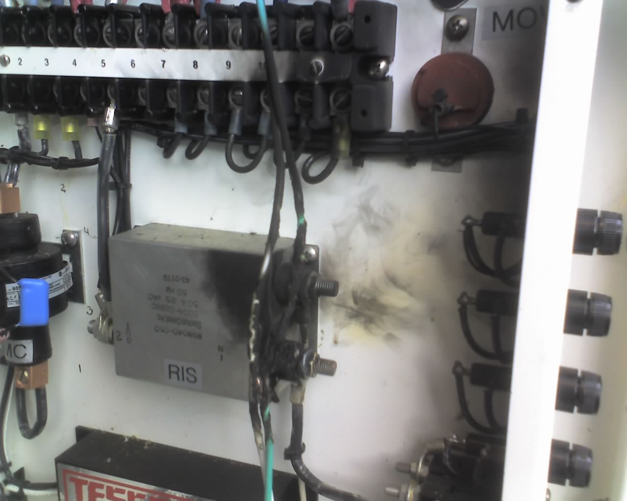

I'm on call for work this week and was called out at 0745 this morning for a dark traffic signal. This type of call is almost always related to a power outage. None the less, I have to check it out. When I arrived at the intersection, the signal was indeed dark. I was suprised when I opened the door to the cabinet and the interior light came on. Hmmm..... Not a power outage.

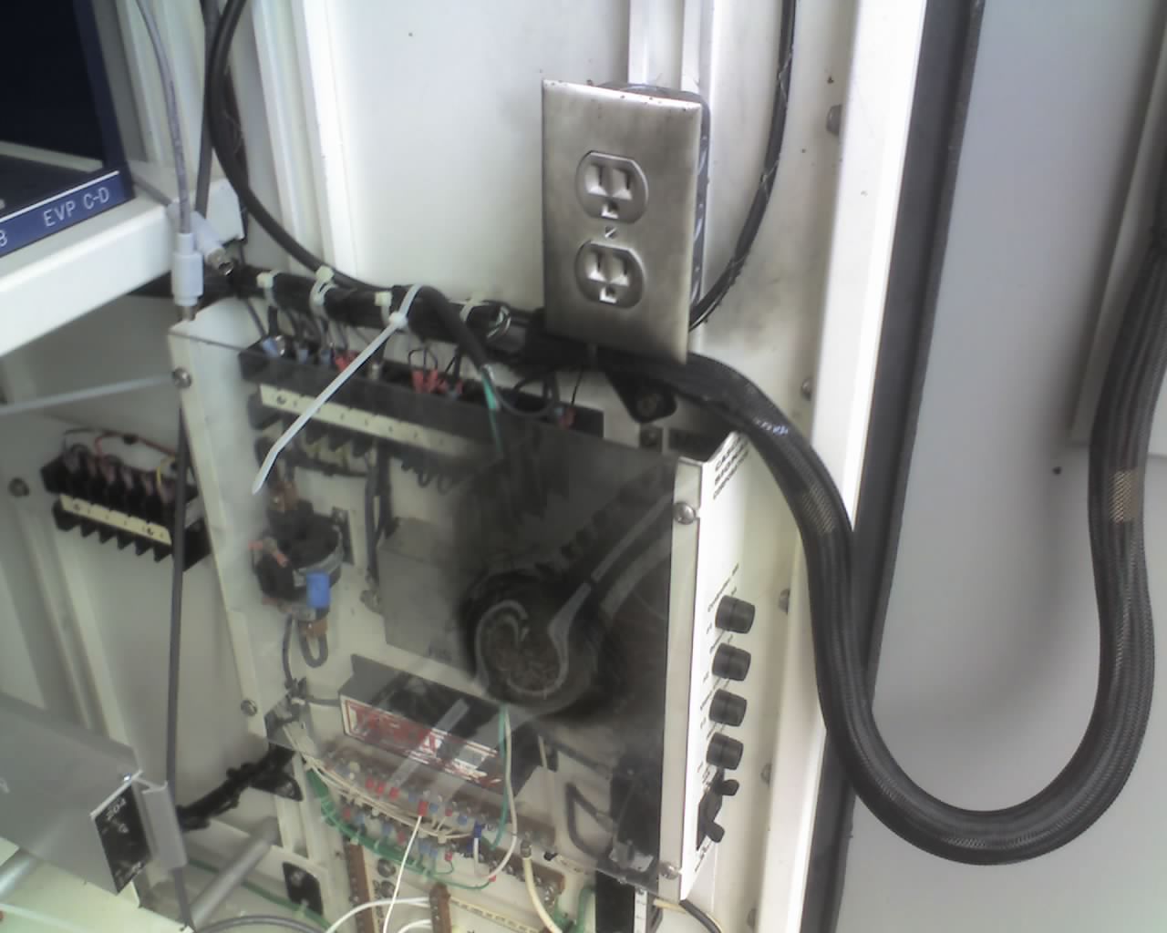

As I looked around the cabinet, I noticed that the cabinet main breaker was tripped and the clear plexiglass cover over the power inputs to the cabinet had a large charred area in the center of it. The outlet above that area was also covered in soot. Obviously we had an electrical fire.

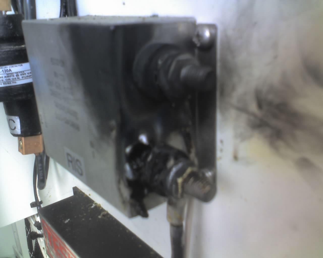

I removed the cover and checked out the damage. When the power leaves the breaker for the main cabinet power, it goes to a power line filter to ensure even power to the electronics in the cabinet. The power in and neutral terminals to the filter were fried. A hole had actually been blown in the side of the filter as well and a few wires were melted.

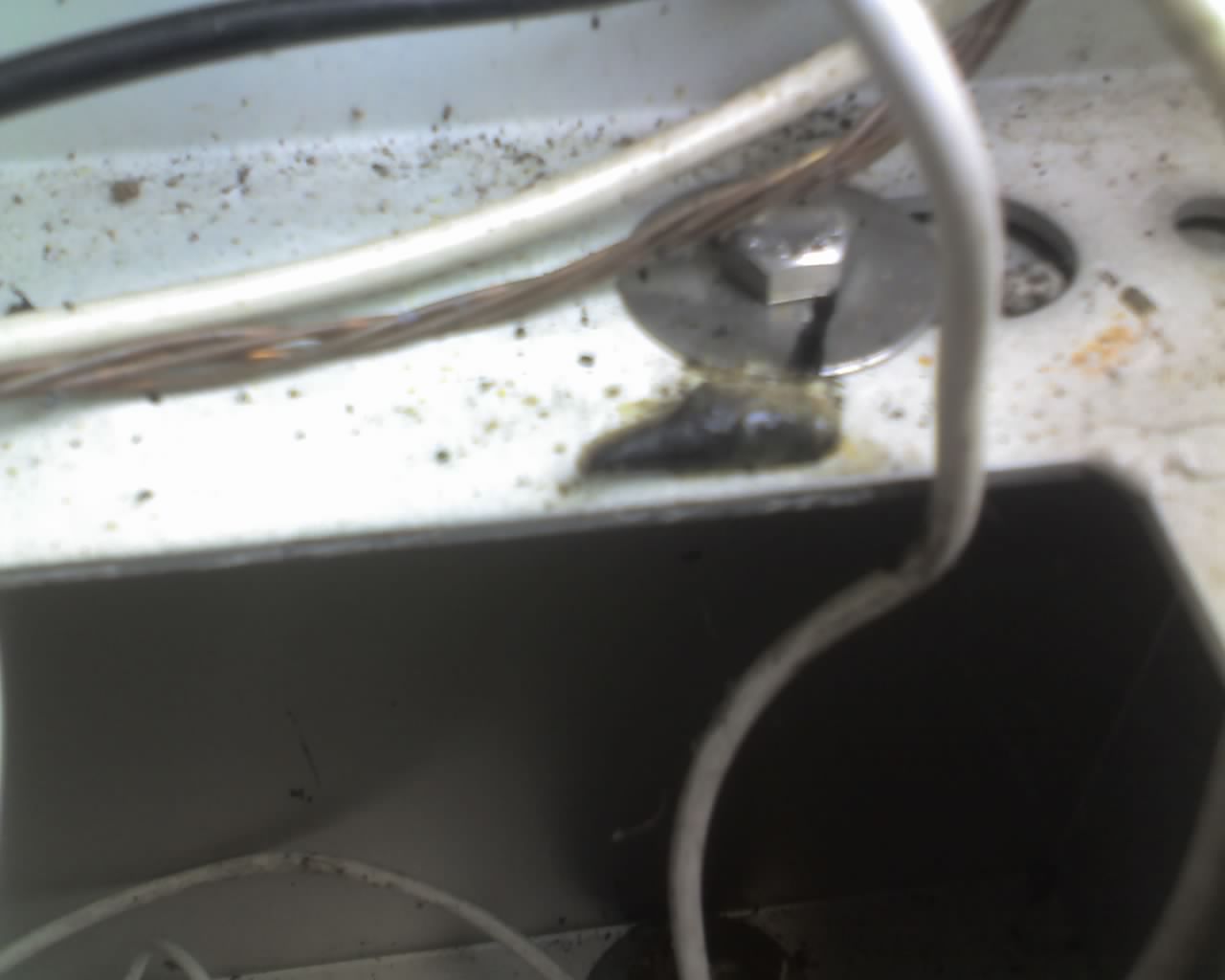

As I continued to survey the damage, I found the cause of the fire. A cooked slug lying on the cabinet frame below the filter. It seems the slug had crawled across the terminal causing a direct short and starting the fire.

I like the clean interior of the controller, at least it looks semi easy to work on. Parts look like they are right out of the '80s- the line filter, GE PA series MOV, 3AG fuse holders, Jones strip, etc.

They're pretty straight forward. I'll get you more pix over the next several days. I've got six cabinets set up in the shop for testing the new adaptive system and controllers we're going to be putting on-line in October. Deployment has already been delayed a month due to various issues. After those pix, I'll get you pix of some cabinets actually running in the field where you can see all the field wires involved. They can start getting pretty messy.:laughing: What contractor does the work has a lot to do with that.
