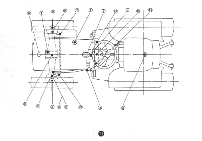

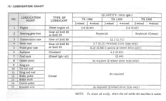

I have a user's manual, but it is for the model with the three cylinder engine. That engine uses 2.7 liters of oil. Does anyone know for sure how much oil the two cylinder version uses? :confused:
   / How much oil in my 2 cyl G174? #2
I found the quantity in the manual for you..It should be 2.6 liters. This is from the service manual for the 2cyl models. Also It has the lubrication points. Mine is also the 2cyl model. If I can find anything else in there, please let me know, I would be glad to post it for you. I used the Rotella Diesel oil from TSC, but I am sure any oil meant for a diesel will work well. Also, be careful when you take out the drain bolt, because there is a gasket at the head of the bolt that you don't want to loose. Take care, and let me know if you need any more info!
