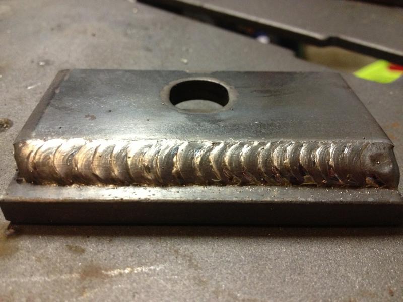

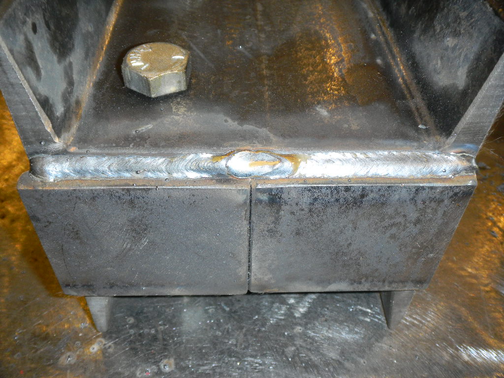

   / How much oxidation is a problem? #7

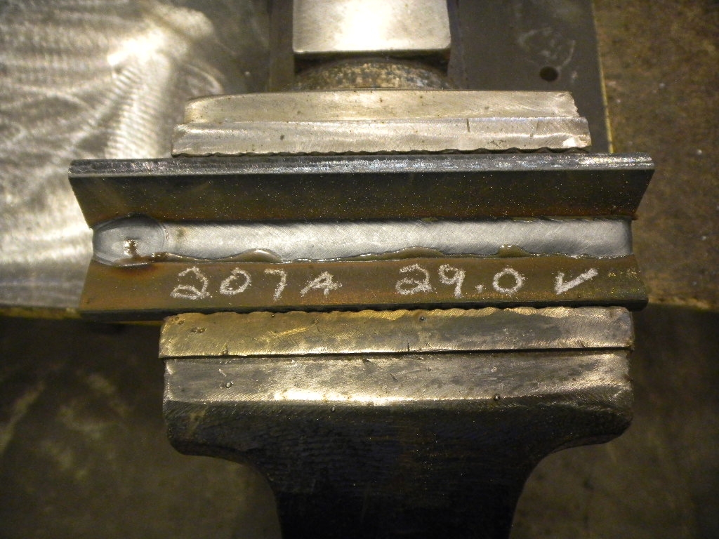

OK, here we go I found some pictures.
See how the weld in the first picture was ran so cold. This is very bad business!:thumbdown:
Now look at the second picture. Can you see the difference in the two welds?

   / How much oxidation is a problem? #8
Carl, are you cheating again and comparing short circuit to spray transfer? :D... Steve

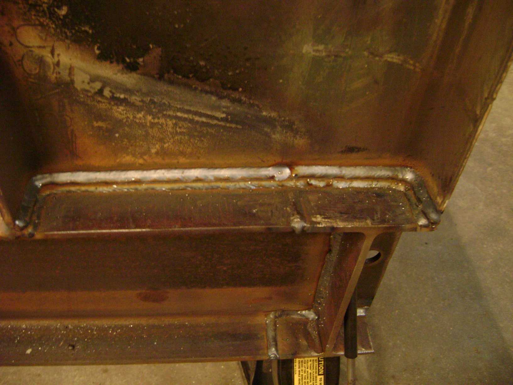

   / How much oxidation is a problem? #10
Well yeah. I'm trying to drive home the point to run Mig hot!;)
Here are a couple short circuit Mig welds that don't look to bad.
