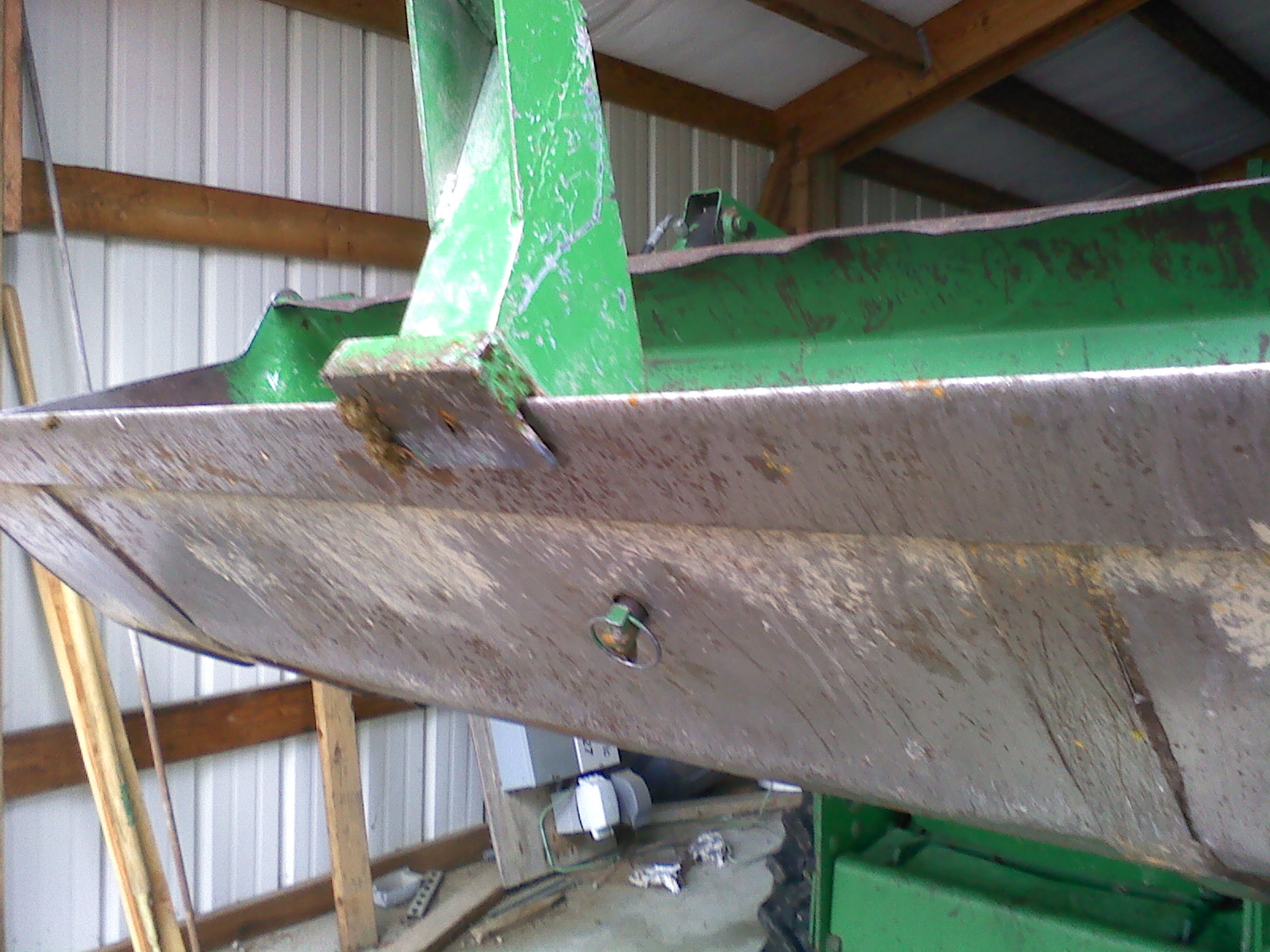

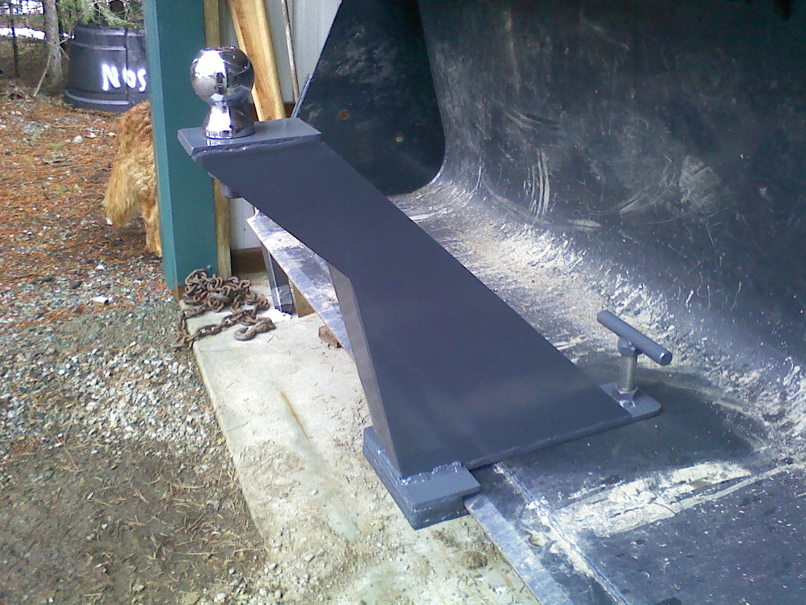

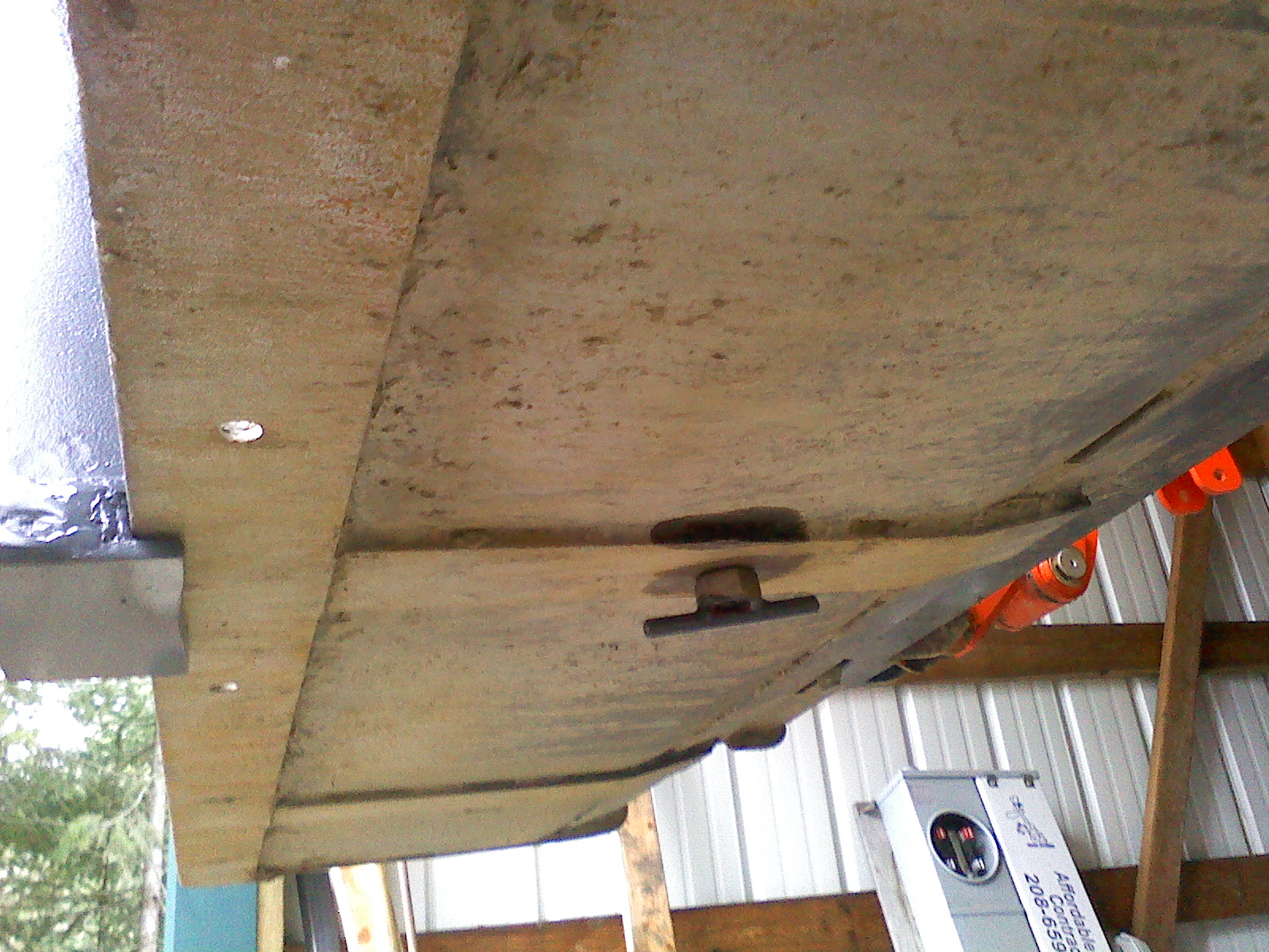

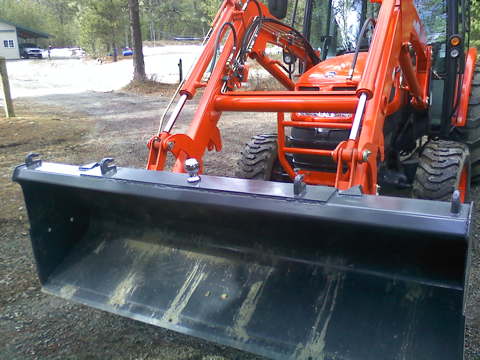

you dont have to. put a ball on the front bucket. this is what i made for mine. I have a 2-5/16 perminant mounted on the top for my gooseneck trailer and a removable 2" below for the lower dovetail trailers. they work slick.

   / How much weight is too much?
Not a bad idea. Always looking for a reason to do some welding. Thanks
   / How much weight is too much? #7

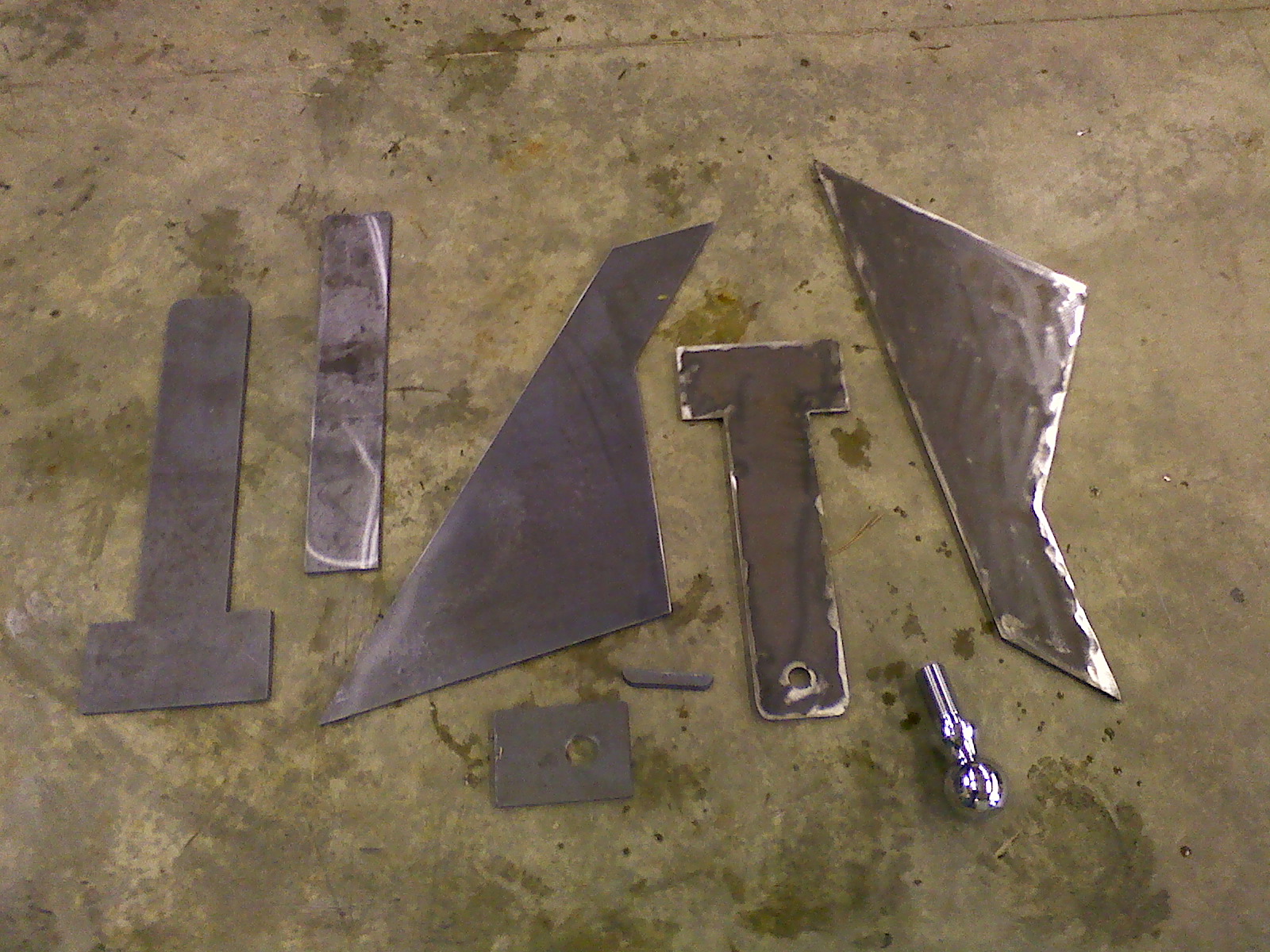

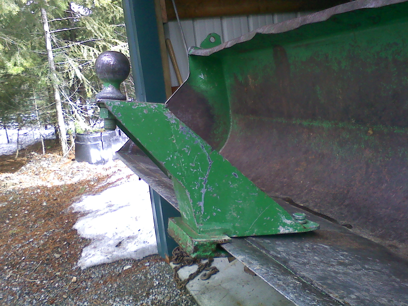

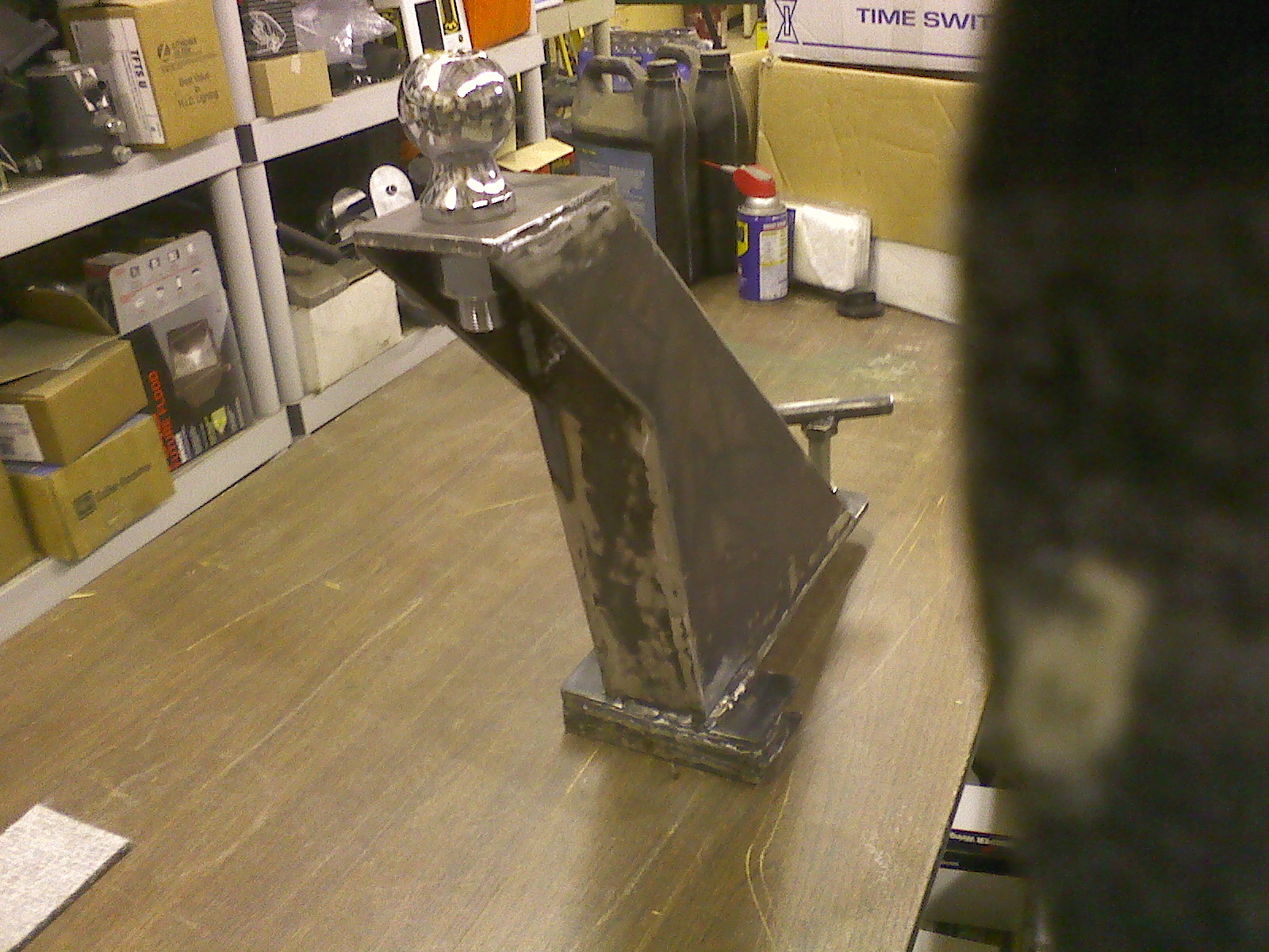

the one i made is probibly overkill for a 2" ball, but i wanted to be able to roll it under the trailer hitch and hook it up withjout getting out of the seat. and i cant stand up cause i have a cab tractor. it simply has a screw on net with t-handle on the underside. hookup in 10 seconds. The green pics (2) are the one i made for my old JD870.
though, having a plasma cutter does make it a little easier to fab one.
