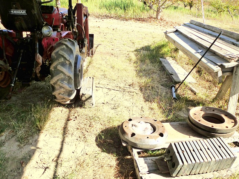

I just brought home a new (to me) little Yanmar YM186D. The manual says it weighs 1535 lbs (plus maybe 400 lbs?? for the loader that's on it).
It needs rear ballast; its so nose heavy that in 2wd it will hardly back uphill on soft ground.
I have four 77 lb wheel weights that I could make fit on the rear wheels. Possibly one outer and one inner on each side. Plus loading the rear tires with water would be another 100 lbs per side. (don't need antifreeze here).
How heavy can I go before operation is sluggish pulling too much weight? Any way this could damage the tractor?
Here's a photo where I wedged a weight in place temporarily to verify I can make it fit. At 17" diameter on 16" rims it just fits in the bead portion of the rim.
The bolt circle diameter is larger than the tractor rim's holes for weights. But since the weight's holes are slotted, running the bolts angled should still work. If I decide on double weights (inner/outer) I will bend some threaded rod to go down through the wheel and beyond to the inner weight. Has anyone done this?
Any advice?

TractorData.com says the Yanmar 186D was produced 1980 - 1986, so your little tractor is at least 27 years old.
When new it had 18-horsepower. How much horsepower does engine generate after 27-33 years of use? 14 ? 15 ?
Maybe you should use the 186D on flat land where the 3-Pt. hitch will transfer implement weight to the wheels.
Use the YM240 on hills.
If you MUST rear weight:
Partially filling the rear tires adds stability. Weighting the wheels, higher, does little for stability. Especially if an employee will operate it, go for partially filled rear tires rather than iron wheel weights.
   / How much wheel ballast is too much? #3
You should fill the tires to 70-75% full (valve core at TDC and fill till water comes out. I wouldn't partially fill a tire that might cause sloshing around. I also wouldn't try to put a weight inside the rim. Just stack it on to the first one if needed. You only need enough weight to prevent wheel slippage or counteract the FEL weight. YOU need to have some counterweight on the 3 PH so it counterbalances the FEL weight. While rear wheel weights will keep the wheels on the ground for traction, they do nothing to help remove weight from the front axle but will cause even more weight transfer if you pick up heavier loads because you wont feel the rear getting light so you think you are ok.
Best combination is 75% filled rear tires and heavy equipment like bushhog or tiller on the rear (or ballast box).
I have never had a sensation of weight stalling a tractor. It takes very little energy to spin that weight on the rim when it is a balanced load so keep it centered on the axle.
I would think that filled rear tires and one of those bigger wheel weights would be more than enough or perhaps just filled tires might be plenty. I would try it with just water in the rear and if more weight is needed, then add one weight to each rear tire. The weights should be made so you bolt the first weight to the tractor rim then subsequent weights are bolted to the previous weight. I have seen them with up to 10 weights on each wheel.

I bet it will feel sluggish no matter what based on my YM186D, but I don't think that it will make the tractor less useful. You will be able to put about 150 more pounds in ballast on the rear tires compared to mine, and with a loader I bet it will be well worth the effort to ballast the rear as heavily as possible. My YM1401D has the same engine as the YM186; with the loader it is approximately equal in weight to the bare 186D in my estimation, but I keep the 1401D unballasted because I worry the additional pushing force would bend or break something on the loader frame or engine casting. I don't have any empirical evidence this would happen, but the loader frame is not especially strongly built where the brunt of force is taken on my machine.
I do know that the couple hundred extra pounds the ballasted 186D has over the 1401D gives significantly more pulling/pushing force. Were it me I would put the cast iron weights on first and experiment, then try adding liquid to the tires. My experience is, and the literature supports it, that 150 lbs of ballast on the wheels is superior to 150 lbs of liquid ballast, because the tire is more compliant and flexible. Then, if more ballast is needed, add water to the tires until you are satisfied or at capacity.
I don't think the extra weight will hurt your power to weight ratio more than it adds productivity in loader work.
I like the idea of bending a piece of all-thread and cinching the weights together onto the wheel.
   / How much wheel ballast is too much? #5
Doesn't matter what it is, it produces X amount of power and every pound you add, adds to the sluggishness of whatever it is... The key is finding a good working balance between weight, traction, and the tasks you need to perform.
As was stated above, for FEL work, you want weight behind the rear axle to pivot weight from the front to the rear and reduce wear damage to front axle and steering components.
Wear from adding weight is unavoidable. You are constantly operating the machine in a state of load. But, when transforming a machine from something unable to do the needed tasks into something able, such sacrifices need to be made. Where it creates wear on some things, it prevents wear on others. It all balances out in the end and when the machine is doing the needed tasks, any sacrifice pays for itself.
I have to weigh down everything I own or I can go nowhere, the benefits of having weight outweigh the consequences of not.

I would go the most I could without overloading the axle. Do you know what the axle weight limit is?
   / How much wheel ballast is too much? #7
Why not fabricate yourself a rear-mounted counterweight?
Thanks guys, all good ideas.
I should have made clear this is my second YM186D. Since 2009 I've had one without loader. It has a 75 lb weight on each rear wheel and loaded rear tires, about 100 lbs each. (thread with photos). Plus it has 240 lbs of weights on the front. (photo)
That first YM186D fits under the orchard trees so much better than the YM240 that I've retired the YM240 to nearly only backhoe work. Photo. If I can ever find the small backhoe originally sold with YM186 then this new YM186D with loader and power steering can take the place of both the 2wd YM240 and the non-loader YM186D. (neither has power steering). It's not quite a match for YM240 in pulling power (18 hp vs 24) but its 4wd makes up some of that gap, and the ability to make a shortcut across orchard rows where headspace is limited makes a big difference in getting things done. Also with Powershift on the YM186D, shifting is just a tug on the lever same as a car's A/T, keeping moving without losing inertia contrasted to the YM240 where I stop (standstill) and shift seemingly every 200 ft all day as the slope changes. See the photo linked at the end of the first paragraph!
The first YM186D dyno tested over its rated hp when I bought it used in 2009. This new one with loader may be a little less, as would be expected after 30 years, but it feels the same as the first one. I think I can carry more weight before its sluggish but I have no idea where that limit is.
Weight bolted to wheels has no effect on wheel bearing capacity but of course ballast farther back loads the bearings and axles. The 3-point is rated about 650 lbs measured 24" back, but its not clear if weight approaching that limit continually is a good idea. At any rate I want to ballast for discing (as well as to offset the loader) so I want wheel weights at least matching what's on the non-loader tractor. And probably more, so that the loader is usable without hitching up a weight box. One final consideration, the Operator Manual recommends iron weights in preference over loaded tires, for maximum traction/pulling power. This was the reason I was thinking double iron weights then loaded tires only if needed. Maybe iron wheel weights then a weight box for loader work will be the best combination.
All comments appreciated!
