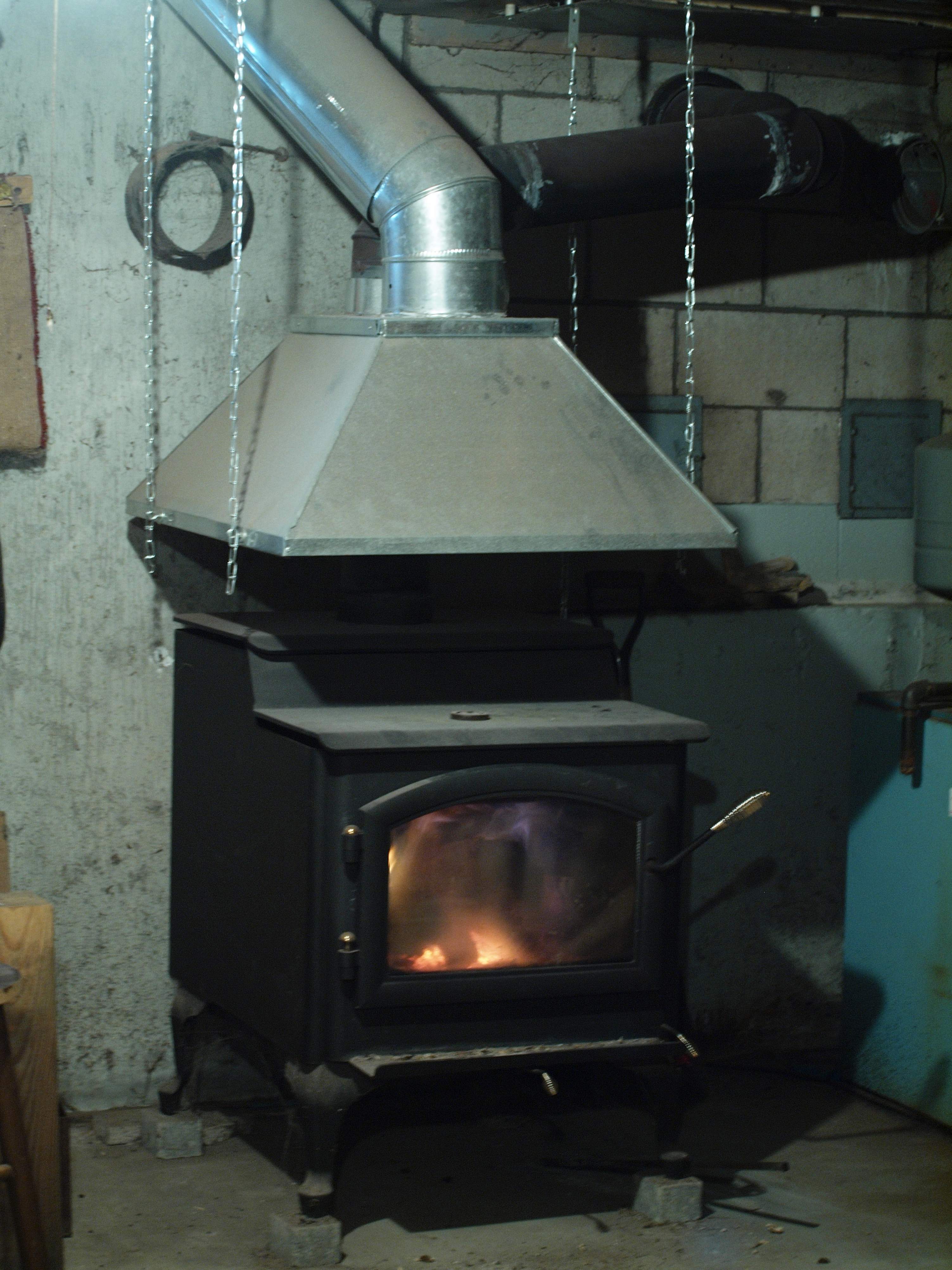

As I am a nuts and bolt type, my first thread got me to thinking about actual circumstances that may begin to depict wood burning efficiencies better than statistics. It seems that the sq footage capacity of any given stove are measured in South Carolina someplace ( or so the guy who sold me my stove states) so real life conditions are for me, a better marker. I live in a New England state where we get about 5 to 6000 heating degree days or thereabouts. I have a Quadrafire wood stove which is an epa certified air tube type stove. It is the largest they make (5700) stated to heat over 3000sq ft. I burn mostly oak and start in Oct and go through April. It is my main heating source. After successive 25* days, I must supplement wood heat with the oil burner to keep house between 68-70*. I live in a drafty 2 floor 1800 sq ft log home. The stove is in the cellar. I use about 5 cords per year and have gone through about 4 already. Shoulder months require only 1 load at night and then rebuilding a fire the next night. The hood has helped immensely as this stove has a heat shield on it and most of its heat convects upward. The stove may heat 3000sq ft in S.C. but it barely keeps up here at 1800 sq ft heating 3 floors. The house never gets below 60* even when its 0 outside but this is when we wake up. The stove alone could never get the house up to 68* at these temps. I use 1 tank of oil (275 gal.) per year and a half to mostly heat hot water. Now please understand, I am not trying to brag here as I do not even know just what constitutes "good" or any other marker of efficiency. My usage may suck in comparison to others but in order to rightfully compare this thing, there are certain details that must be given accurately. So, if you are so inclined, what make and type and placement is your stove? how big is your place you are heating, how well insulated is it? where are you? and how much and what type wood do you use?

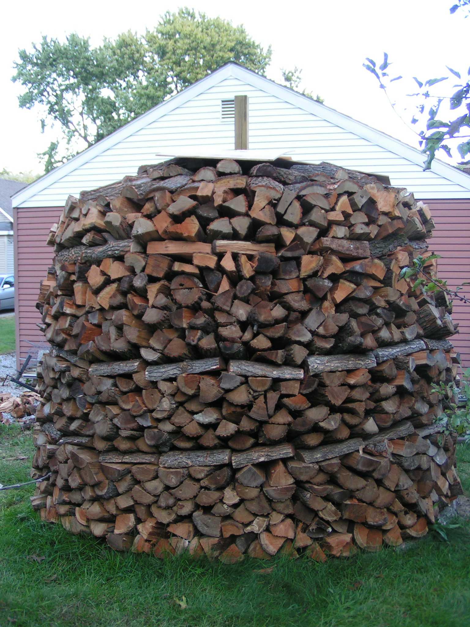

I'm fortunate in the we own our own wood lot and I selectively harvest locust and sassafras.
I tried cherry from windfall, but it burns too fast.
I tried maple from a gift tree from a friend. It burns too fast.
Here's a link to a handy chart that lists wood species, BTU's etc...
wood heat value (BTU)
Also, I use a Holz Hausen method to store my wood. I'm basing my consuption on the sq' that it contains assuming I measure it correctly each year. I guess I am within 10% of my estimates of personal usage.
Here's a link to a better description of it.

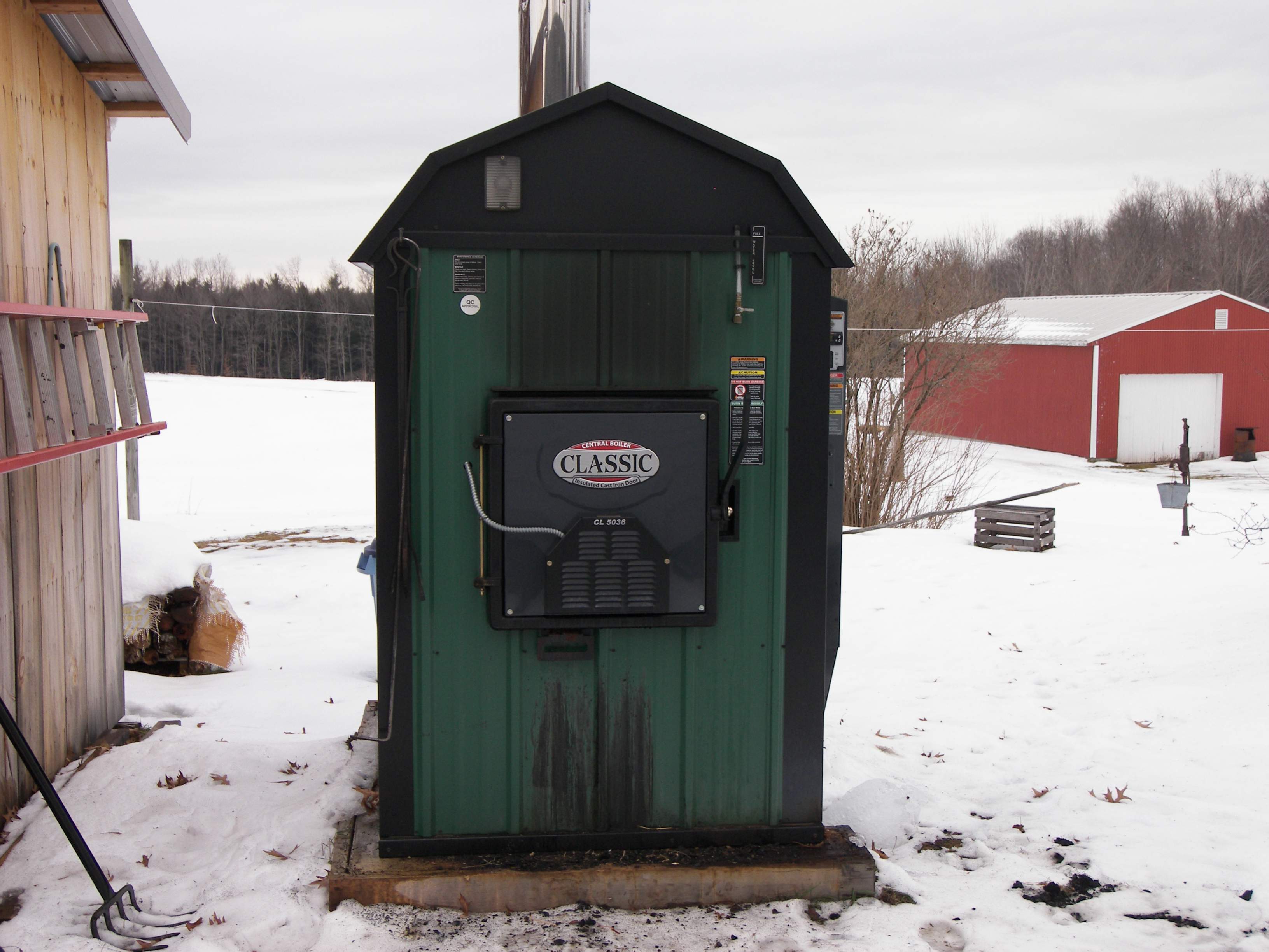

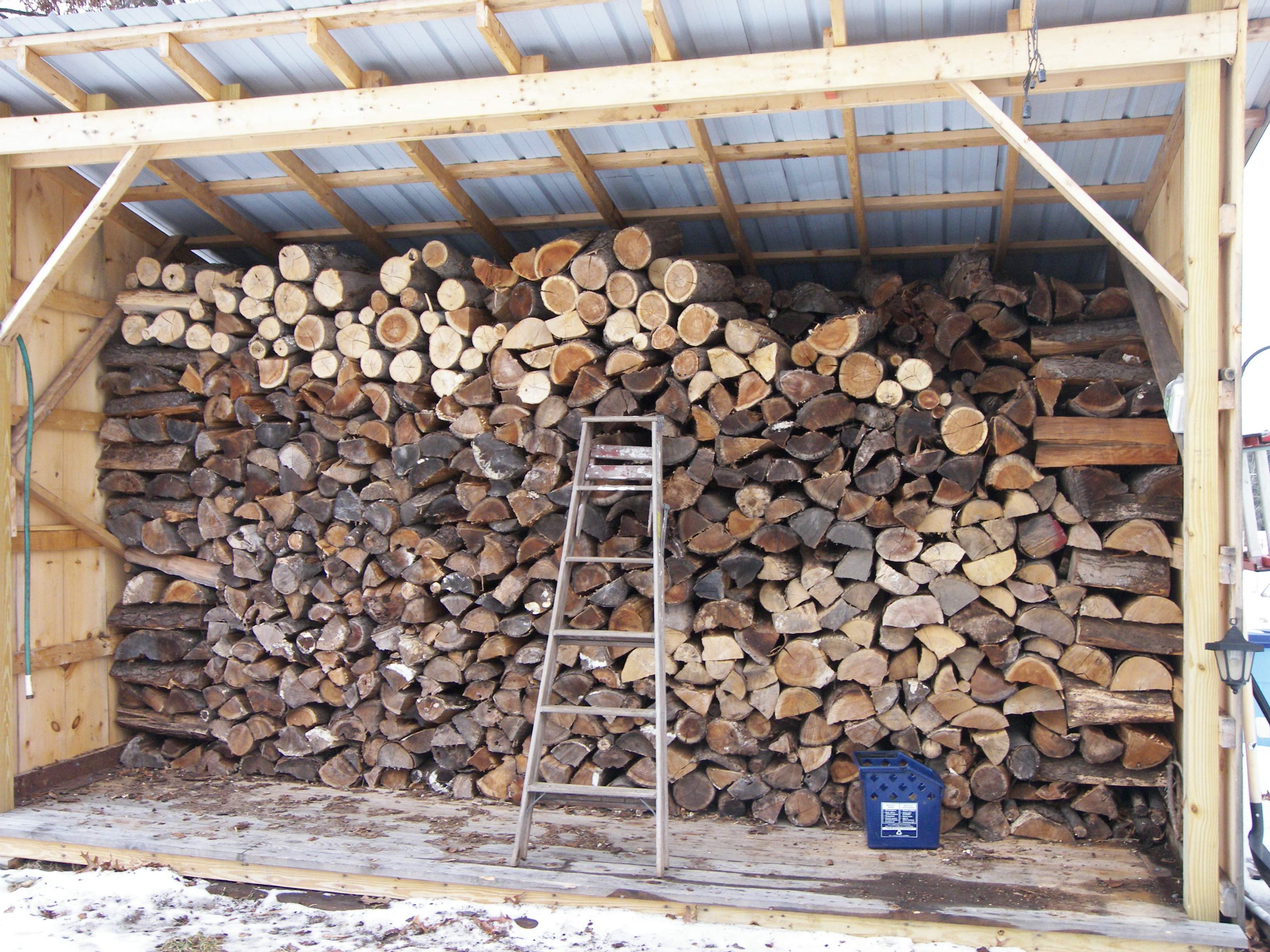

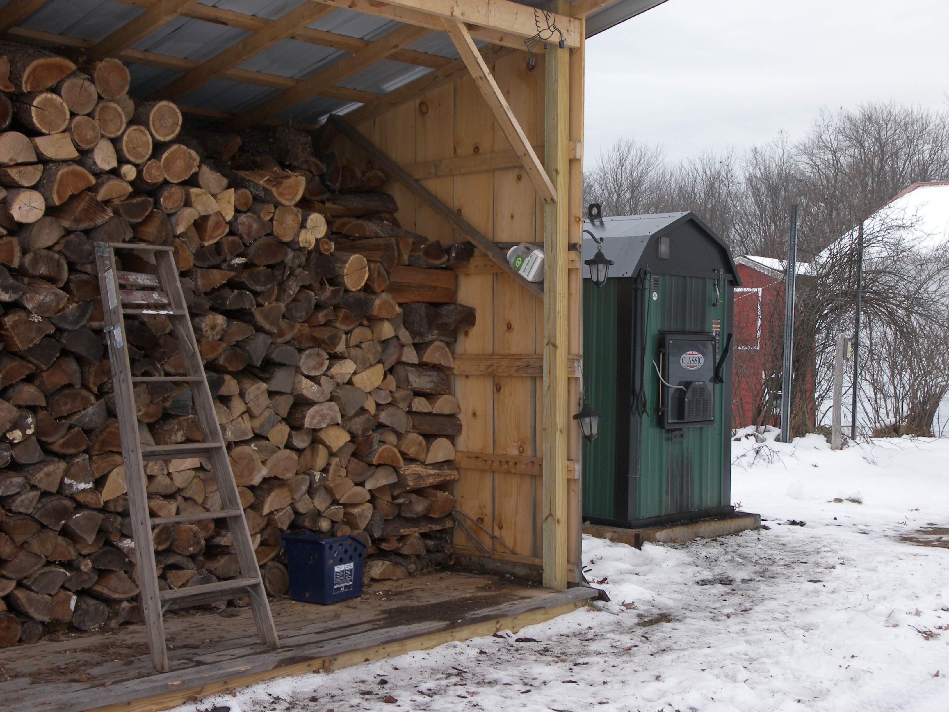

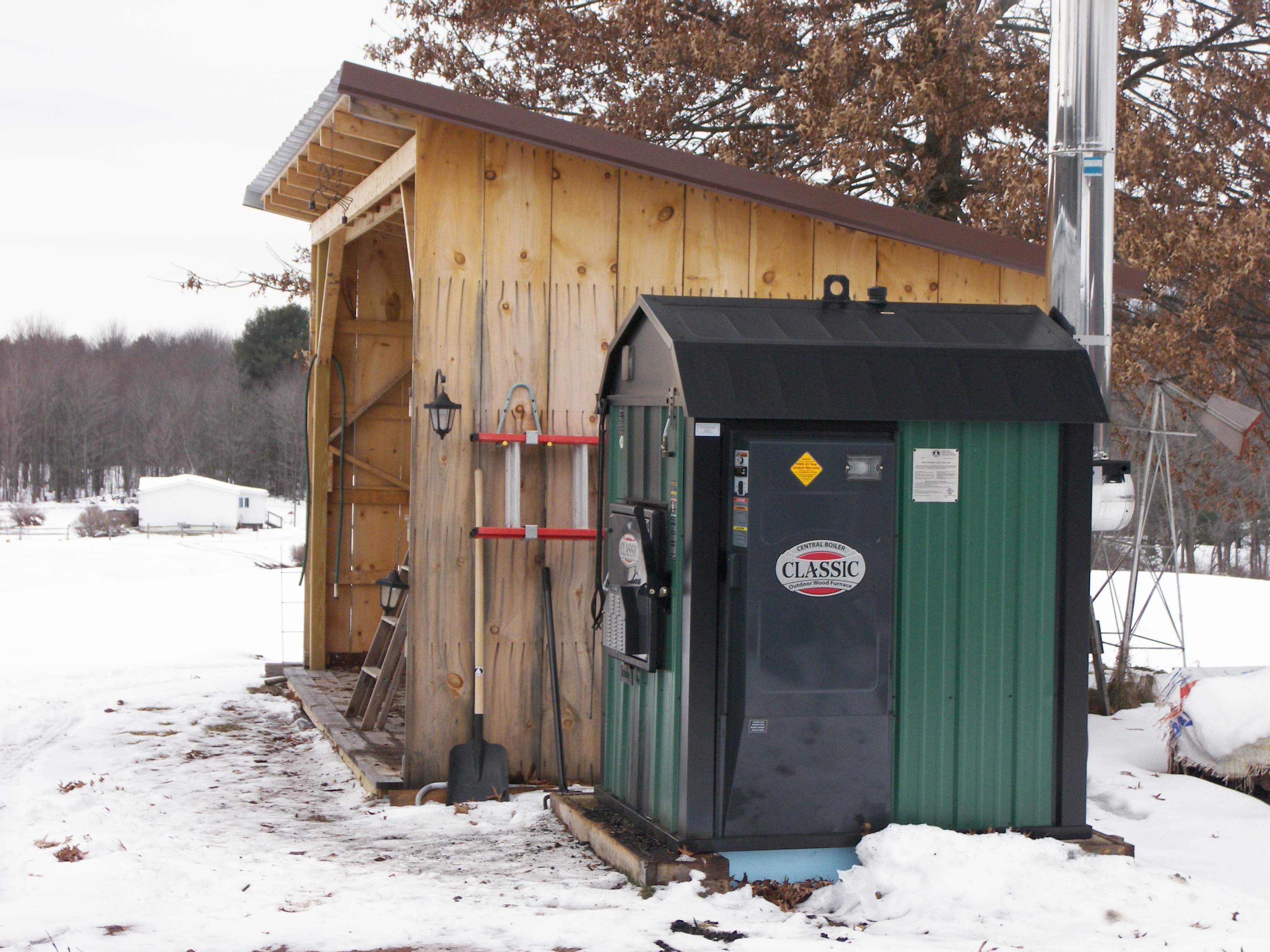

I have a Central Boiler, Classic Outside Wood Furnace that circulates hot water to a heat exchanger providing hot forced air through the house. My house is 24' x 42', with a 10' by 16' enclosed porch and a full cellar which is kept about 68 degrees. The Upstairs is kept around 72 -76 degrees. I fired about the second week of September and expect to shut it down around the second week of May. I cut wood approx. 22" long and i use about 12 face cord of wood a heating season.
(measured as follows: 22" long, 4 feet high and 8'long) Best of all i load most of the time once a day and clean out the ashes when the fire goes out in May. Im very happy with my heating unit and in our family we have 8 or 9 of these units. . . . John

Sassafras and locust must be quite something if maple is fast burning in comparison, never heard of those up here , judging from your woodpile they do look potent just from the color
