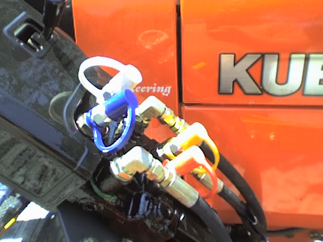

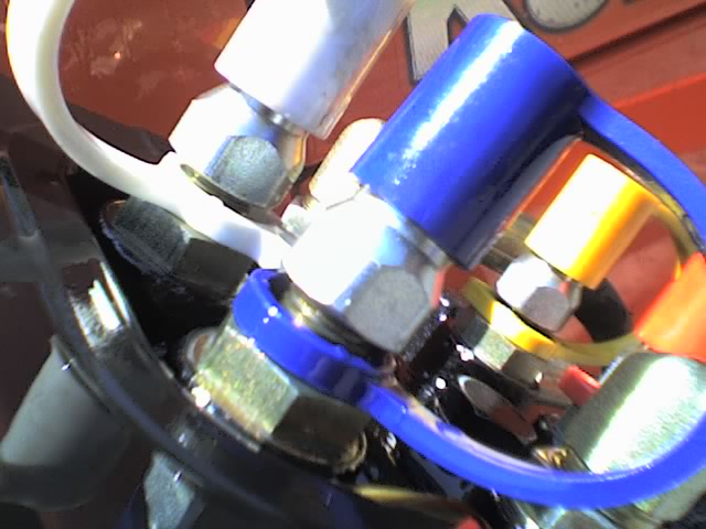

I just got my B7800 yesterday and today I went to re-attach my FEL to show it off to visitors and ended up breaking one of the hydraulic line nipples. I'm not sure if that's the technical term for it. But I like to use the term nipple whenever I can without getting fired. Some picutres are attached.
You might be able to tell that the blue one is bent down. Hydraulic fluid flys fast. It took me about 1.5 seconds to realize something was wrong. Rong with a capital R.
Luckily for me I have years of safety training. I quickly turned off the tractor and ran screaming like a little girl.:eek: After realizing I wasn't on fire or anything like that I returned to asses the situation. Bent nipple, no big deal. Of course I got squirted again when I had to releave the pressure to disconnect all the lines. Nice.:rolleyes:

By the that thing with the blue cap is called a Quick Connect.
Your damage is in the QC, the adaptor or the loader valve.
You won't be quite so giddy if it's the valve. The QC is about 35-50 bucks, the adaptor is about 10-12, but you may want to sit down when you hear the price of the loader valve.
If you would have cycled the loader valve in all directions, the pressure would have been gone and no 2nd lactation would have occured.

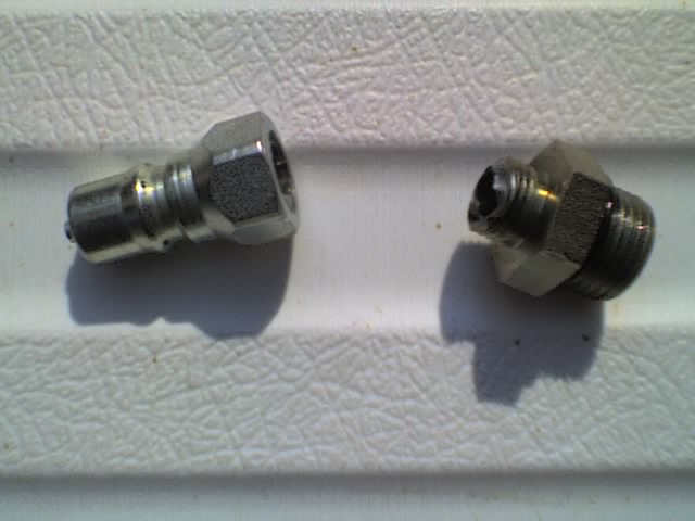

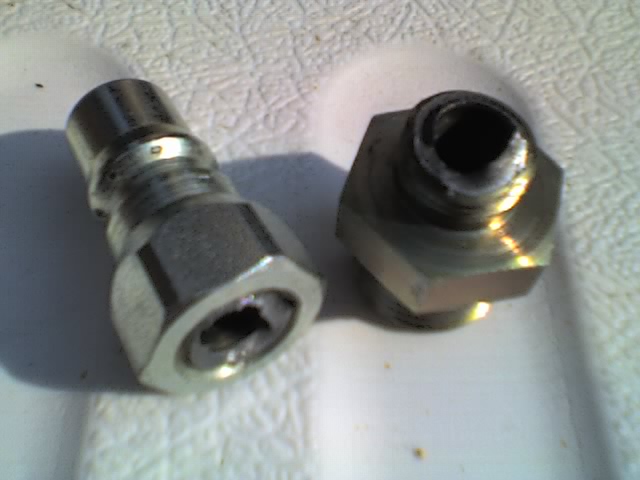

I took the QC apart. I actually broke the adapter. But as luck would have it, the threads of the adapter broke off INSIDE the QC. Oh well unless I can get the threads out, it looks like I need a new adapter and QC, no big deal.
