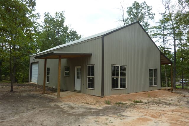

Blake's house is built near the town of Many Louisiana by the Texas border in the middle of the state, and was built as a vacation home on a lake that Blake and his family use on the weekends and vacations. It is about a three-hour drive from his current home. Like most people who decide to build these types of homes he had a contractor build the outside and then he did all the rest of the work in his spare time. Blake said it took two years and it was only on the weekends. I also did it cash only, so that dictated the speed of the build as well.
Front porch of Blake's home.

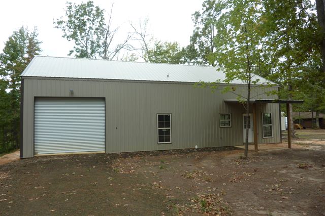

The garage is 30x16 and the living area is 30x40

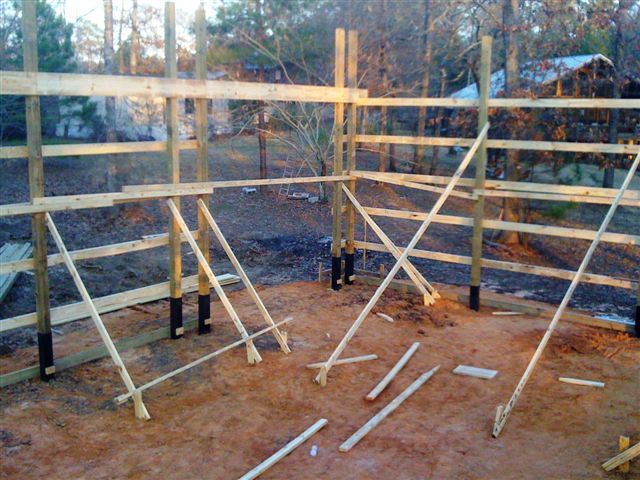

The first thing Blake did was get a permit for the building and do a perk test for the septic system. To prep the site He had to remove 8 trees and three old stumps before bringing in 20 loads of a sand/clay mix for the house pad?
The poles were spaced 8ft apart on center and the part in the ground had a PVC sleeve over them, that helps keep the post from rotting or getting eaten by termites.
Poles are 4 feet into the ground. The soil is very compact clay and we did not use any concrete around the post. Blake said. just a gravel base.

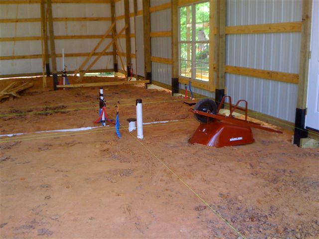

Rough in Plumbing
Plan where your bathrooms and kitchen will go before construction starts. You will need to know where your sinks, toilets, and washing machine will be so you know where to dig to put your sewer line. Having your drain lines, toilet drain and vent stacks in place and sticking up and caped so no dirt or cement gets in them is a must before the concrete is poured.

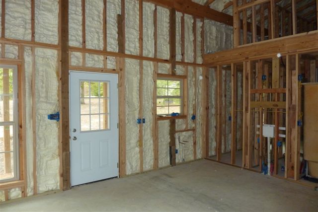

Spray foam insulation really stops all air infiltration and really makes the pole barn house more energy-efficient.
After finishing the concrete pad Blake started framing the interior walls. He framed it as you would a regular stick built house. Another option for framing the outside walls would be the bookshelf method that uses even less lumber. After running all his electrical wiring he then had a contractor spray the foam insulation. He had open cell spray foam sprayed directly to the metal siding (3″) and metal roof 4″) which makes for a very efficient building. The foam also cuts the noise from rain to levels of a shingle roof Blake said. From here on out the building process is no different then building a regular home.

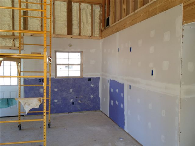

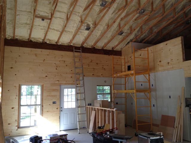

Finishing interior walls
In the kitchen area that will be mostly covered up with cabinets he used drywall.
Having a good lighting plan before drywall goes up that includes knowing were all your lights, receptacles, and switches go before construction is started makes the whole project go much faster.

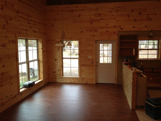

He then used tongue and groove knotty pine siding on the rest of the walls.

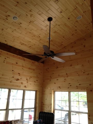

He then used the same siding on the ceiling.

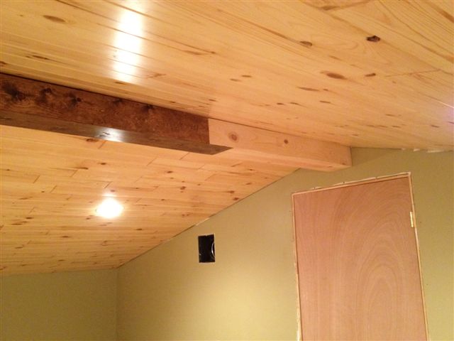

Box beam to hide where the seam comes together on the ceiling

For the flooring Blake chose to go with tile for the kitchen and bathrooms and Laminate flooring for the living room, and everywhere else.

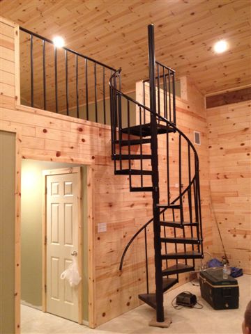

spiril stair case.
He then put the spiral stair case for the sleeping loft in and trimmed the house out with knotty pine trim. Now all he has to do is finish up the kitchen cabinets, counter top and add appliances and he will be done.
