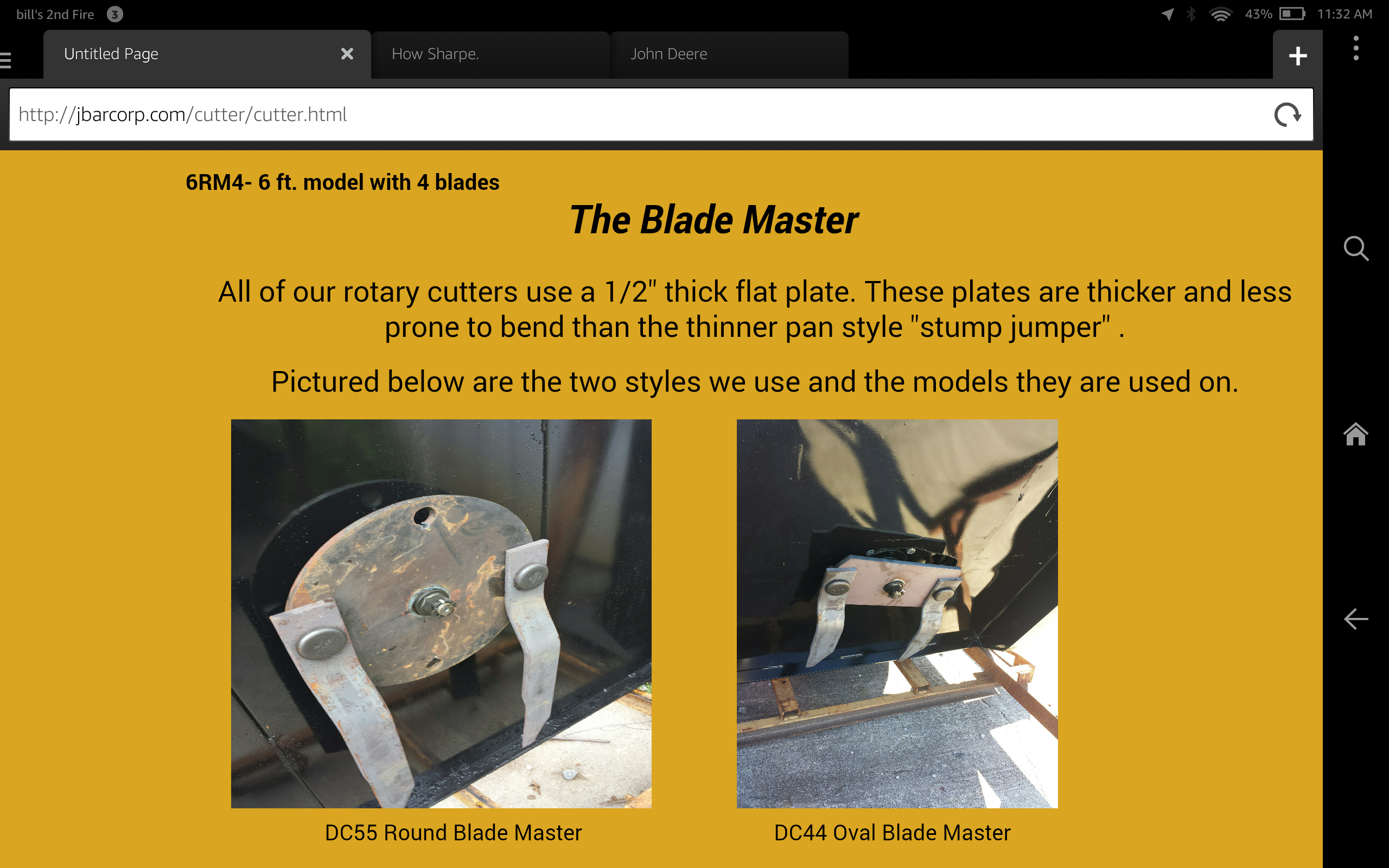

The design is a type of bull nose which pulls vegetation as it cuts. This type of edge is more resistant to damage in contacting concealed obstacles such as rocks. That said, I hone mine to a shap finish style edge, as I am mowing only tall grass, free of obstacles.
This mower is used sparingly to control vegetation at woods tree line w/ small ford to protect the cab on the larger kubota w/ wide finish mower.
The current stump jumper on the woods RC is the rectangular style, I Am going to convert it to the circular style and punch two additional mounting holes. Thus it will become a 4 swinging blade cutter w/ finer results . Deere does this by stacking the bleades, however using the circular jumper, vegetation is contacted at different intervals.

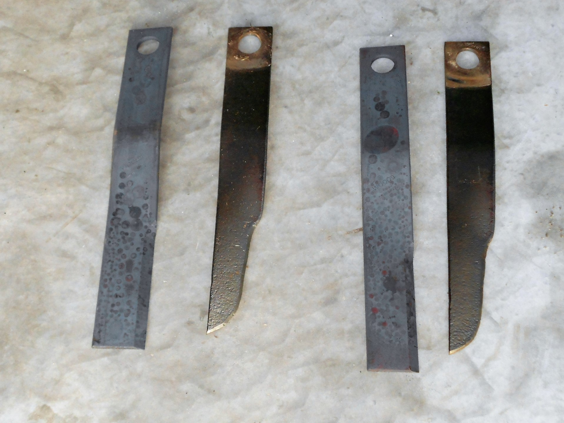

I replaced the blades on my Woods 60" cutter last year.
Pic is old blades and new.
I was always told not too sharp or they will chip if hitting something hard.
