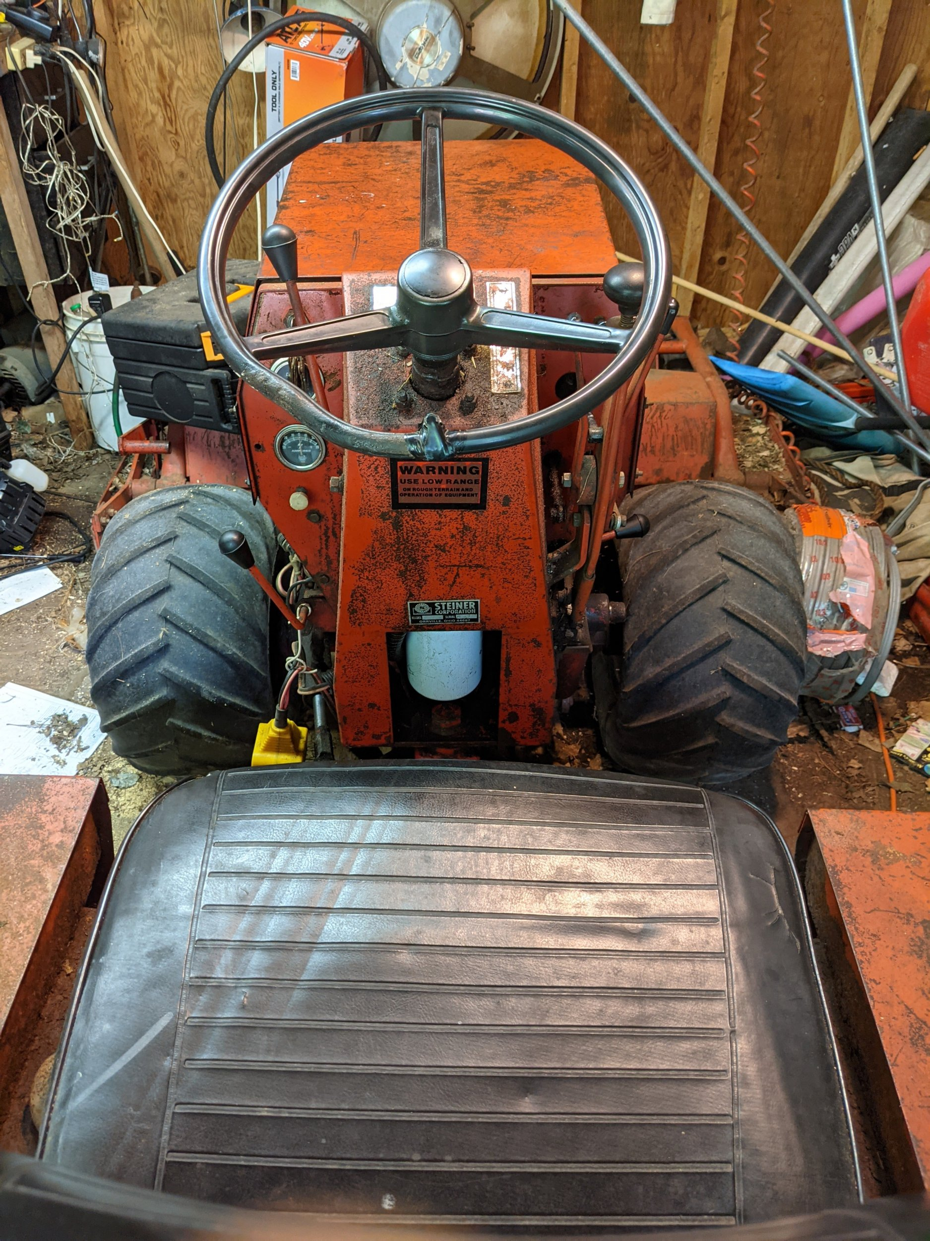

Can someone give me an understanding of the controls? Is there a parking brake? Also what lifts the front attachment? I can get more pics if needed. So I have the throttle on the left, the headlight (which works )on the lower left. On the right I assume that is forward and reverse. Is it pull back for reverse with the knob on top being pushed up? Is that a parking brake lower Right? The choke is upper right behind the motivator control.

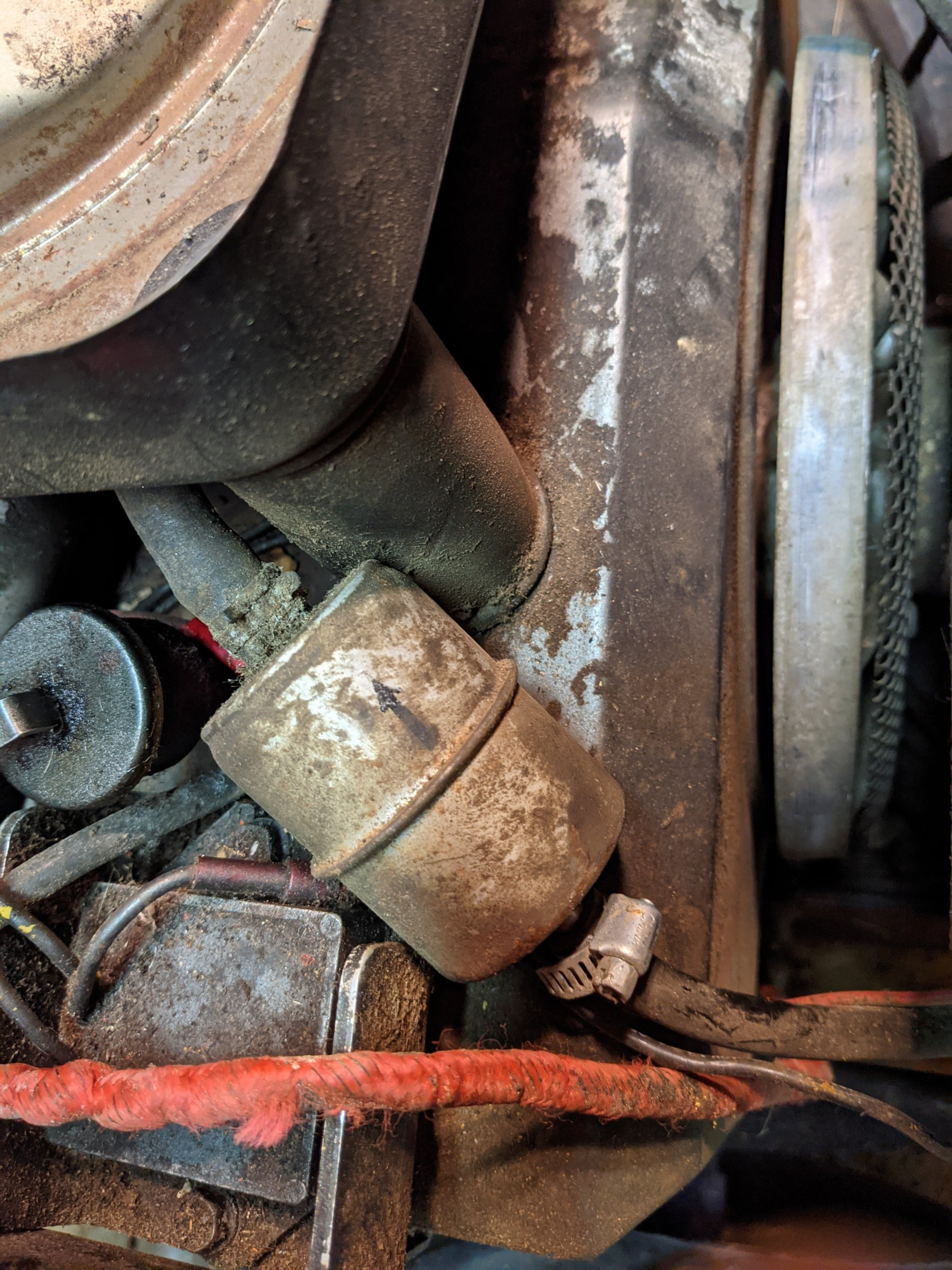

It is a B&S 18Hp engine. I found one gas petcock lower driver side of the fuel tank. It has fuel at that point. I will be replacing the fuel line and filter and making sure there is gas getting to the carb , at which point I am sure it will start as it purred when I put fuel in the carb...It is just not pumping it there. If it is a fuel pump failure I'll ask more questions on that. I want to drive it to 600 yards to my garage so I can have space and tools to work on it. It needs an oil change and the hydraulic oil changed...I'll be using a JD hydraulic oil that I use for my JD 1026R.

If I wanted to move it, I would find neutral, it would be between hi and low range so it will move. take the deck off and let it sit there and drag it up to your place..... Jim
   / How some of the controls work 1983 420 Steiner.
I found neutral otherwise it wouldn't crank over as it has a lockout. I wasn't sure if you could drag it in neutral without damaging anything. There is electric where its at so I can get it running where its at.
How do you put it in hi or low is that the lever top right you have to lift up on the knob...I'll have this running tomorrow unless the fuel pump is bad and I plan on driving it to my house...Neighbor will not need to plow snow this month, so there isn't any rush. Does the front just have a lever to release it? Than you take the belt off?

The neutral lever. I mentioned is the one between low and high range, so it can be towed or moved. Neutral between forward and reverse should center itself there.
There should be a lever to un hook the the mower and a second lever to loosen the belt that drives the mower and slip it off the pulley on tractor...... Jim

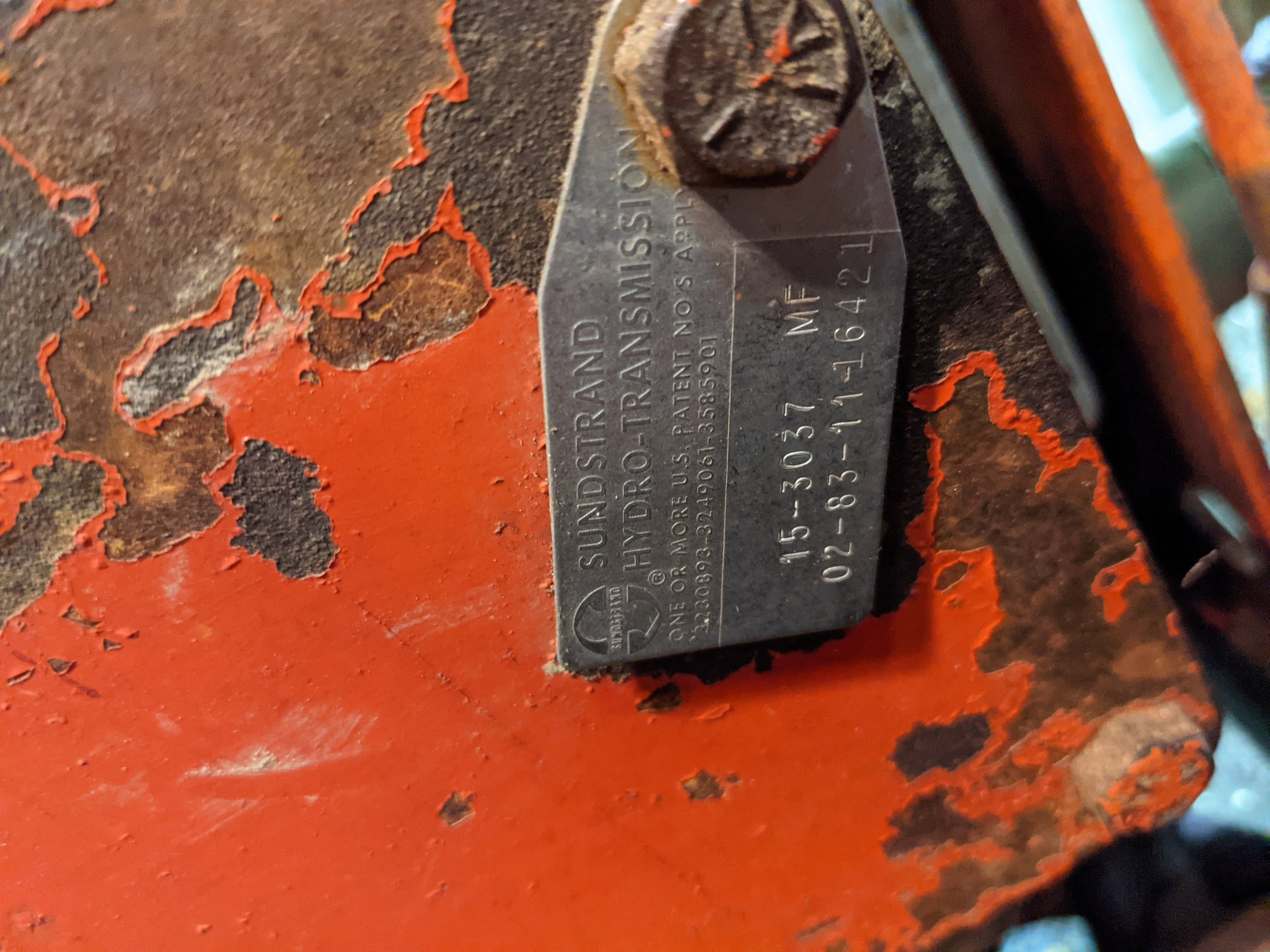

Per the manual that you posted, it specifically states to only use:
Steiner Trans-Hydraulic Oil or Texas Refinery
Corp. 6440 Universal Torque Fluid.
.. and furthermore NOT to use any other type of fluid. (page 17)
so I would reconsider using JD fluid.
#9
Disagree about the oil...Whatever meets the same standard is fine....This thing has not had Steiner oil in it in 30 years...Deere and Harley Davidson say the same thing along with most motorcycle brands....Oil that meets the same standard is key...The gentleman who passed away had the oil he used in the tool box. My personal experience over 50 years is changing the oil at correct intervals matters more. Amsoil 5-30 hydro xl is what he has been using...How often the old gentleman changed it is a question...Oh and I did read the manual's
Thanks Jim, over the last week figured out most of the controls. I'll be testing them tomorrow. Have not had much time to mess with this over the last week's.
