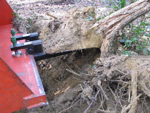

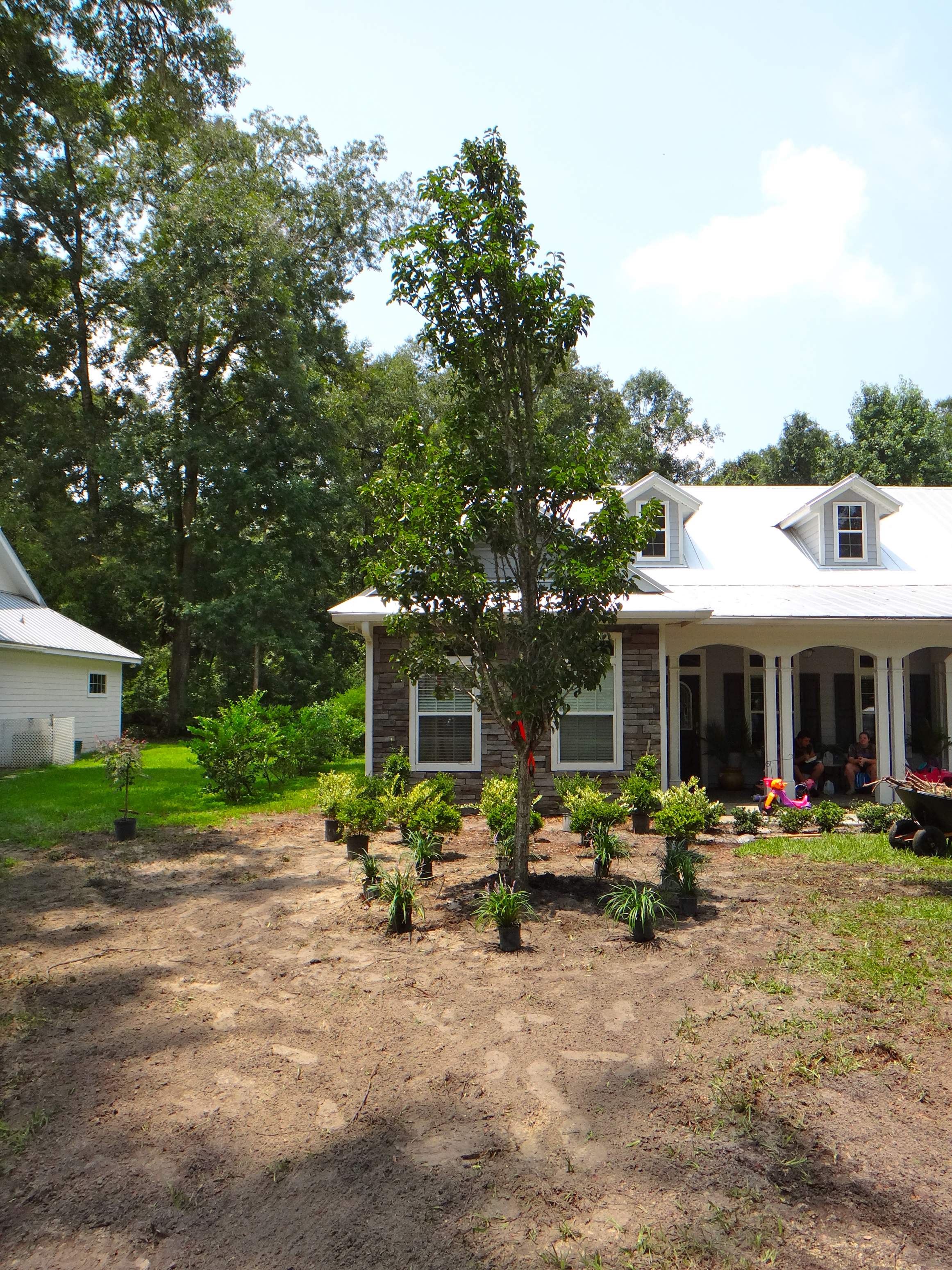

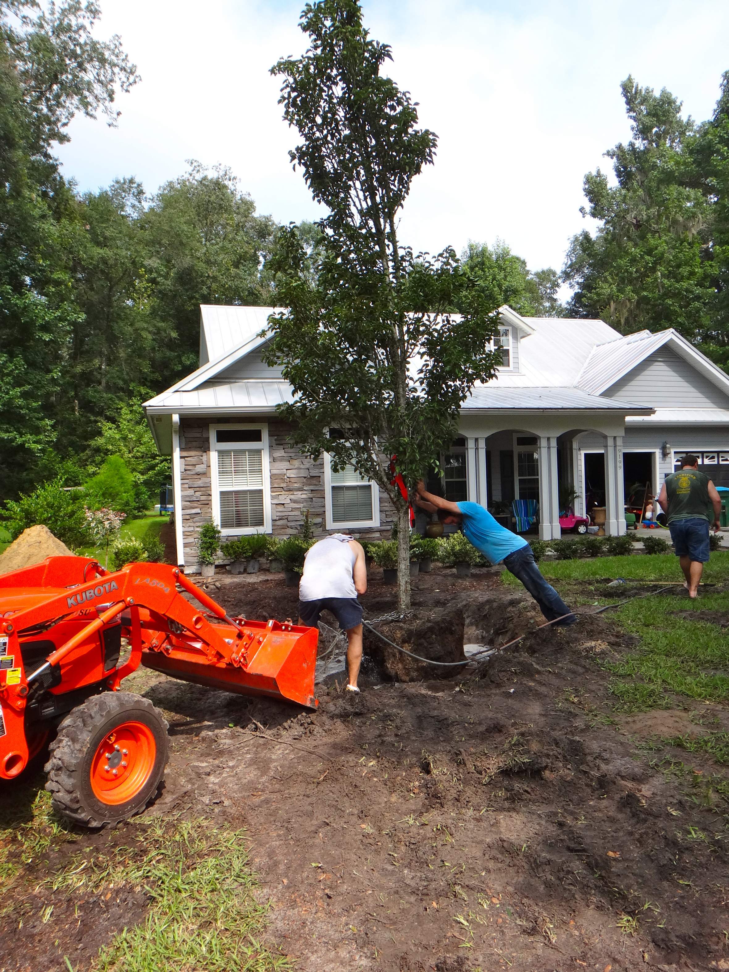

I'm thinking of buying a B2350 for (FEL) for small tree installation.
You should think of the FEL bucket as a mobile, power dumping wheelbarrow; not a good tool for small tree installation without an attachment on it.
