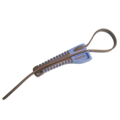

I hit 50 hours today on my GC2410 and did the 50 hour service. I was a little bit anxious that something would go wrong and that I wouldn't be able to complete it, but I did. It feels good to have it done. And yes, I did use genuine MF parts and oil--no possibility of questions later! I couldn't believe how tight the front axle drain plugs and air hole bolts were. Maybe it was because I was breaking paint that covered the threads, or does the factory just really reef on those? I see there are torque specs for all the bolts, but I don't have a torque wrench for the high end needed for the drain plugs. Do you just go by feel? How would you describe the right touch?
The only other difficulty I had was the engine oil filter. I have an oil filter wrench that fit the transmission filter nicely, but was too big for the oil. Some stuffing material made it work. Now it's back to work moving large rocks for a couple of stone stairways!

They don't have to be real tight. Snug yes. IMO :)
A pipe plug in a casting can be horsed down where they are hard to start backing out. That tightness bugs me too, as to "why?".
Now an oil pan drain plug with a washer in a steel pan should be snugged up good and tight. But again, not to the point of stripping the threads.
Oil filters, recommendations I've seen are to hand tighten, then give another 1/4 or 1/3 turn.

Scott, I agree with beenthere- most drain plugs are pipe (tapered) thread, only need to be "snug+"
You might want to invest in a small strap wrench for smaller and/or odd-size filter cans- they work quite well. Craftsman makes a nice set.:)

Thanks for the comments, guys. IrvingJ, I tried a strap wrench with a rubber strap like the one in your picture, but the rubber just stretched before the filter would turn. LIke the drain plugs, maybe it was put on overly tight. Ray66V, I think my work with rocks is well within the machine's capabilities. These are stones that I can roll or stand on edge to aid in getting them in the bucket. Even my dealer mentioned one of these machines is used in construction by another client. I've been impressed by the backhoe's ability to lift rocks.
