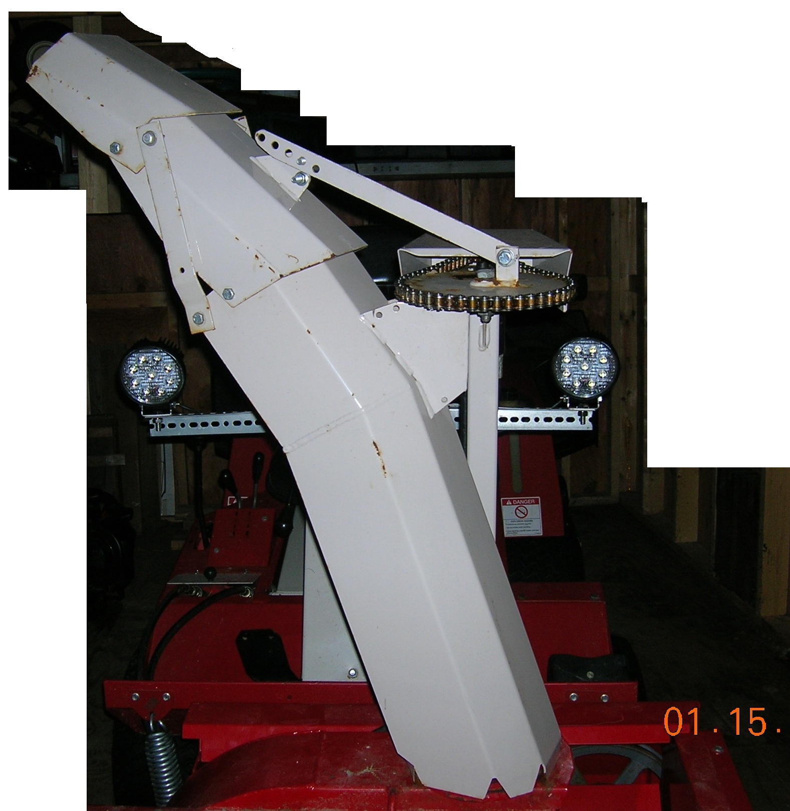

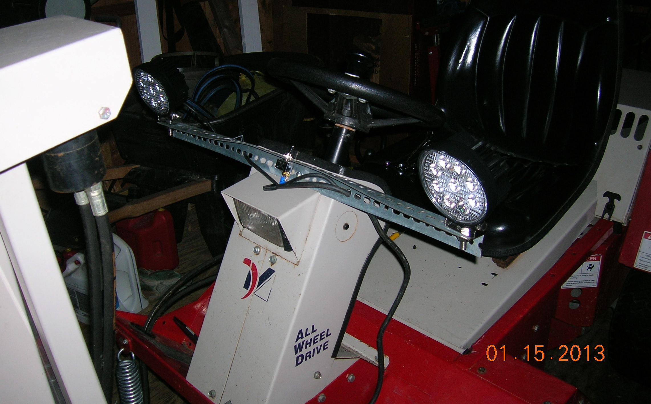

I have a Ventrac 3000 with snow blower. The snow blower tends to block a lot of the light from the headlight. Particularly when the blower is raised. Has anyone else added an additional headlight(s?) to a 3000? What type of mounting frame did you use?

Wiring aux lighting isn’t a problem it is getting the lights you want mounted the way you want them.
Do you have a pic or two ?

If it was me and I was using this machine Ventrac
I would add a ROPS and a small front bar.
Warning lights on the ROPS and head lights on the frt bar.
The frt bar could be 1 or 1.5" tubular with two 90s and flat plates on each end for mounting; made high enough for the light from head lights to shine over the equipment you are using.
Head Lights on the ROPS will spread out the light too much, especially if snow blowing, the snow will reflect the light and blind you more than help.
Just thinking out loud.

Finally did something about this. It's not the nicest looking mounting job but it was quick and it works!
