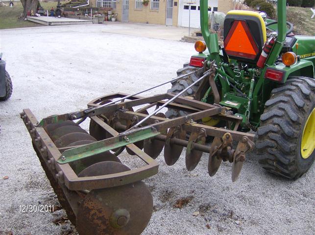

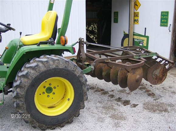

I built this for my 790 from 1/2 of an old JD drag disk, 5' wide. ~~ grnspot
